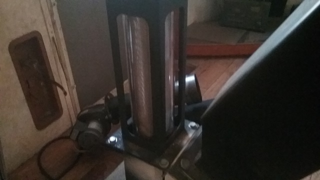

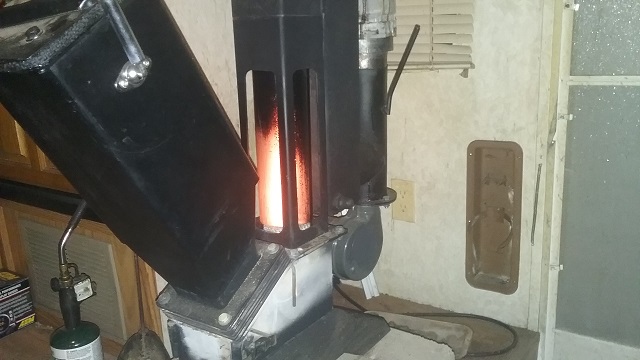

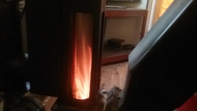

Sight glass finally came in. Well I did expect it to soot up, but it began this much faster than I had anticipated. So I think im going to install the tighter grate to lean it out some, I think that will be a big help. But regardless, it will need a means of easy access for cleaning. That will require some redesign to make happen. Also this hopper on the angle is a no go. When it gets low and begins to burn out, its like a gasifier and the smoke condenses and is leaking out the lid seal. So I am going to design this version so its straight vertical and also add a vent to vent some of that moisture out.

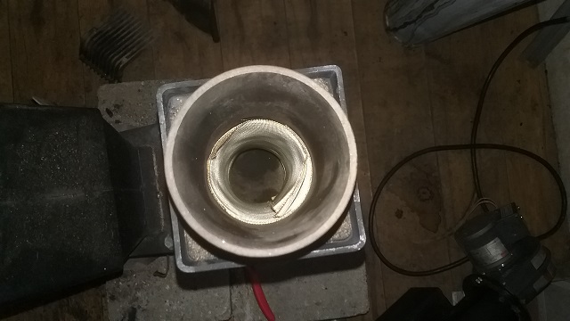

So today I tore it back down and clean out the sight glass. Then when I put it back together I inserted an SS screen inside the sight glass tube. So far this seems to be working but I just fired it up, so need more time. However, yesterday it started right away. This time I dont see anything on the glass yet its been about a 1/2 hour. The screen is turning black and this is ok as long as you see through it. It it works then we could make a mini chimney sweep to brush the screen to clean once in a while. Hope this works cause this is a really cool feature of this stove.
That is like an art object, sure hope it doesn’t soot up
Well the screen did seem to slow it down, but still not enough. So Ill have to experiment some more, but this will need to be put on hold. Im going to forge ahead with out it for now and make the revisions to simply make it function as intended with out the sight glass.

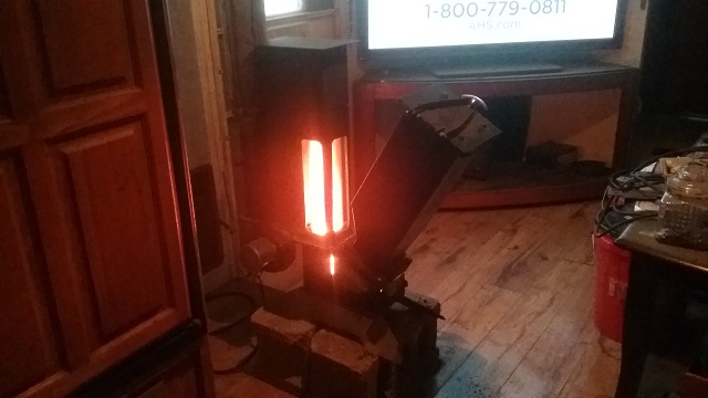

Well Ok now it decided to clean itself out lol. Stupid thing make up my mind!!!

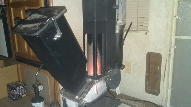

Ok so I think I need to improve the combustion and flows. This I already have plans to fix. It has an issue with ash accumulation just below the grate after its ran for a while. This cause some flow interruption. Then this is much like a gasifer where its accumulating hopper gases with wet fuel as a result when the fuel levels get low. So this with a combination of the lower flows issue is causing to cold combustion and soots.
Yeah I had just refilled the hopper and that new feul started to process and she took off. As I was just sitting here I noticed it started clearing a hole. So I kept stoking it up and it nearly fullly cleaned the glass. So not ready to give up yet.
Is there a cleanout tray to empty while it is running?
Yes there is supposed to be a removable tray, but on this one I got lazy and just made a door.

Well I was trying to avoid any electrical operation with the exception of the draft blower for faster start ups. But that is optional in not required. For its intended deign purpose this stove works quite well and will have the versital features Ive designed into it. The sight glass however may go away on this version and Ill just call it good. For a simple cook stove converted into a full on heater its does ok.

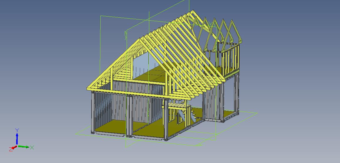

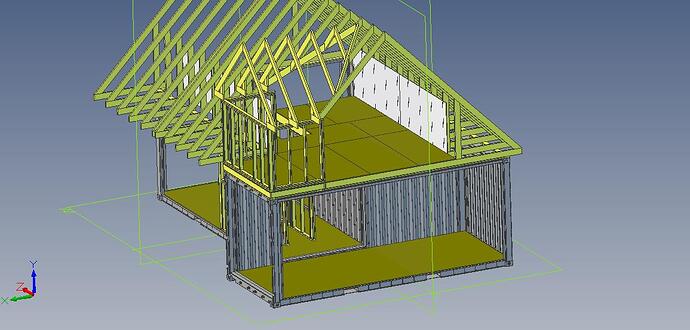

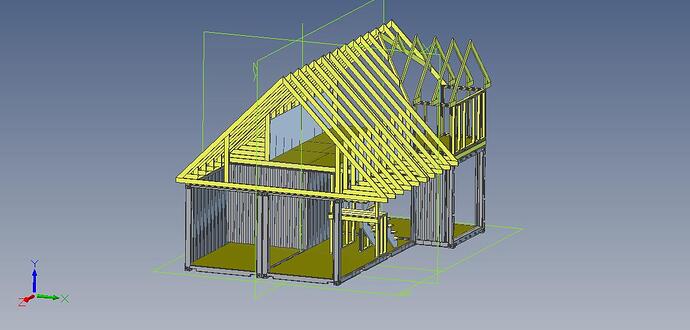

However hahaha. Next version of this will be a dedicated indoor stove. I am going to design this so the glass is out front and the hopper will be at the back with twin heat exchangers wrapping around it heating it. That should help with the moisture in the pellets. This will have sort of a shoot coming from the primary grate leading under the sight glass to a tighter grate. Secondary air will feed up through this grate and fully burn off any char pellets that cant get through, All ash will sift through this grate into a tray for removal. Of coarse CAD model first and then build. Right now Im designing a shipping container home, using three 20’ containers featuring a loft. This is a very detailed model, it has the containers built exact to the real things, all the truss and stick construction and flooring. Right now Im creating all the dry wall panels and installing those. This model is just about as much work as building the real thing. Im glad Im building in model space first, I would have messed it up a lot and it would have had to make due with mistakes. Model of that will come soon, I may get an architect to approve these plans and offer them later on.
Here are some snap shots of the container home. Its a little over 500 sq ft including the loft. external walls are hidden to see inside. I still have to punch holes an walls for windows and doors yet.
you guys have forgotten the popcorn and hot chocolate dispensers
Hi matt is this going too be your house in time or are you building a house on the property you bought for the shop, ?.
