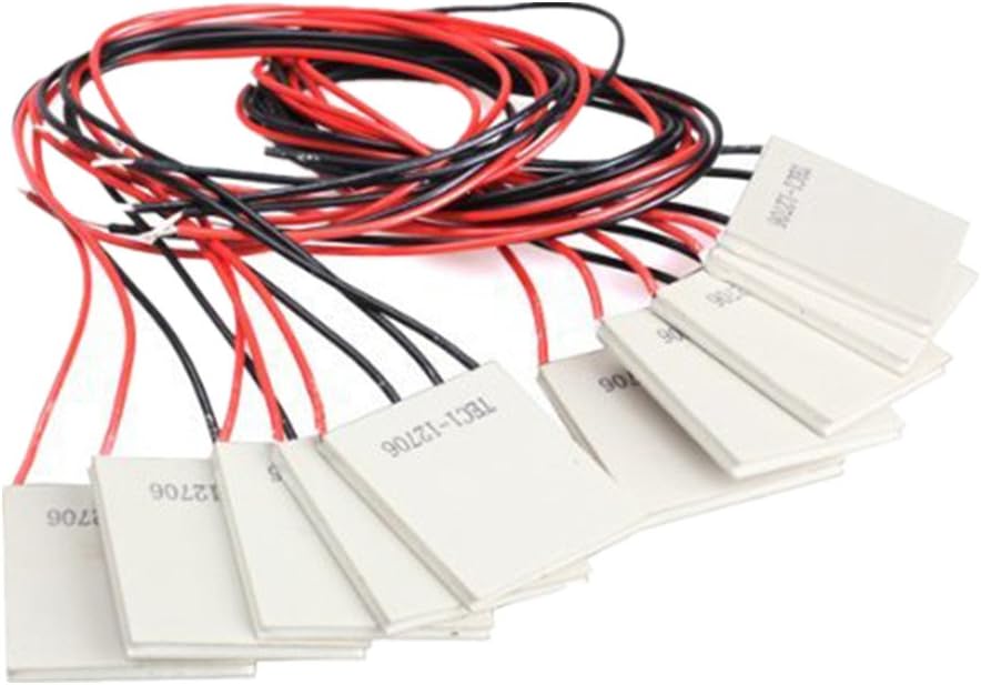

However, just for kicks and grins, I looked them up on Amazon. Ten years ago, bought these and I think at the time I paid at 50 bucks or more for one of them. Now you can ten of them for around 23 bucks.
Supposedly they produce 60 watts at 12volts? I think this is the input for the cooling effect not sure if they would produce the 60 watts going the other way. But for 23 bucks plus cost of some heat sinks this is definitely something worth looking back into. With the engine gasifiers we maybe able to direct focus heat to these. So like a small torch directed at each one. Im going to see if I can justify my very limited budget to purchase a set with heat sinks for an experiment. Alfreds I know will be much more expensive, so for proof of concept these may do the trick. I already have plans to build the micro gasifier,
So all ten would give us a potential of 600 watts for 23 bucks. Not bad four sets of these would then have a potential of 2.4 kW. :fire:

You may be able to use these, but there is a difference in the construction of the Peltier TEC (thermoelectric cooler) and the Seebec TEG (thermoelectric generator).
Yeah thats what Alfred has said in the past. The actual TEG’s are more expensive. A Peltier is a cooler a TEG is a generator. :slight_smile:
