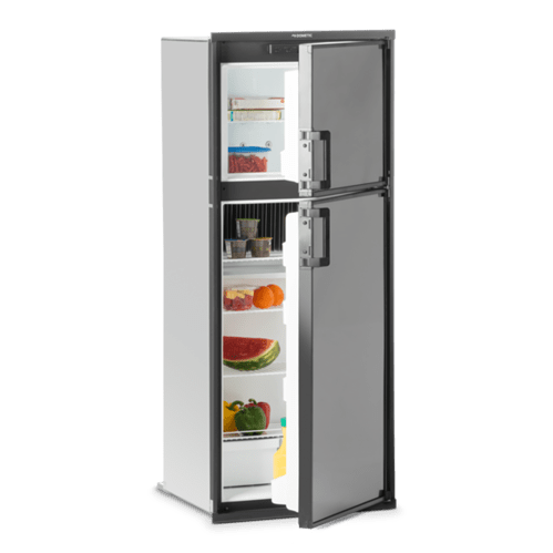

For off grid refrigeration, I recommend this product. A Dometic propane refrigerator. They don’t use much gas compared to the old Serviles. Look for a camper with one of these in it.
