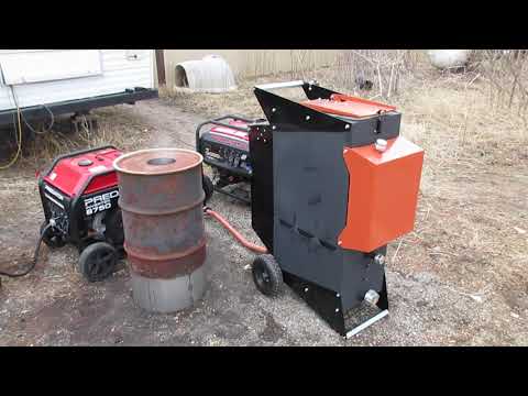

All right here it is the DF X - S4 running two generators in tandem!! This unit is for larger V twin and larger generators along with Pick up truck installations’. It has been up and running for about over an hour now without a hitch.
So total run time was three hours running both units in tandem. That was pretty cool!!

As always Matt Fantastic build and to run 2 generators at the same time is amazing !

What size engine do you plan on trying to run in a vehicle and what is the largest size you anticipate it could handle?
Big block V8 you can team up to three gasifier modules into a single Fusion.
Will this single unit run your 283?
It probably could, but I plan to run two of them so I have larger capacity.
A 283 cu.in. or 4.6 L engine that would be very impressive Matt. Just sale the gasifer for emerging power generation. But on the side note it also can be used to run a vehicle down the road. Get around a whole bunch of government regulations that is in the auto industry these days.
