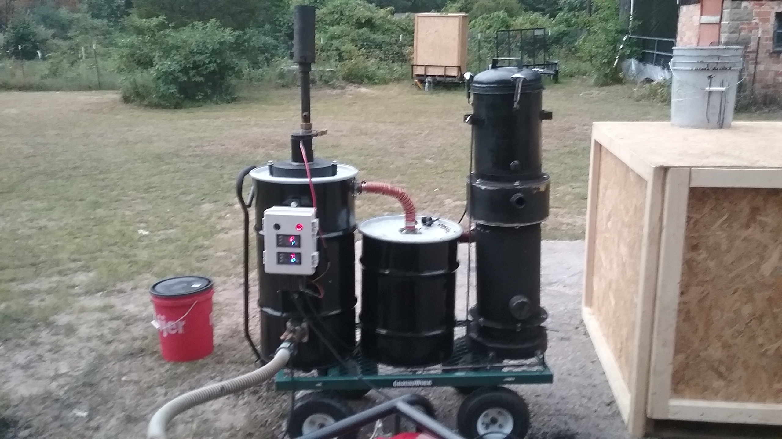

So added a controller today and basically prototyped the new controller for the 2018 Utility machine. It looks much nicer and is easier to build. It cost a little more in parts but I save a lot of time and labor. Going from ejector to a push button operation is so much nicer. Fires right up and once going I run for 1/2 hour and shut down for 1 hour and pull from battery and repeat. When I ran out get food I forgot to run some gas in it, still cautious of tar yet. I was worried I stuck a valve and got home fired it up and it made a nice blue flare; generator fired right up :slight_smile:
I have the hopper shaker installed and wire up also but I do need to make a bracket for the grate actuator motor and install that yet. So far the hopper shaker has made some difference I didnt think it would on a pellet machine but it has added to its stability.
Right on Steve, I just filled it up and am going to run this hopper down and let it cool yank it off to inspect the jets. So keeping fingers crossed :fire:
Well I tore off the hopper and pulled the 1/8" jets. Two were fully clogged and two were partially. So there is something to do with this simplified hearth section design and I will be bringing back a air preheat baffle in the Utility this year. Not a big deal no design change its just some added parts.
With the jets I had in there they were the middle of the road in length and those seemed to work the best when things were flowing. But since I had it apart I went ahead and tried some longer 1/4" jets just to see what would happen. So far I dont really see a lot of change from the way it was just running before this. The intake air valve is set about the same and is set around 75% open. Normally its 50%. I see a lot of smoke pulsing out the intake valve as well. Generally I dont see much on the Utility machines. Ill probably go back to the 1/8" and simply weld in some inception ports to clean them out and be done with it. I may experiment with changing out the hearth bowl as well. This was supposed run chips and has a 2" restriction, I think for pellets I need a 1 1/2"

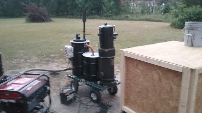

Well this is now day 2 of running the gasifier to where its producing about 90-98% of my power. This is since I fully automated it, I installed the grate shaker on Sunday. With this and the hopper shaker I dont even need the electronic mixture controller, I know where it runs best those two things keep it in check. When there is a problem I then know its either out of fuel or ash chamber is full. Im burning through around 60 lbs pr day running it around 12 to 14 hours pr day. So fuel consumption is something like 4.6 lbs pr hour. (on average Im pulling 1800 watts minimum) going to tune the grate shaker down a bit it is a bit agresive I think. This should reduce fuel consumption while producing cleaner gas. It is producing some tar; I get around 1/4 cup every 3-4 hours coming out the dryer. That dryer is doing a good job, its that much tar it has yanked out of the gas stream that otherwise would have been sucked into the engine. So I do a quick gasoline run periodically, if Im shutting down Ill switch it over to gas while I shut down the machine. Then Ill give it a minute and then shut of the supply valve. So no more than a 5 minute washing here and there. The only other time is when I need to run the CNC machine, Ill switch it over run my parts and then right back to wood gas.
So besides work this machine is also running my RV, my morning coffee is made on wood gas, all my meals are made and prepared from it. I run one thing at a time, but I can run a microwave, electric griddle, fry cooker, toaster. Food is kept cold or frozen thanks to the gasser as well. Even though I buy my fuel my time is worth something as well.
So I have a new hearth bowl on order, to take the restriction down to 1 1/2". When I install that I plan to put back in the 1/8" jetting and weld in some inspection ports to the jets. I dont think Im going to have an issue with the 1/4" jets, once the machine gets warmed up I think they clear out on there own if there is any blockage in them.
