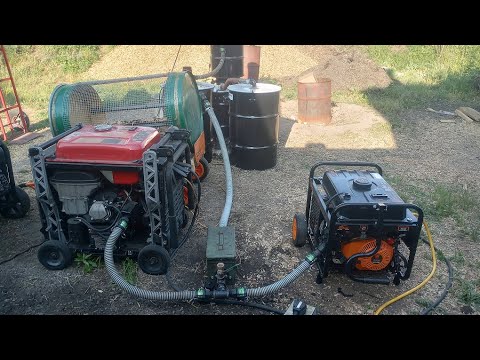

So woodgasssing the WEN today. lol only a day old and its converted to run on wood!! LOL.
Well it is chugging away out there along with the 9500. I dont think it will be able to sustain the gasifier solo though. But with the 9500 it hardly skips a beat. There are times it has to compete with the 9500 but once they are both stable they both just chug away.
