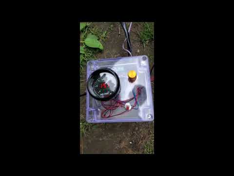

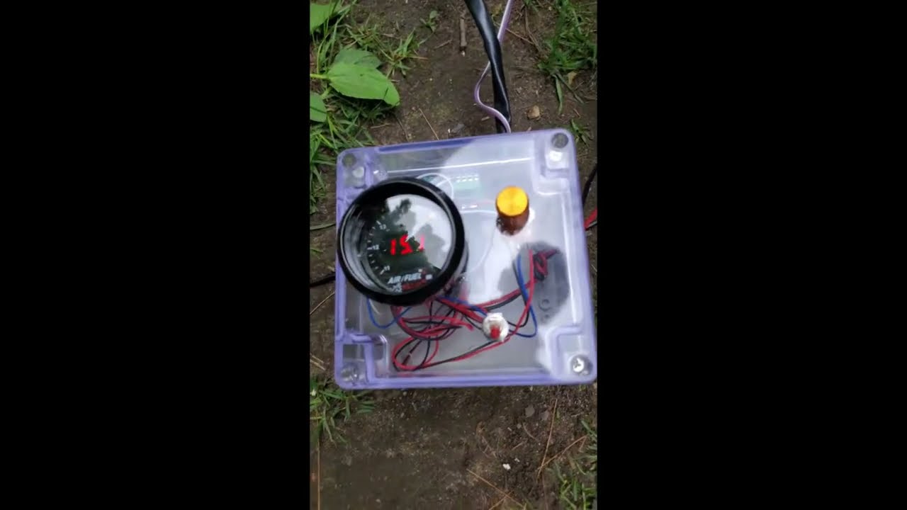

This is my first attempt with Matts auto AFR. This is truly amazing!! This was the best run on the ammo can and the free gen. Resin printed the AFR body but i have one printed in PETG that i will be testing next. I am also using Matt’s carb adapter printed in PETG, works like a cham. 2hr print time on adapter and 3.5hr print time on AFR body. Very cool stuff.
Thats awesome!!..
That’s bloody brilliant , well done to all concerned .

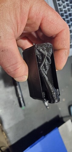

You need to re orient it you have to print it with the base on the build plate.
When you set this up in Cura it should look like this. It is designed so that there are no supports required.
Thanks Matt. That makes a lot of sense.
I will reorientate it for the next one.
It’s a thingamabob. And a good looking one at that
