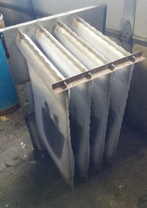

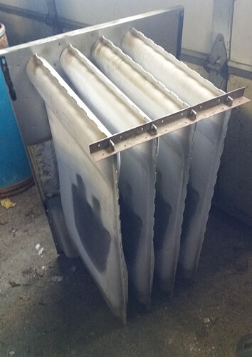

Hi Tom,
On my new build I am again using furnace heat exchangers for gas coolers like I did on my Geo Tracker only I am keeping them together as a unit like this and and they will sit down in the truck bed.
This whole assembly weighs less than 20 pounds and has over 4600 square inches. I will put caps at each inlet to wash out again. They are really efficient heat transfers.
