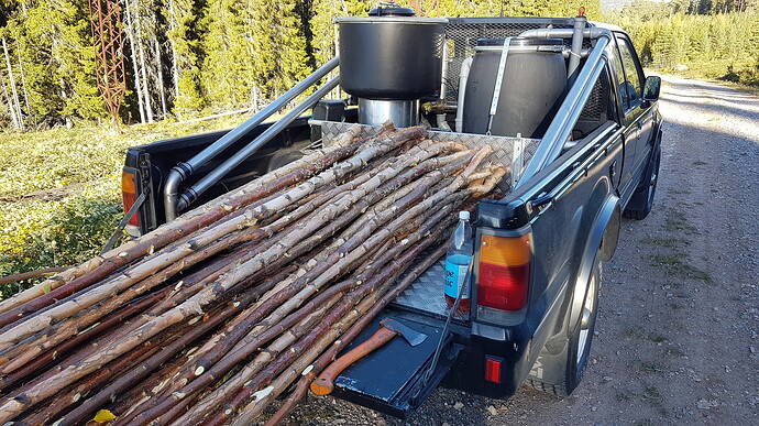

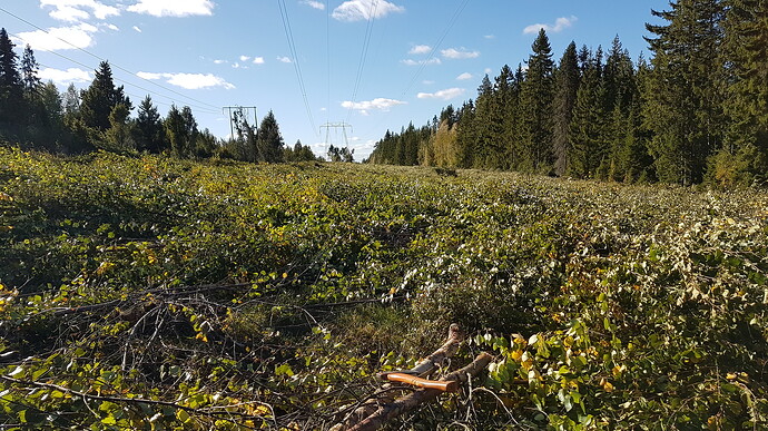

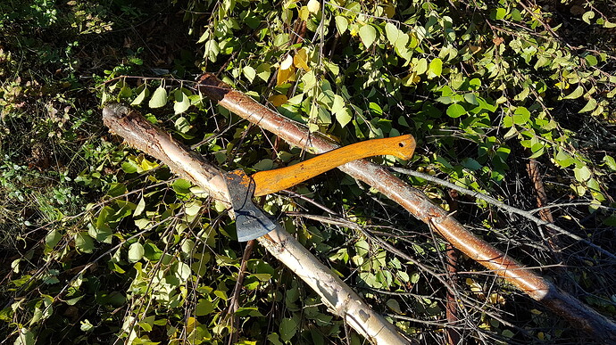

A team of Polish workers cleared our stretch of young growth under the power line yesterday. After work today I went delimbing a batch, HOWed (haul on wood) it home and chunked it. 100% birch. Premium fuel.
