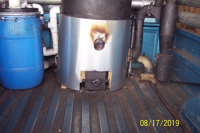

What is your seal for the ash door, I think I have a similar door as you, but find it difficult to know if it is tight?

I took a couple of photos of my ash clean out, but could not get them from my camera to my new computer. Here is one of the outside.

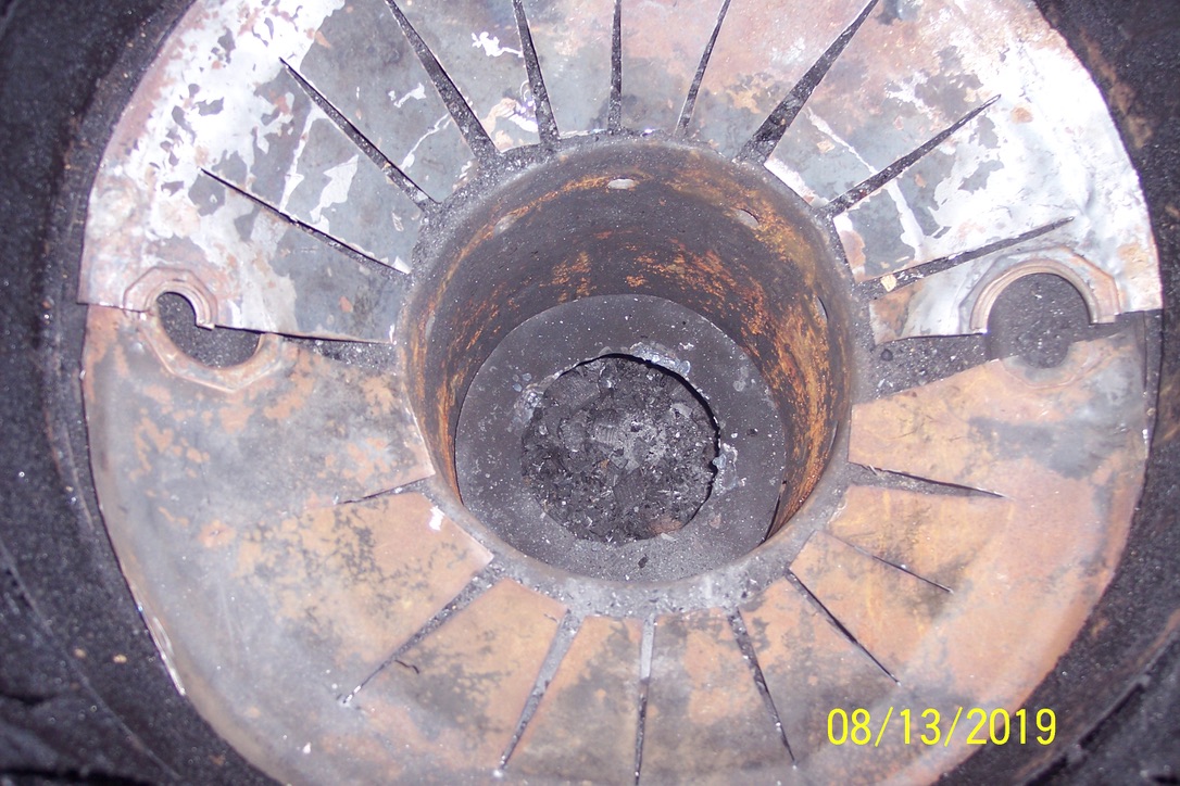

Here is/are photos of my fire tube that ran so well. It is 10 inches in diameter and about 10 from the nozzle to the restriction. Don’t know what the diameter of the restriction was-- just a ring that I had laying around the shop. Maybe you can get an idea from the picture.
TomC
So you just mount yours on the bed instead of inside the bed? If I can’t build my charcoal unit on a rear rack for my Sierra I might just have to go for something like this.
Hello Cody,
Yes my gasifier sat right on the bed. At one point I found I was getting too much wind resistance with the stuff sticking above the cab. I think if you go back through my pictures you will see where I had to cut everything down to get them even with or below the height of the cab. TomC

I have a 12 “fire pipe and a little over 12”, between nozzles and grate, so it should work to do as you have done, would be interesting to try.
Jan; Can’t wait to see how it works out for you. The good news is with a 12 in. dia. firetube, you could put some “heat sink” panels around the tube like JO and still have a good 10 in. dia. working firetube. Even if you can’t get SS, just plain steel plates would work. And the 12 in. depth of your firetube is a plus–you can set you restriction even lower than I did. I would have liked to put my restriction at 11 or 12 inches. Now the bad news—I was working with 10 nozzles and it looks like you have only 5. If I recall, the holes were 3/8 in. with the nozzles removed which is how I ran it.
