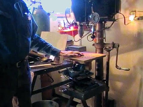

Easily Removable wooden table that fits on top of a Drill Press XY Table with Vise.
-This little sacrificial wooden table allows me to keep my XY table on my drill press all the time:
Pete Stanaitis
Thanks for the idea Pete. Now I can mount my xy vise which I have been wanting to do without worry of taking it off and on often.

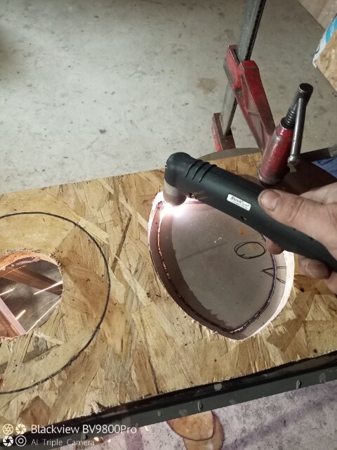

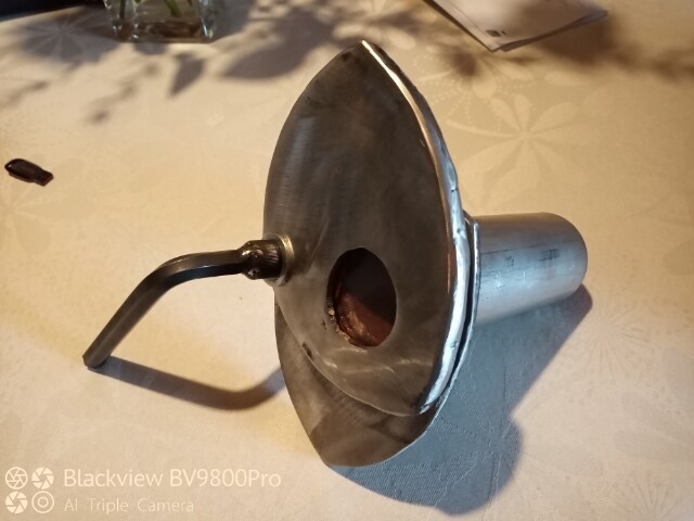

When you don’t have a cutting table, a template is a solution.
So the metal that I cut was used for the realization of a visit eyelet to see the combustion in a boiler hearthoeuilleton

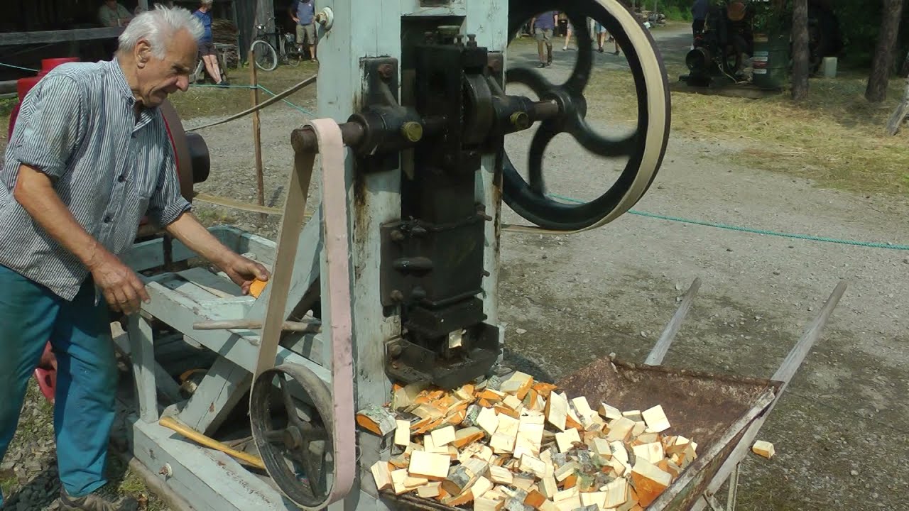

Nice idea there Wayne Keith, that beats trying too get a syphin hose down through a gas tank filler tubes. That gallon might last a week working your v10 farm truck, from your wood gasifier primary fuel supply.
If you enter the (omställningsresan) on youtube, there is a lot to see.
sweet niblets! Thanks, Jan! example:

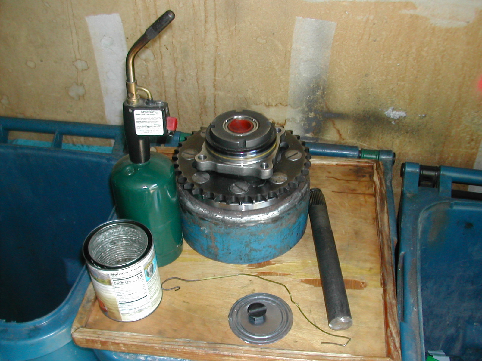

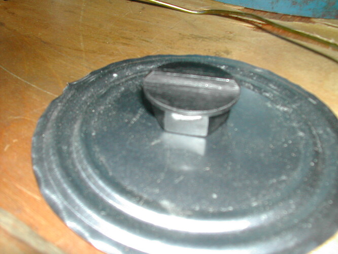

I made an impact tool.
I would have needed a really big screw driver to tighten the 5/8 inch slotted screws you see in the picture. And then I would have needed a really big arm to turn it, which I don’t have. So I wanted something I could use with my impact wrench. I checked the local hardware stores, internet etc… Harbor Freight came the closest, but way too small. So I decided to try making something.
I used a piece of an axle shaft from a '98 Bronco. The shaft was very hard I had to cut a chunk off with my angle grinder. I took the temper out of it by getting it red in my forge and then letting it cool slowly in a coffee can full of charcoal for insulation. I had to put a lid on the can or all the charcoal would have burned up.
I then made the tool I wanted mainly by using a hacksaw and file.
Last I tempered the tool. I heated it up with a torch bright red and then dunked it in old motor oil. I bent a piece of coat hanger wire to hold the tool while I heated it and to allow me to lower the tool into the oil without splashing. I was very worried that the oil might catch fire, or boil out of the can or something like that. But nothing bad happened. It made some smoke, that’s all.
The tool works really well. I got all the screws tightened up and didn’t break or ruin anything.
This is very interesting! Also, what is the contraption you have in the last picture? I see a sprocket, a bearing, and a clutch pack? Please write some more about this, thanks
Hi Bruce,
Thanks for your interest. The blue piece is the cutter for a wood chunker, the bottom of an oxygen cylinder. The sprocket will drive it. They are attached to a wheel hub for a Ford F250. The countersunk screws are necessary so their heads will clear the part of the hub that attaches to the frame. This is a work in progress. I’ll make a full presentation when I have some results.
