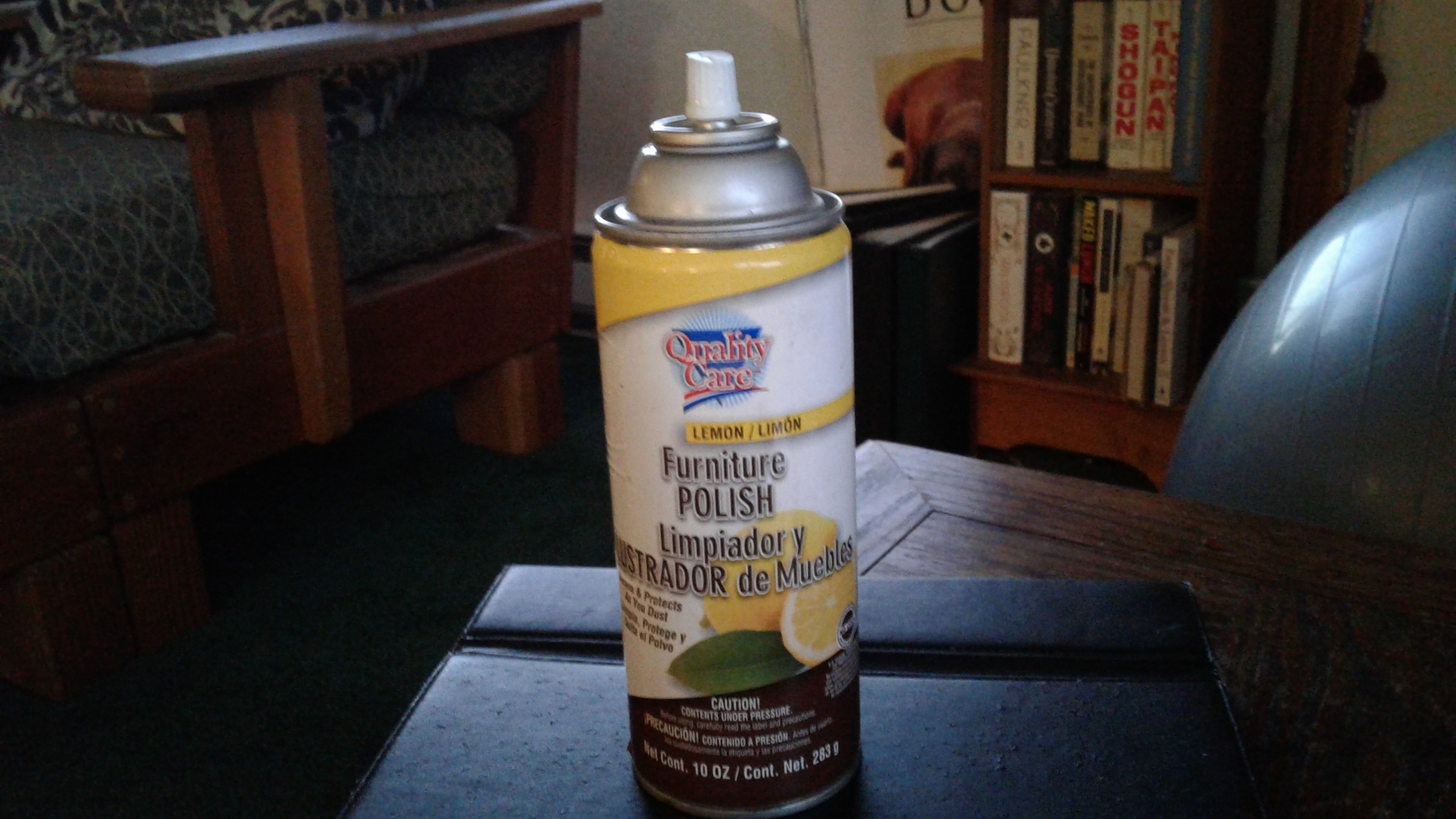

Hi all DOW members, is your hopper lid sticking? I have tried grease, silicone, white spray on grease, anti seize, oil, Vaseline. They have one thing in common, messy if you get it on your self or the black truck or what ever the color is, and hard to get off the paint and windows.
I have found this stuff works great and it smells good too.
Just spray it on the lid. If you get it on the truck it just shines it up. I use it, before I light up the gasifier, and when I am shutting it down for the day. No more stuck lid, having to pry it loose and cleaning up the mess I made. Try it you’ll like it. Oh yes, it is a lot cheaper than some of the other products.
