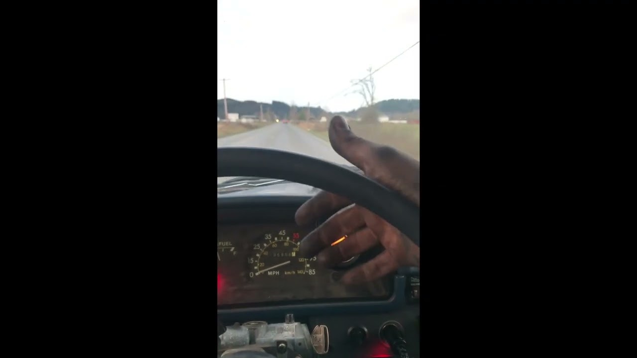

Just something crazy that works for me
I think with simple add on’s any system can be able to do this trick
I have done that before Marcus and collapsed my plastic filter barrel. Lol. I never tried it again. If I switch back over to a stronger steel hayfilter barrel I will try it again. Good Job on finding a new going down the road driving trick in cleaning the fines out of the charcoal bed. In gasification there is still new things to learn. BBB on down the road.
I could hear my barrels talking some if I was at high rpm, but my regular high idle seems to do it pretty well. Now it does weaken the char bed some since it burns so much so fast, but I just drive really easy when I need to do that and it seems to work really well at getting the vacuum ration back where it needs to be

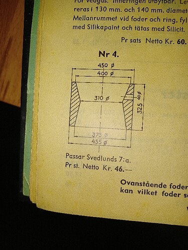

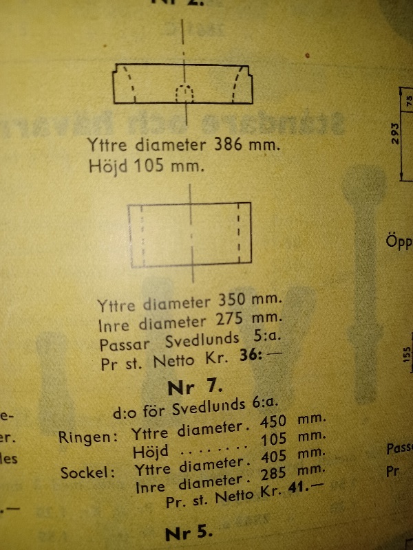

I dont know if this is of any help for you, Cody, but here are some pic’s of spare-part for Svedlunds gasifiers (unfotunately from 1942 :confused:)
Some info: they where casted in “Silicit” a long gone brand name, for a refractory material often used to repair retorts in city-gas plants.
A sort of silica material with crushed fireproof bricks mixed in for filling.
No reiforcements in these, even if i believe it wont hurt with some.
This is great actually! I was wondering the full dimensions.
