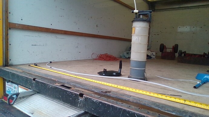

What do you do when life hands you a 6 foot long dipstick tube??
Make up a 7 foot long sucker tube:

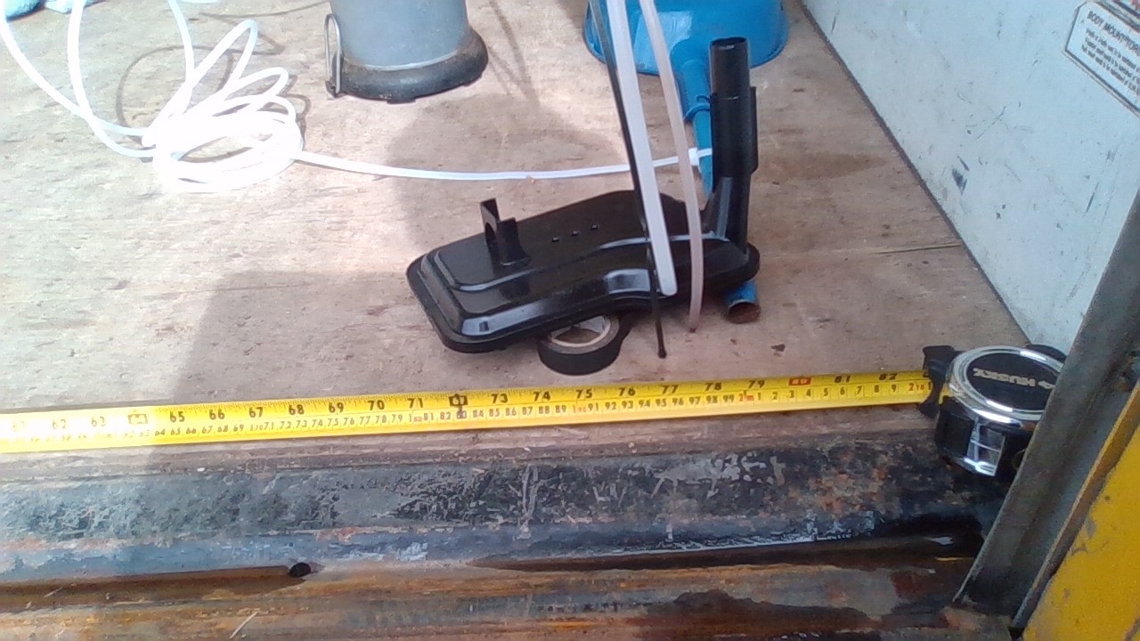

The first version would only take out ~1 quart/ 1 liter. It hangs up on the filter top edge.
The second version with thinner pvc tubing, and with angles cut ends; does wiggle down past the filter edge. I can get 2-3 quarts out in a session. Ha! Finally figured out that the flat dipstick having a molded plastic round spear-end was to be a guide past the filter housing.
Tubing is ACE Hardware water supply lines and rubber stoppers step drilled as air tight connectors.
If this isn’t a Captain Obvious tool for Woodgas people then I better mention it.

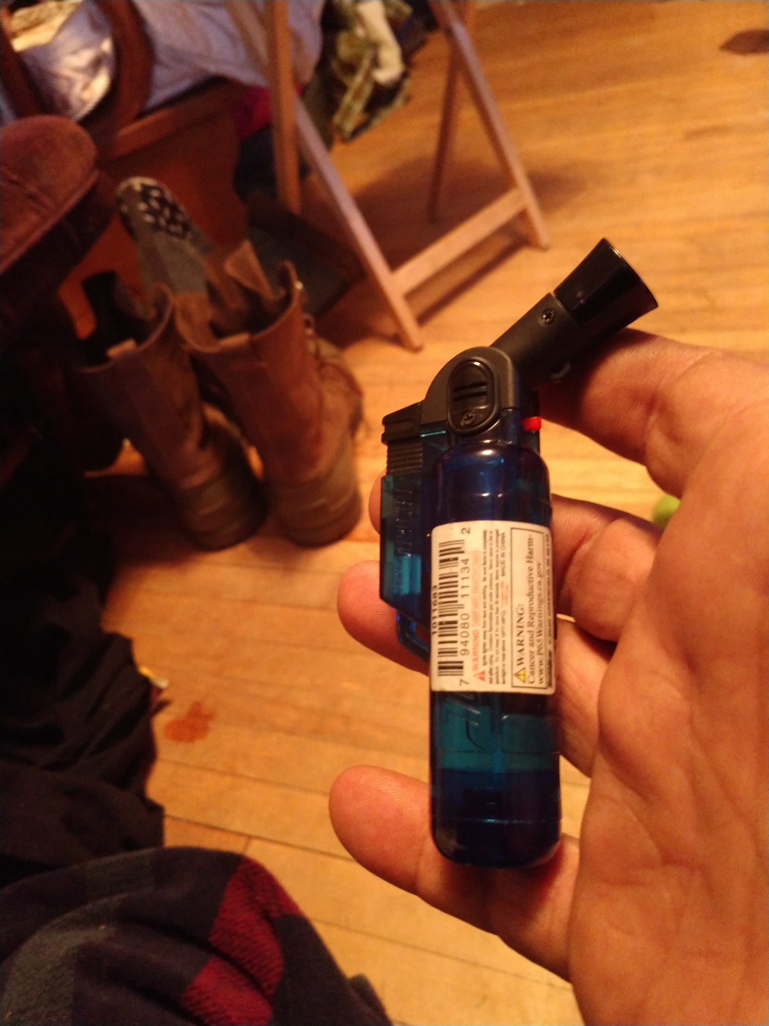

It’s called a Turbo Blue, and I get them at the dollar store for $3 a piece.

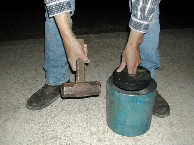

Here is a good method my friend, who is a welder, taught me for making pipes round, if they are not. For instance if you roll a piece of flat metal and weld it together. If you use an anvil that is only a little smaller than the inside of your pipe you can make it almost perfectly round.
There is a second tip in that picture, it is a short handle persuasion stick is handy for tight spots
This might be the perfect trick for an air cylinder I have. It has a slight dent in it, which makes the piston sticky.
