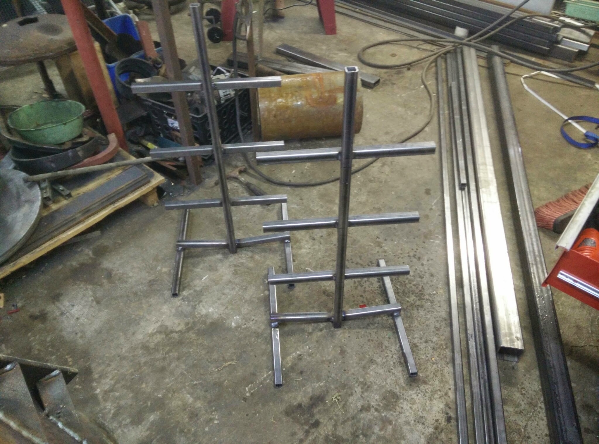

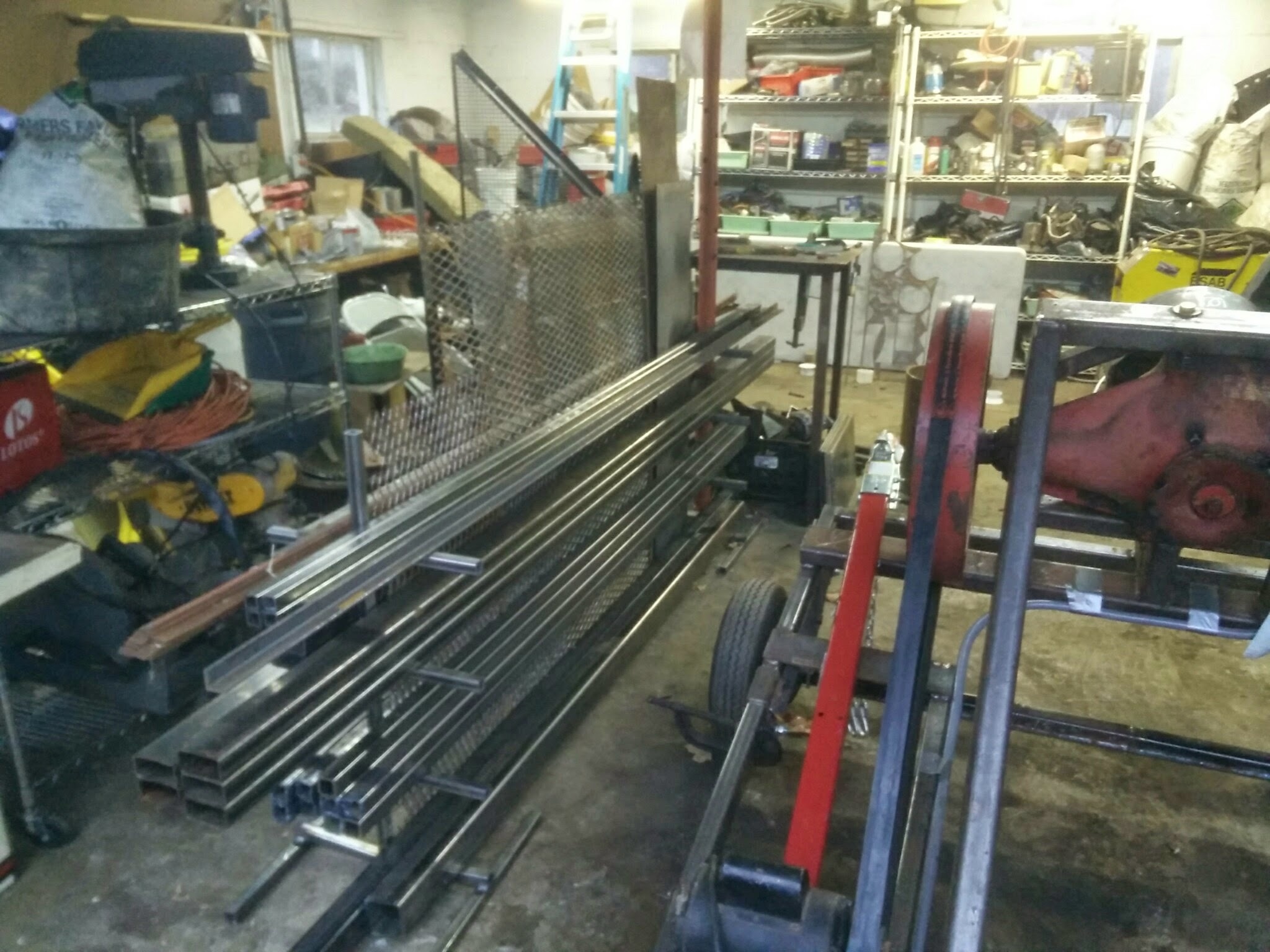

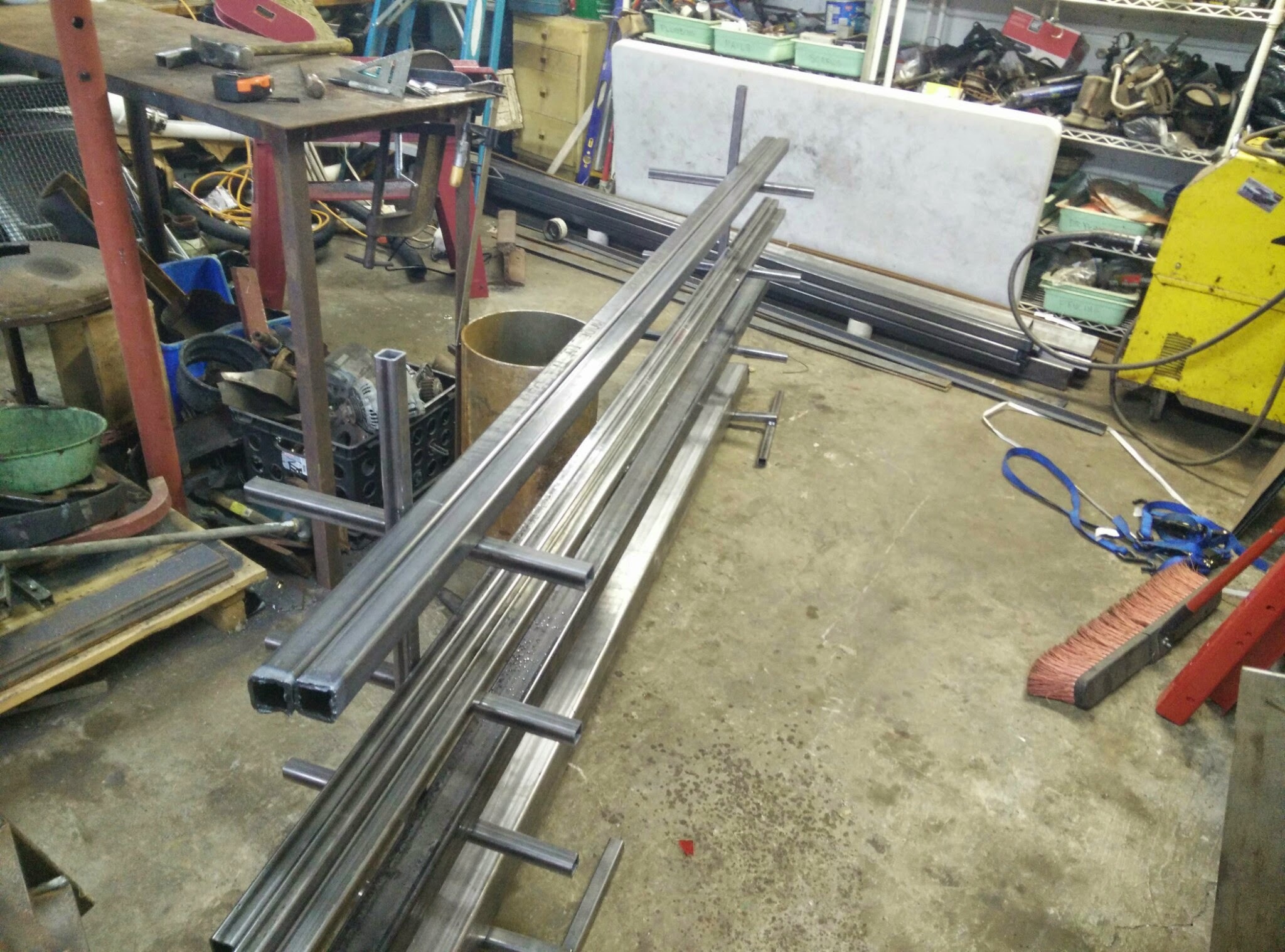

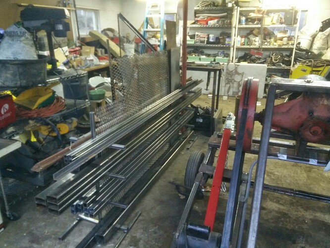

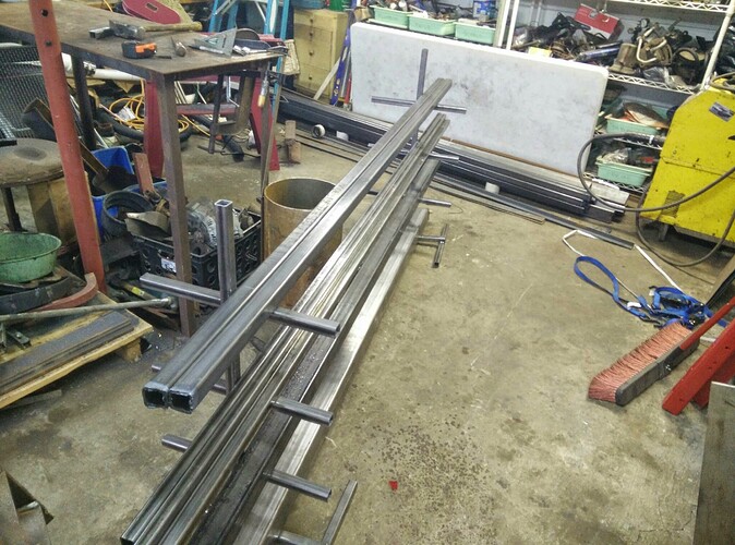

I guess this should go here, it’s a homemade tool, and it’s pretty trick.
I built these two years ago when I brought home a load of 12 ft metal tubing, bar stock etc. and had no way to organize them. They’ve held up amazingly well, and I can’t think of anything I’d do different. Made from 1" square tubing.
Those remind me of the Jamie Hyneman shelves that he talks about in this video:
Check out his nesting work tables at the end too.
That’s actually where I got the idea, sort of. His shelves are all wall mounted and full height, whereas I wanted something freestanding.
Jamie’s insight about welding 1" square tubing is spot on. Easiest/cheapest/strongest method to make a framework.

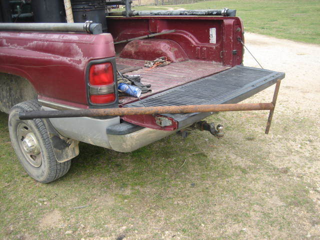

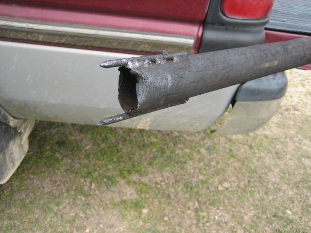

Hello all

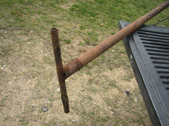

I may have mention before the grate shaker I made .
Really works good
Hey Wayne, are you shaking that hanging grate daily or just when you’re seeing the vacuum ratios getting out of a good range?
Hello Doug .
I only use the big shaking tool when the vacuum ratios get out of range ( plugging )
add a link connecting to the right side of the rear axle through the box to the handle and when she starts pulling hard; just weave over to the shoulder and hit a couple bumps to free her up.
Seriously officer I was just shaking my grate!!!
Wayne, does that big tool shake the truck
Hello Pepe .
Yes , If you put enough muscle on it I think it will shake the whole truck
i used one like that too open up my charbed when pluged half way up, before i found my stirring rod, Now that i adjusted the choke it stays clear more near the bottom of the tube.and makes for a less disturbed tar cracker.

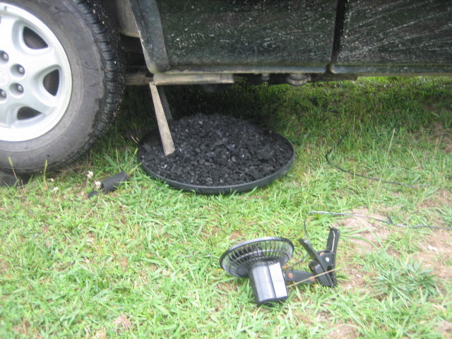

If there is a little wind or breeze it will really help keeping the soot away from you . If there is no breeze I use this little 12V fan . Works good
I keep a fan in the shop just for that. Charcoal dust spreads like a fog.
