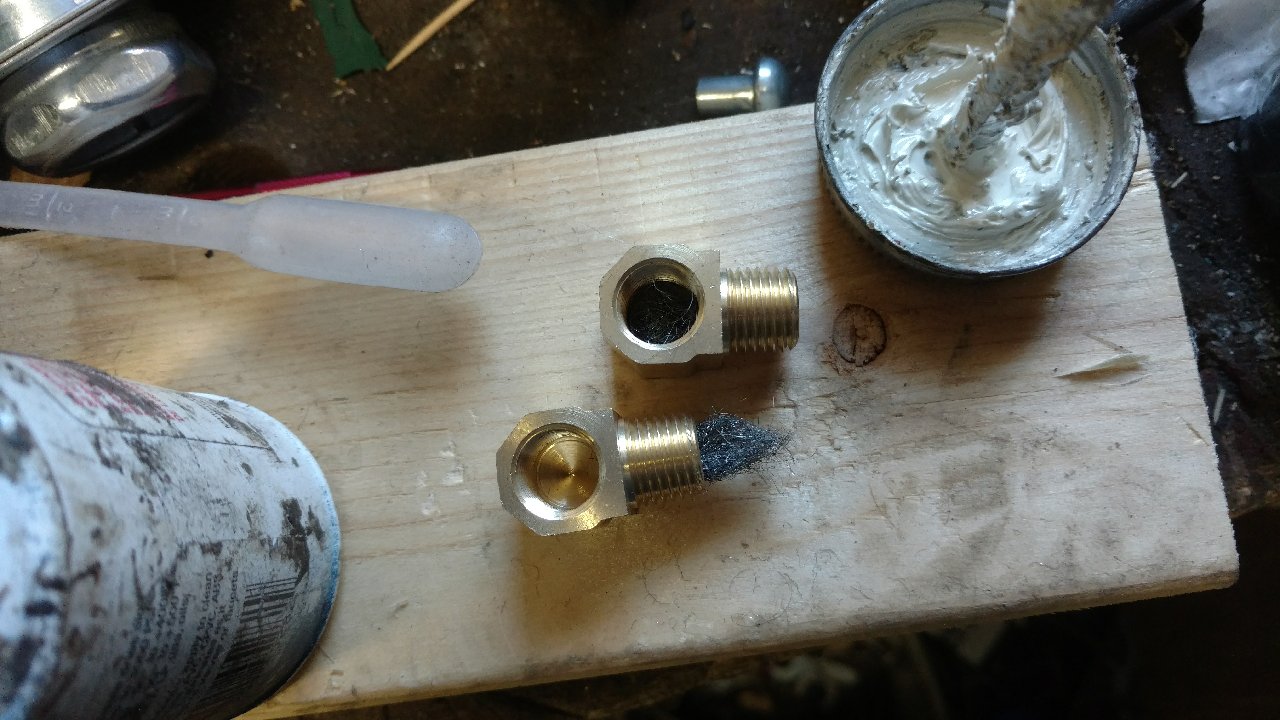

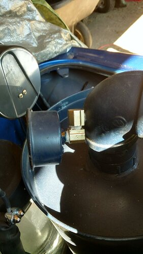

Vacuum gauges sometimes get gummed up on the inlet side of the filter because there is gunk in the unfiltered gas. Here is my solution: use 2 90 degree fittings and fill the space where the fittings mate with SS wool or bronze wool.
On some gauges I have been able to unscrew the tiny orifice and clean it out. The orifice screw slot stripped out on my latest clog-up so I drilled it out. This radical step led to this new way to keep crud out of the gauge.

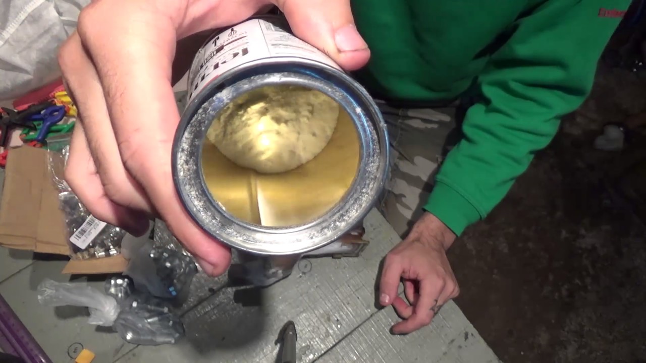

I did test the following trick and i am happy to share:
Superglue mixed with baking soda
Easy to find clips on youtube: example
Works as a charm for all those little gaps to fill and pipes to construct.
Been doing this for years building R/C model aircraft. Never used this technique for anything but wood, however! I prefer classic JB Weld for radiator repairs if you can see the bad spot. Thanks, Koen, for the tip, and the reminder of super glue and baking soda “composite” repair and construction. :slightly_smiling_face:

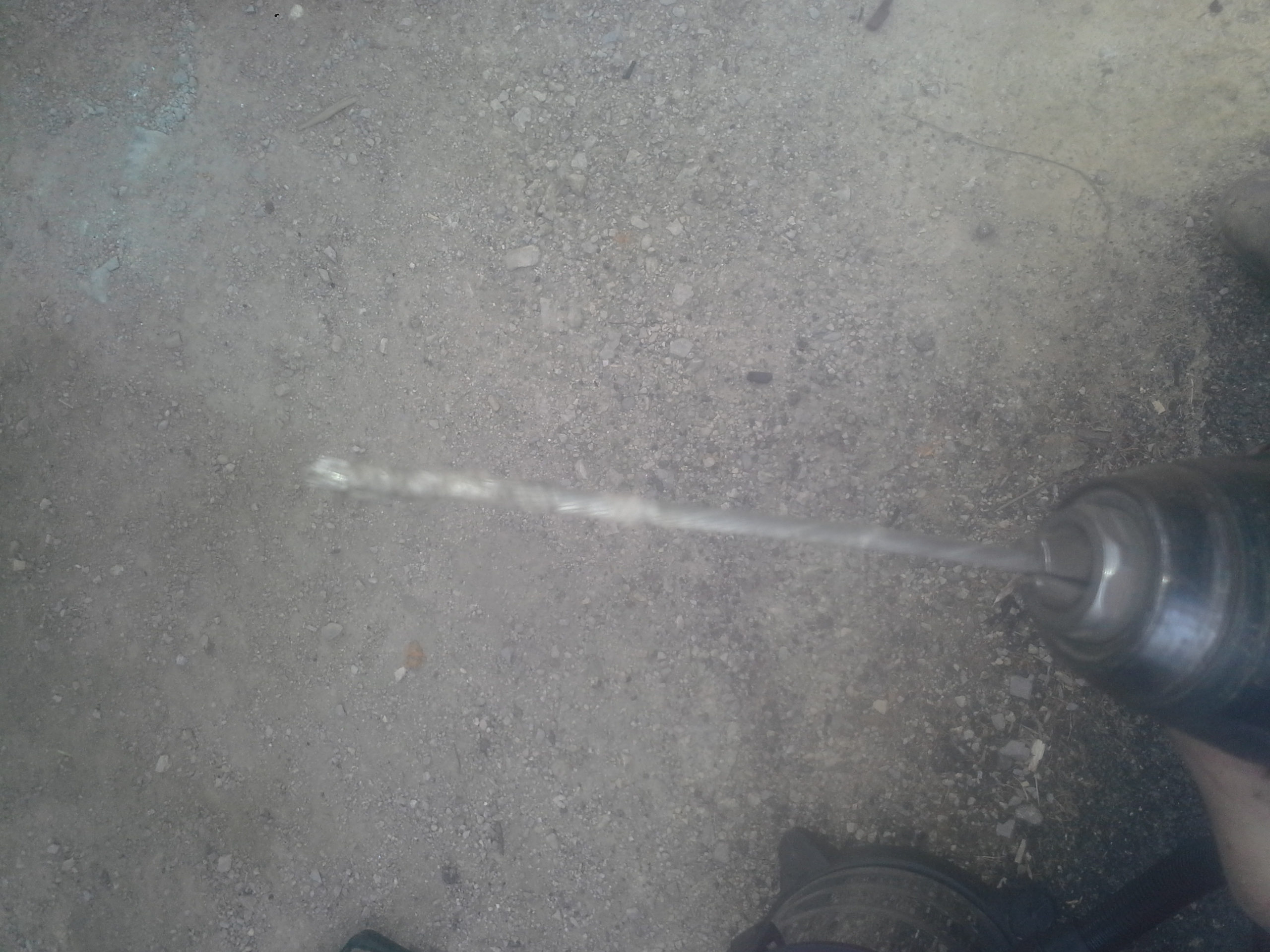

The picture is not wery good but this is a trick l discovered today.
I had to clean my gasifiers gutter becouse some tar baked in it so l put a peace of sturdy handbrake steel cable in the drilling machine and drilled out the crust. As the tip of the cable is spining, the fibres expand and make a nice fast spining brush. The spining cable reaches voyds snd holes realy well.
Thanks Kristijan for that great idea.

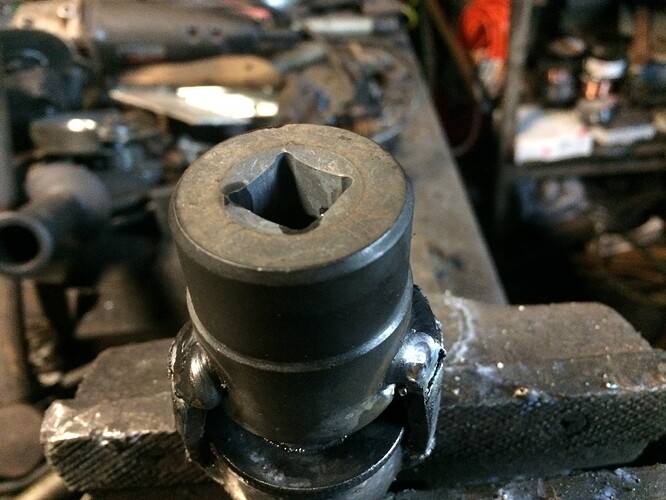

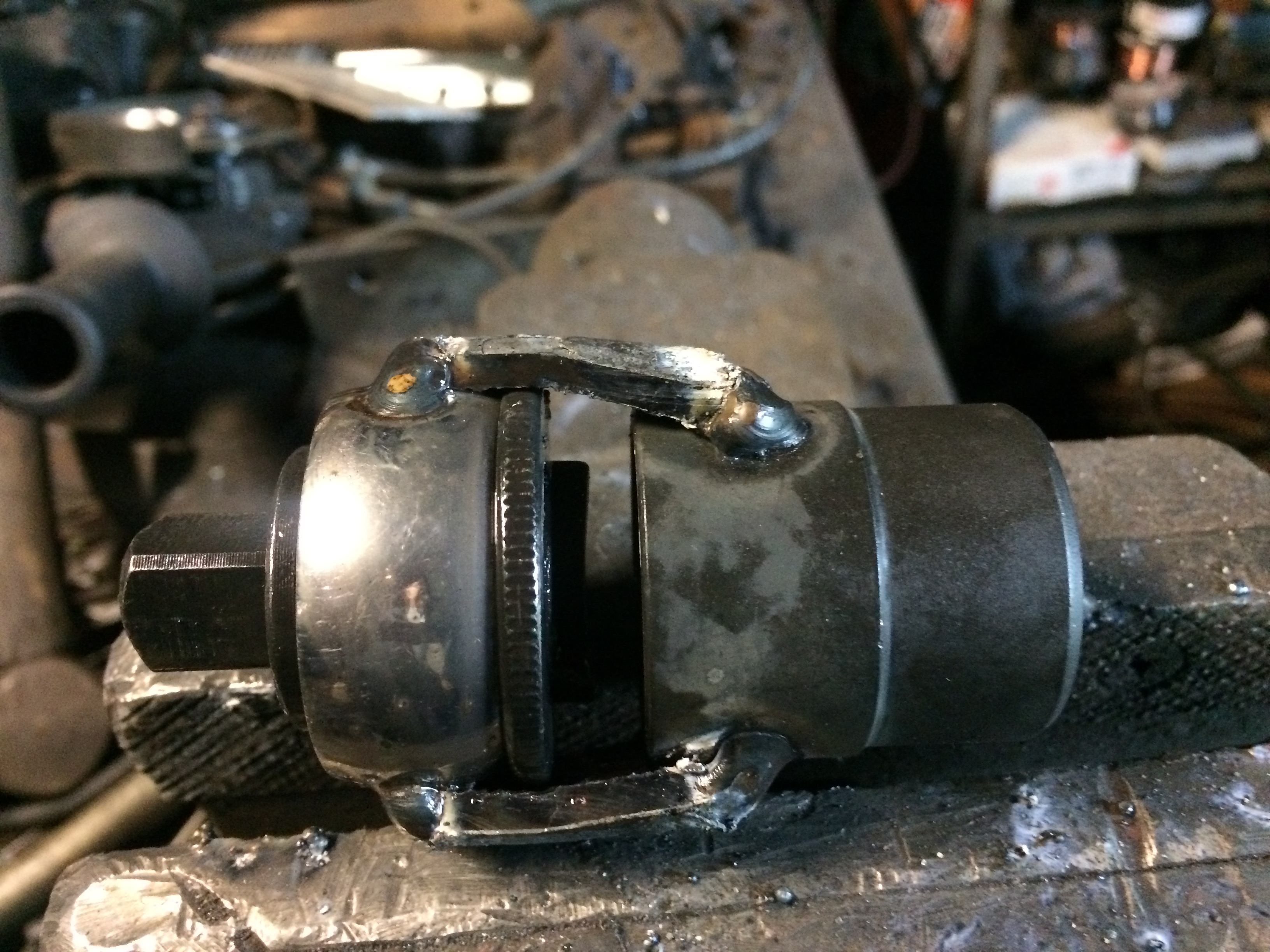

I finally fabricated a 1/2” drive ratchet motor starter
Haven’t tried it out yet, but with the gap the direction of rotation can be changed

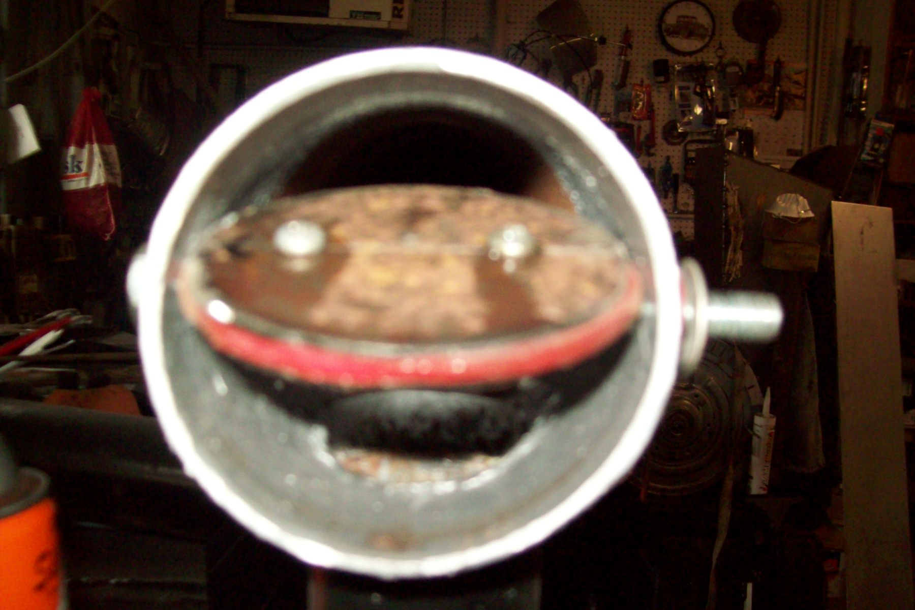

Here’s an experiment to make a shut off valve for blower on my Ranger build. Two discs cut from 16ga. metal about an 1/8’’ smaller than pipe, with a piece of 1/8’’ silicone gasket to fit pipe. seems to work well, time will tell.:question:
