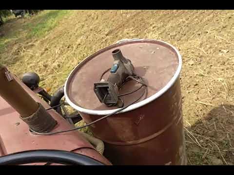

Johan, as I already mentioned above, now I only use raw dry wood, so I want to extract a little more water, well, the difference is significant, enough water is drained during driving, so almost no water is extracted from the front of the refrigerator, but still these the aluminum plates do not cool enough if the tractor is working on the spot, but for this case I added a fan. The video was taken after I sawed wood for about 1 hour, my neighbor Janez helped me, and this one drains water really intensively, there was about a spoonful of water in the front, and about 1 liter on the gasifier. Conclusion: aluminum plates dissipate heat from the surface quite well, they are almost as hot as the cover, but when I cool everything together with a fan, this is an optimal effect.
Joep, Marcus,… thanks for your support,… :grinning:
This is really good, not much water/steam through the gasifier besides the part that gets to become hydrogen gas.
I am guessing the fan only gets used when stationary work is at hand, not when driving.
Very good thinking /doing Tone :smiley:
I remember seeing an electric fan on the late Mike LaRosa’s trailer unit. He had it for heavy traffic on the cooling rails.
I’ve been thinking for a stationary unit to find an efficient low amperage DC fan for the cooling rail and to a lesser extent the hopper, maybe the battery charging circuit off the generator would be sufficient.
I have one for my jeep build, it will bring in additional air to flow around the gasifier area when not moving down the road or on really hot days.
I was thinking the same for stationary work, but I have that spring fed cold water creek on hand. Usefulness…

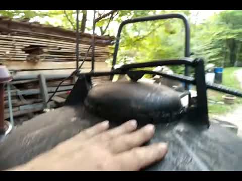

When I first mentioned I don’t want to do any welding on my thin and rare ss hopper, I had raising the gutter in mind. Tube fins like yours I can do - at least in the front and back and still being able to open up the trunk lids both sides.
I’ve noticed I collect maybe only half the amount of juice on a hopper of wood when cruizing non-stop on longer trips. Going in to town for arrends and stretching out a hopper load for several hours with stops, gives the hopper more time for condensation.
If you don’t mind I think I’ll try your setup on the Volvo hopper. Thanks for the tip.

The last few days it has been quite hot here, the temperature is up to 35°C, but the tractor works a lot, at least 3-4 hours every day. The fan that I installed above the gasifier does its job perfectly, I turn it on when driving slowly or when working on the spot, it is also more pleasant for the driver. :grin: Now I use perfectly raw, dry wood, about 1-1.5 liters of liquid is released from the condensation zone per 10 kg of wood, but almost nothing at the front of the refrigerator, the filter is a bit damp. The consumption of wood is approx. 6-10 kg per working hour of moderate load, the energy from wood is really incredible, if I stand back a few years, this would have been impossible for me, but now it is a reality. Slowly it will be time to open a new chapter of a compact unit for a van or truck with power from 5 to 40 kW. :roll_eyes::grinning:
