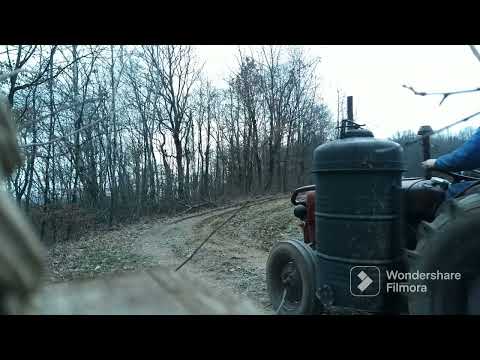

Fun and work, well, I noticed that the resistance of the gas increased, I had to choke the air much more, … in the refrigerator (radiator) fine ash and black dust accumulated, which got wet and stuck to the wall, dismantled I took the refrigerator and washed it. The tractor works again according to the “factory” settings.
Some stupid idea gives me peace, don’t try to guess what it would be, … the subject is clearly wood gas and my diesel Fergie. As I already mentioned, it happens that at high load and higher revolutions it works without diesel fuel, apparently the combustion chambers are so hot that the gas ignites. I intend to try to ignite the mixture with the help of glow plugs, which I would install in the combustion chamber, and I would change the heating power with the power regulator.
How do you determine that you are not using diesel, by pulling the fuel stop knob and it stays running?
Don, that’s right, I pull the stop lever all the way, otherwise I have it set to the minimum amount exactly.
The ignition theory goes like this, the engine piston compresses a mixture of air and gas, which heats up to a fairly high temperature due to the compression, but this temperature is not yet sufficient for ignition, but when a particle of gas comes into contact with the hot surface of the glow plug, it ignites and from here the fire spreads to the remaining gas. More heated spark plugs should cause a large pre-ignition, and less heated ones a smaller one. I would regulate the power and revolutions of the engine as before, the revolutions with the throttle, and the power with the ratio of gas to air, the operating philosophy of the diesel engine.
very interesting aspect…indeed in tilmans book swiss gengas is written about higher compressed modyfied engines for woodgas…there is to avoid every sharp edges to avoid glowing edges, that makes uncontrolled gas ignition…the idea with the pre-heating candles is great…ignition by controlled glowing …you will do it if it is doable!
I have some confusion about converting a diesel to sparked ignition. Where does the juice to fire the plugs come from? You can control the timing with something like a crank trigger ignition but it seems you would still need the coil and some sort of distributor, wouldn’t you?

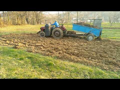

Today, the tractor worked for 4 hours, a lot of the time in low revs without load, and then fully loaded in high revs, it was towing a large trailer on steep terrain, of course, without a cardan drive on the back of the trailer, it won’t work,… the glow plugs will have to wait
