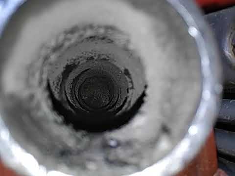

If you feel like using the camera in the future, a maintence vidoe on the system would be interesting. Condensation, ash cleanout, cooler flush etc.
JO , your number is definitely 99% wood gas, so I’m pretty far behind you, good to comfort me a little. :grinning: I am also comforted when I think that the modern diesel engine 2.0 tdi at idle consumes approx. 0.8l / hour at 800 rpm, at 1600 rpm (these are the engine revolutions of the tractor, when the hour meter would be in line with the actual hour) the computer shows 1.3l / hour. If I think so, and the outdated 2.3l tractor engine is satisfied with 0.9 l of fuel per hour, I must be satisfied too. Cleaning will obviously be easy, only fine charcoal and ash are accumulating below, and the radiator and pipes are working clean for the time being. :thinking::fire:
