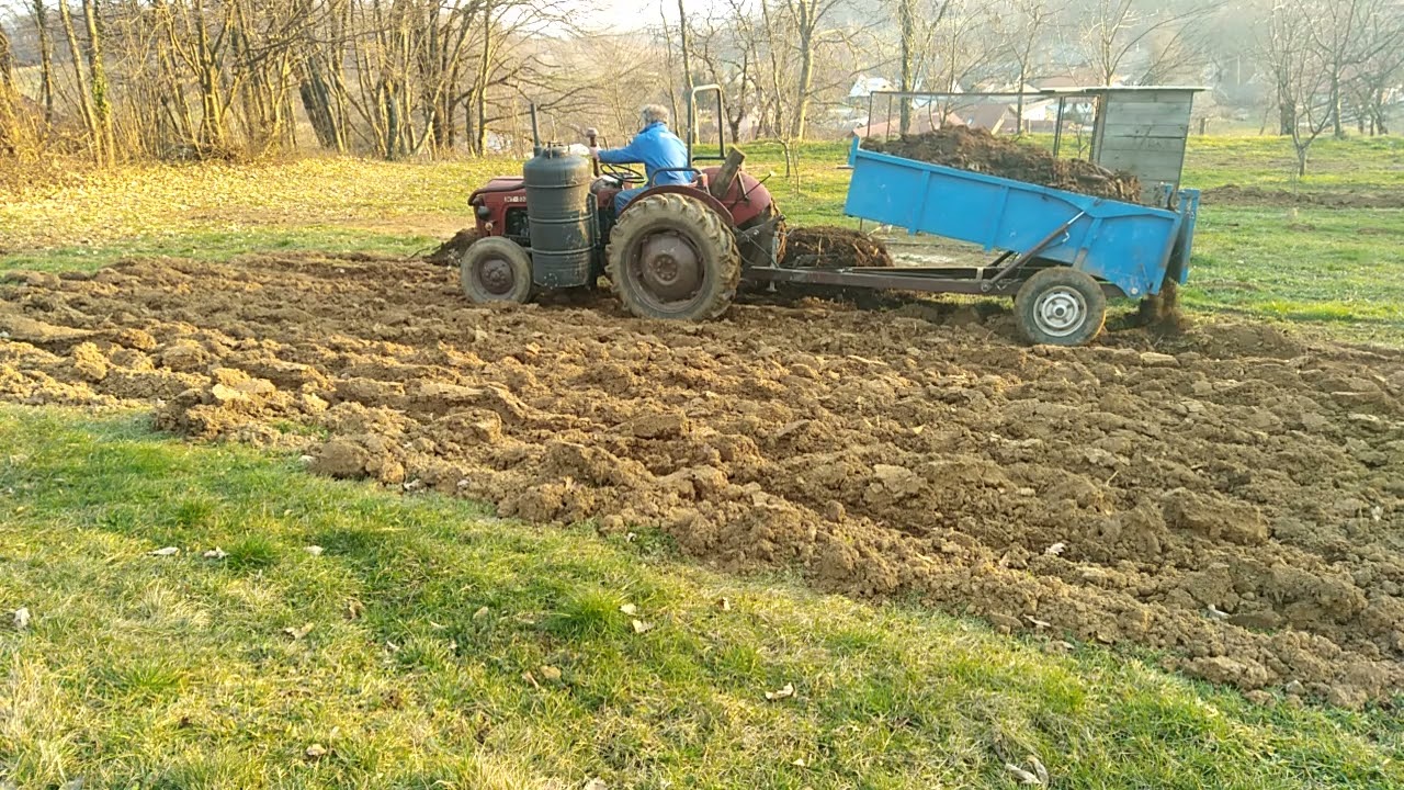

Delivery of humus, which I dig next to the forest, to enrich the field.

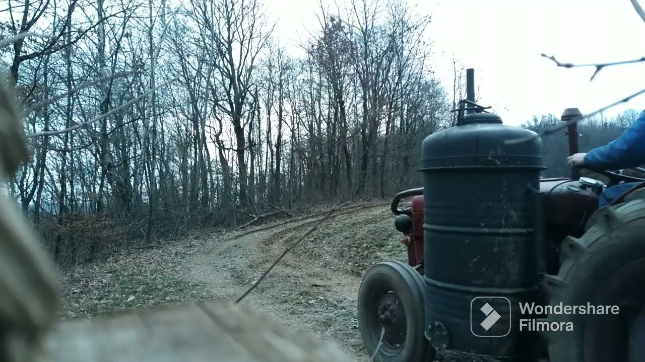

Today, the tractor worked for 4 hours, a lot of the time in low revs without load, and then fully loaded in high revs, it was towing a large trailer on steep terrain, of course, without a cardan drive on the back of the trailer, it won’t work,… the glow plugs will have to wait

Don, the gear ratio is fine in all gears, even reverse, because I switch the cardan lever to the drive position “through the gearbox” (preko mejnača), the down position, the clutch is for safety.
Don, some tractors, like Zetor and my Tomo have a pto powered from the gearbox, meaning the speed is based on wich gear you drive in.

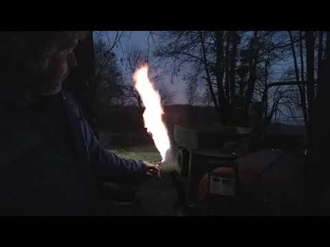

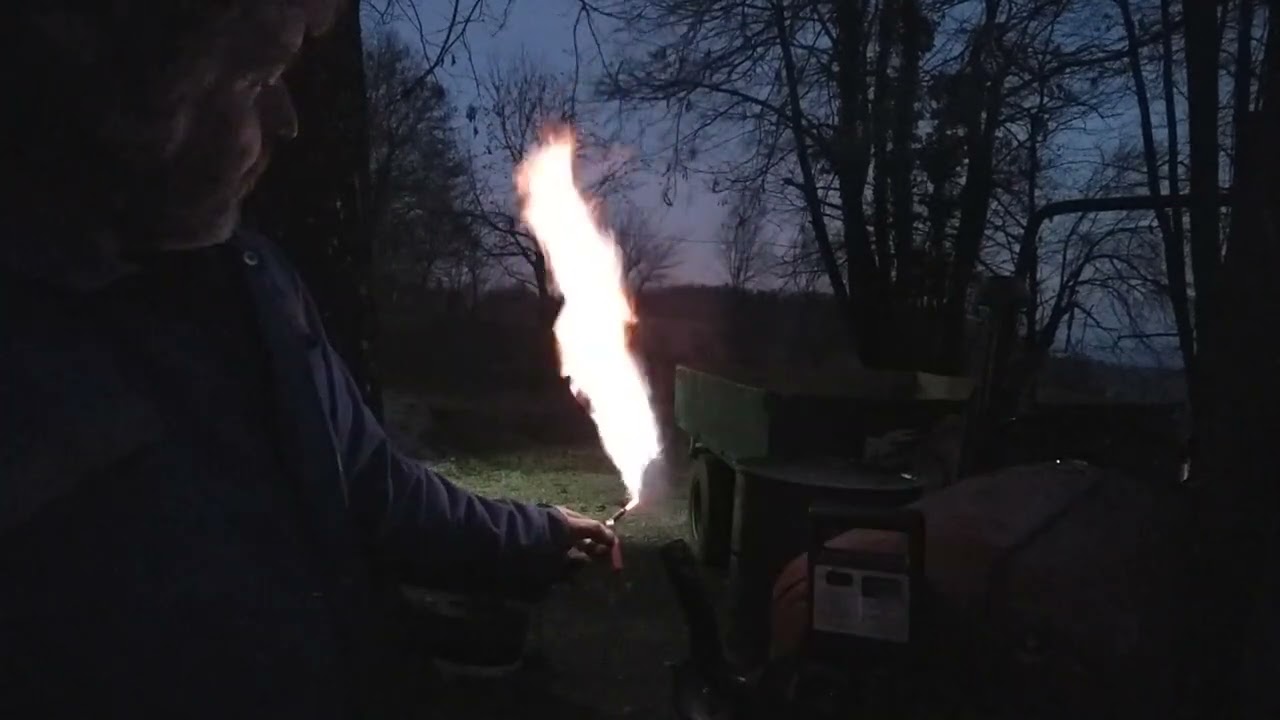

This is what gas ignition looks like after a long stop with a glow plug
