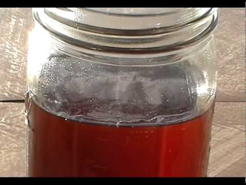

Joni you can use any kind of vegetable oil but I suggest heating it to remove all water.
I have seen people have success to add either a small amount of gasoline or turpentine to make it more ready to use in the cold months.
80% vegetable oil and 20% turpentine, it dissolves readily into the oil. Allow it to settle and any solids still in suspension will drop out.
You have the benefit of the oil being unused so you will likely have very clean filtered oil to begin with, but make sure it has no moisture.
Without any additions you may run the risk of the oil turning into gunk and clogging the injectors.
