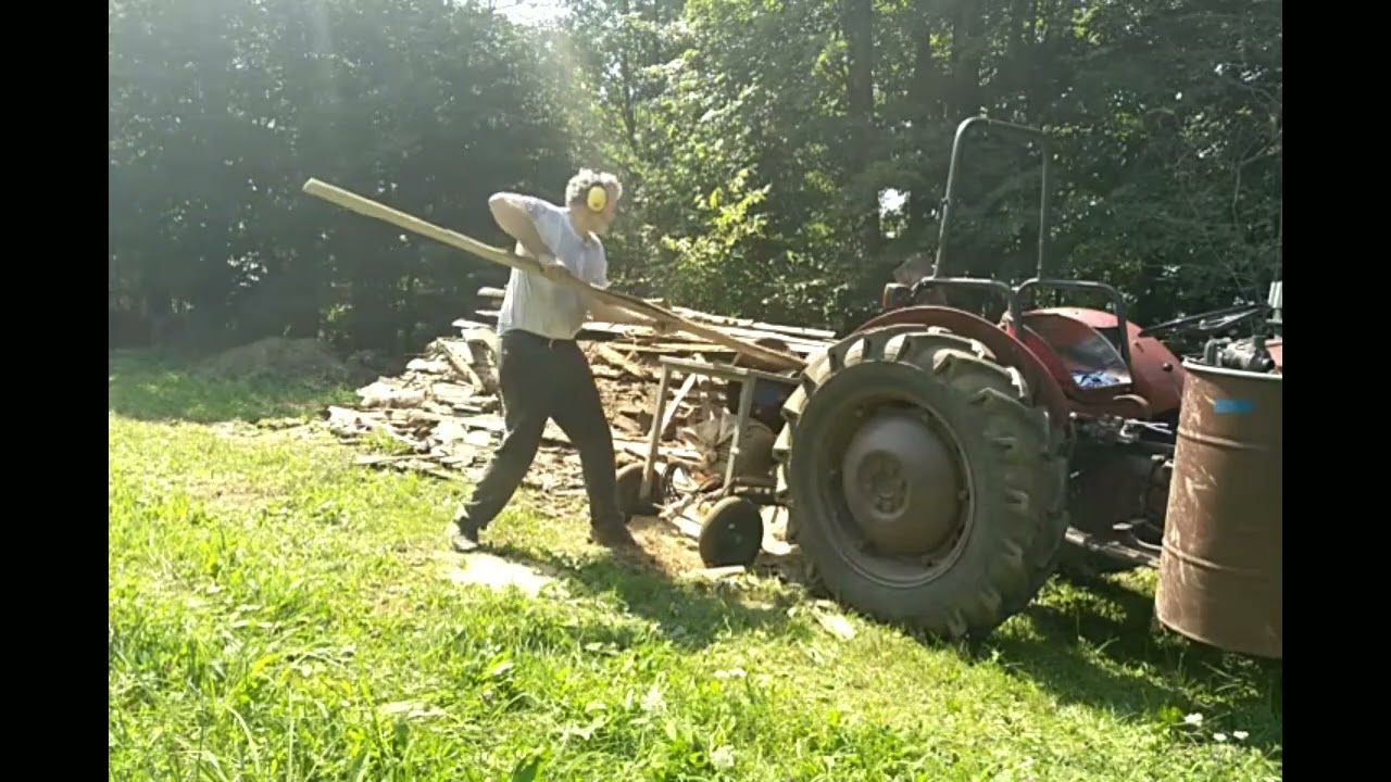

Yesterday I quickly adapted the circular for the tractor, an electric motor is also installed, which, with the addition of capacitors, would enable the production of electricity somewhere in the field.
I’m probably a little vain with these contributions, aren’t I , JO?

Not vain Tone. Interesting and sometimes fascinating. The more functions you can get a machine to perform the better. Your tractor is not a Unimog yet but getting there a little at a time. I guess you can tell what I have always lusted after. If we were anywhere near each other I have a 3500 watt Gen head I would give you to mount on that tractor.
It reminds me of a swiss army knife, very good, I wish I had half your skills.
I agree with TomH.
Not vain at all. Capable.

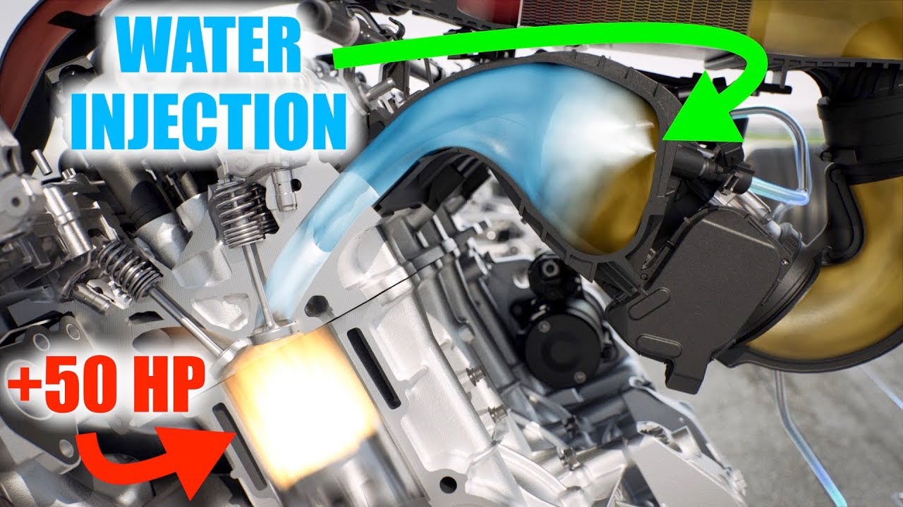

Not laughing. Moisture in the air/fuel mix slows down combustion, and actually increases fuel octane rating. This is old.
Some wwii fighter planes would inject water for extra power.
