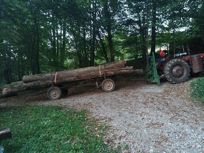

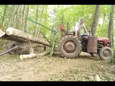

Yes I am wondering how you got the bigger log on that trailer. At first I thought, Well it’s Tone. He probably picked it up and put it there. Then I saw the winch. Watching you use that equipment would be interesting.
Yes, specially when there is a log on the trailer. How do you fix the next one? More video’s Tone. ![]()
Me too! A logging video would be awsome ![]()
I know making videos whilst working is troublesome, but if you ever get the oppertunity…
Today I disconnected the winch with the mounting lifting arm, I have to disappoint you that there is no video recording with this tool, but there is something for consolation, driving uphill with low revs, you may hear the gas mixer rumble, I am very satisfied with its operation. Before the slope, I only opened the throttle a little more, the rest is done by the tractor itself.

Thanks Tone! That explains things. Winches like that used to be pretty common here as well, but I don’t recall ever seeing one combined with a hydaulic arm like that.
It looks a lot like an engine hoist, but on a 3 point hitch.
I just recently uncovered our old 3 point boom crane, meant originally to just lift with the 3 point. I got a chain hoist to put on the boom so I can pull engines more easily. It will definitely be handy for logs and such too.
