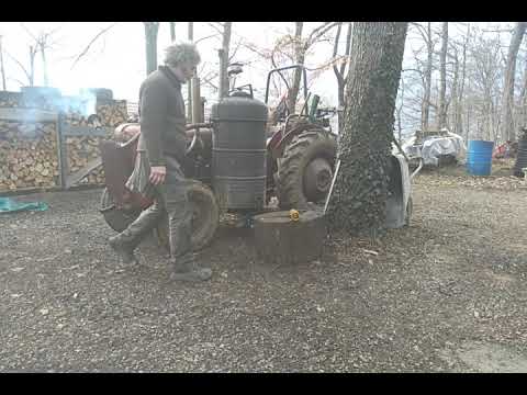

A humid day, even the wood is not the driest, because it absorbs external moisture. Jan last time mentioned that it is difficult to start when the gasifier is “stopped” for a few hours, especially if you fill the gasifier with fresh fuel before stopping. This is how it looks for me, I helped myself a little with propane when starting, but only for a few seconds,…

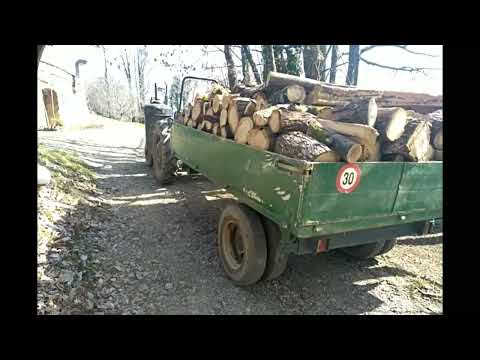

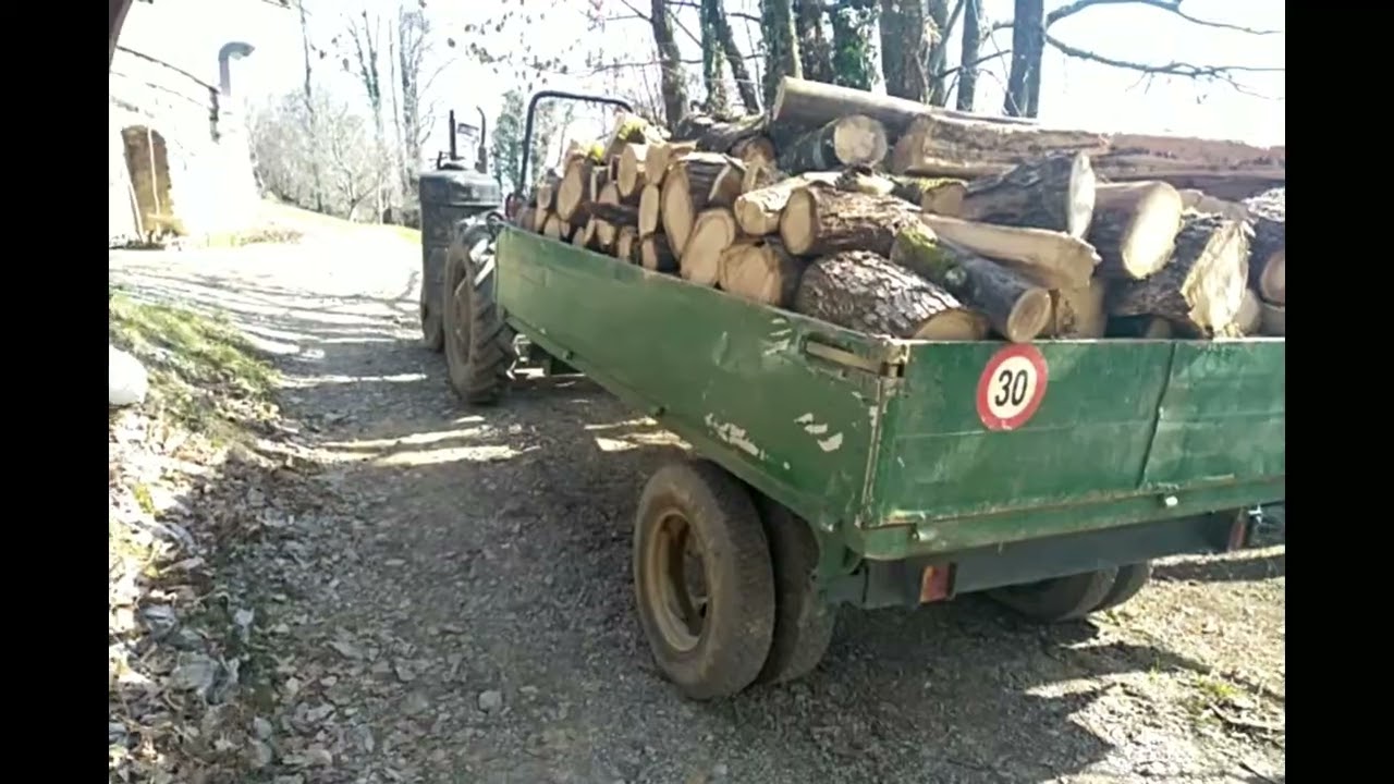

We’ve strayed a bit from the topic of tractors and firewood, so let’s get back to it in big style… my son Domen was in the forest with me, and I hitched up a large trailer on tractor
Side dump trailer. That’s a very good idea so you don’t have to block off the road.
