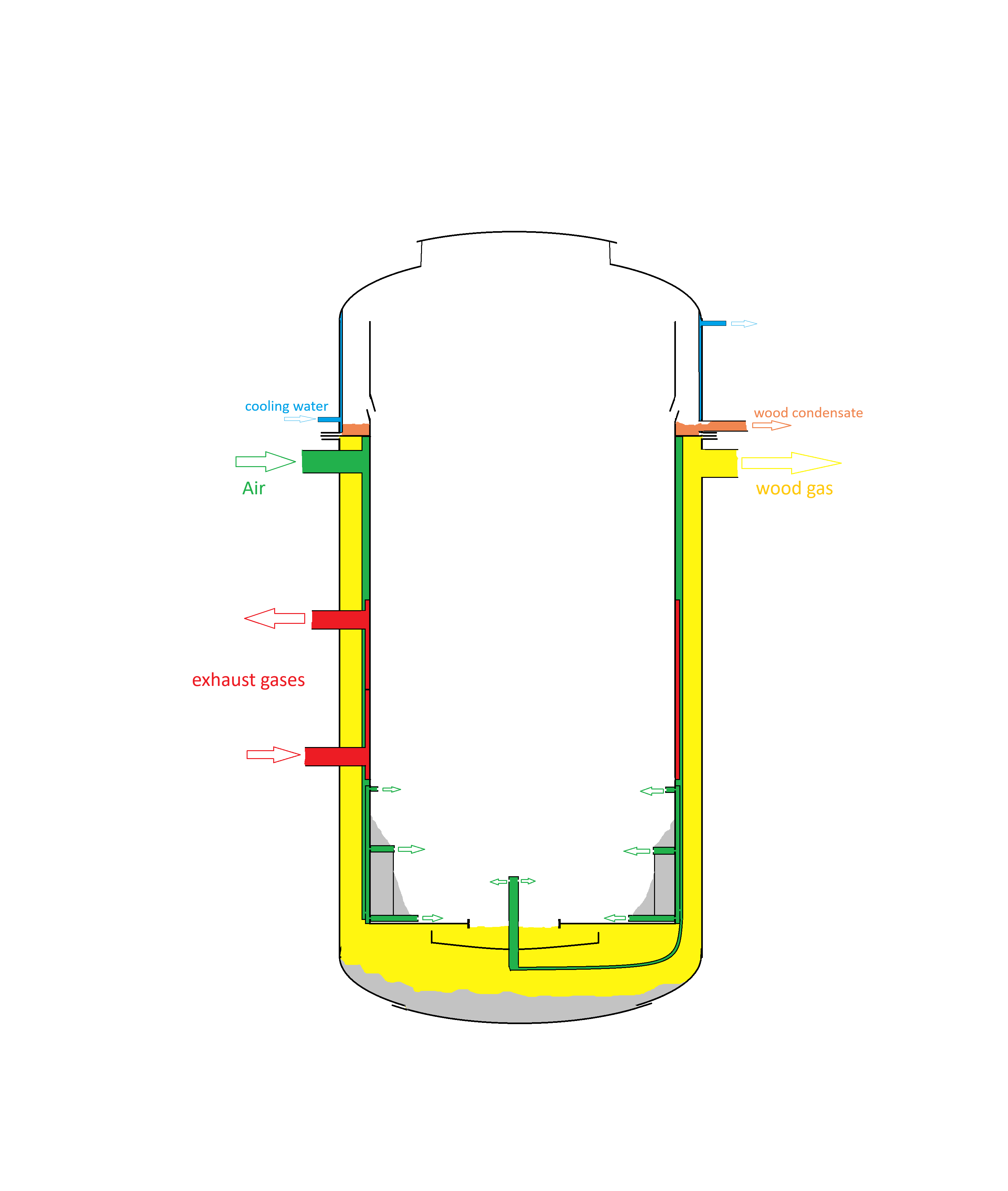

Okay, so now the hot exhaust goes around the upper hopper area chamber wall and out the exhaust pipe to the atmoisphere and also through the slot opening into the hopper and the hot gases cooks the wood down. Any positive pressure in the hopper gasifier can now go out these slots and out the exhaust pipe also while the engine is still running? What about all the tary gooye smokey stuff going back into the exhaust system?
Bob, the exhaust gases only heat the lower part of the wood storage tank above the hot zone, the upper part is water-cooled, where the moist pyrolysis gases circulate and dry.
Oh yes sorry, I mean the lower part of the hopper wood area. So the hot exhaust flows out on and around the wood when there is a negative flow in the hopper and down through the firetube correct?
I hope the sketch explains the structure of the gasifier.
download the image and enlarge the details you are interested in
Thank you Tone for this excelent drawing, on how your gasifier is built. I will have to say no one has ever built a gasifier like this one ever before. So well thought out on the design and all. The hot exhaust engine gases do two things, it heats your incoming air to the nozzles and helps with the pyrotizing of the hopper stored wood above the firetube. Your welding skills are very good. Looking forward to more videos.
wow. It is common knowledge my fab skills are non-existent, but that is next level fab with all those pockets in there. Lots of places for leaks… Otherwise, I really like the concept. How did you build the inner cylinders for the air, exhaust and water?

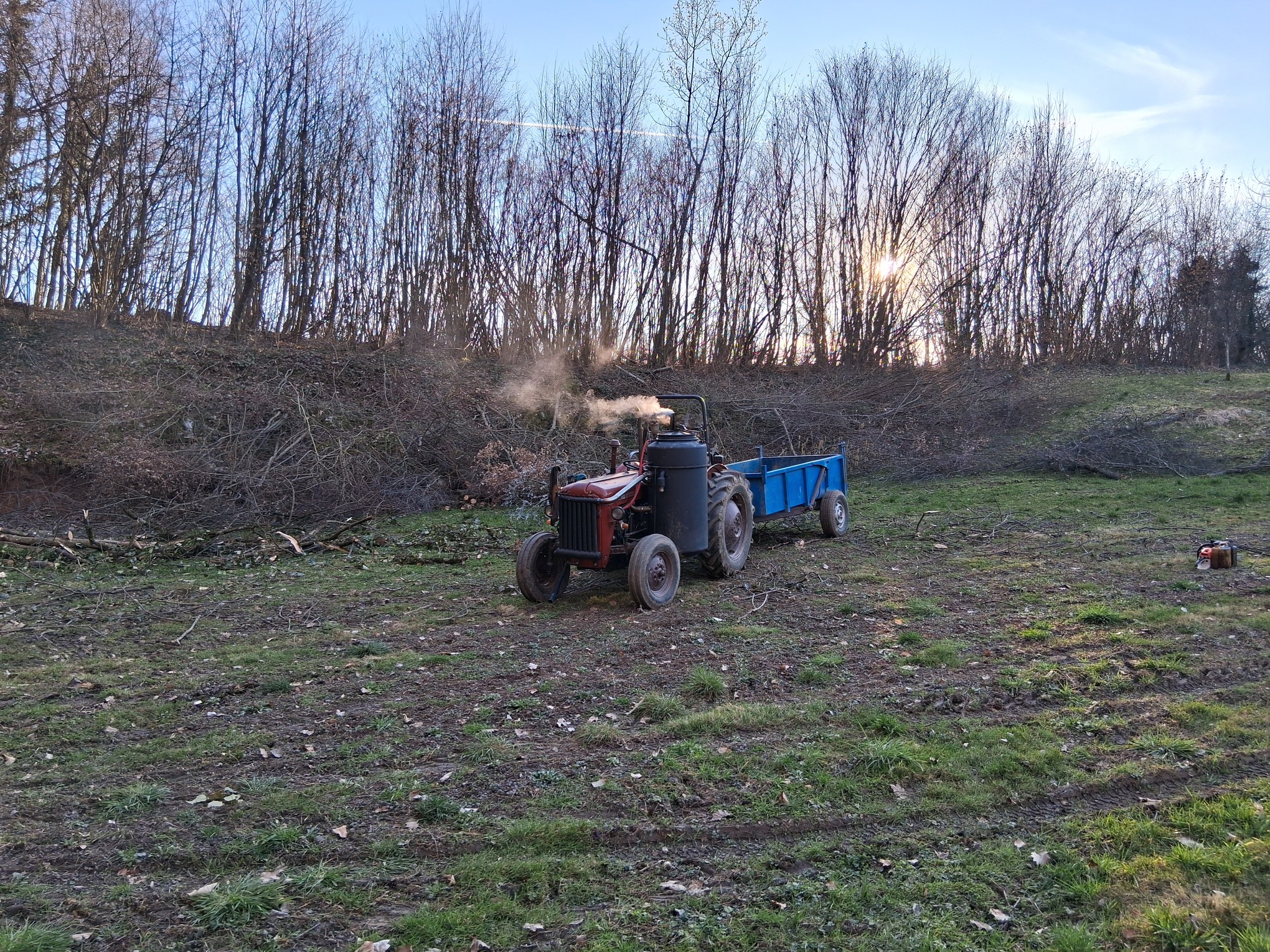

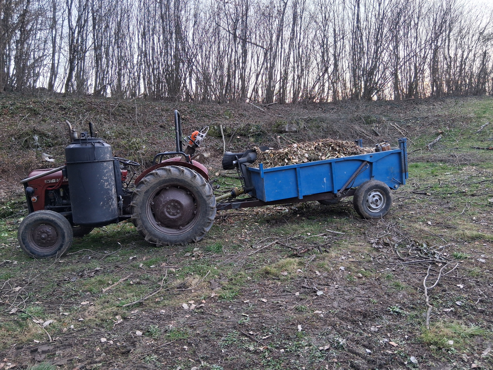

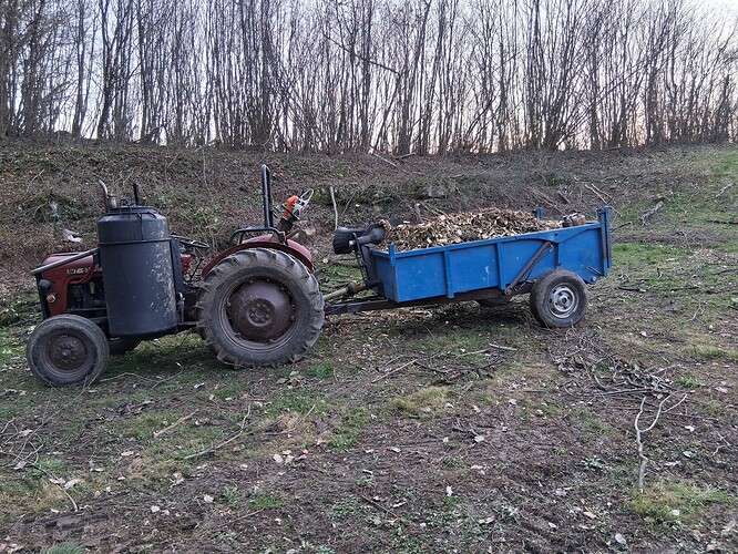

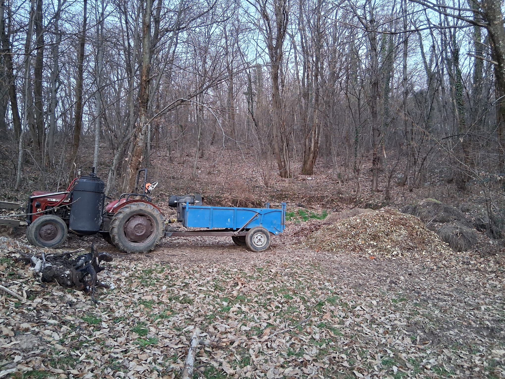

I took some pictures from this afternoon, … cleaning overgrown areas, … this equipment makes the job a lot easier.
What? Did you drop the fuel on the ground?
JO, I don’t have any more space under the roof, so I’m storing lower quality fuel here, I’m sorry, but there are surpluses, there’s already about 10 m3 here,… ![]()
