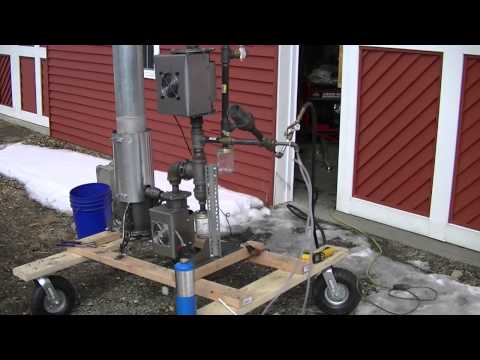

In case you folks missed my latest exploit…here is my new Gas Station Light:
It’s meant to be a lower cost gas system for powering 8hp 4kW generators. Hopefully I will have it out today and video a run report.
And here is the report:

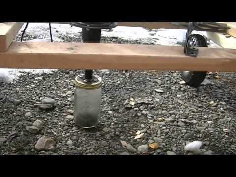

Hi Wood Gassers,
This is a quick video for the new folks. It shows how much dirt my cyclone takes out of a gas stream and why I am going to hot cycloning. My old philosophy of “cool and splat” to remove tar from a gas stream works, but it requires more maintenance than I would like to see.
Hopefully this will improve my time between cleanings.
Playing the video full screen makes the debris much clearer.
Stephen

I just had my first engine run of 2015. I ran the 8hp chipper/chunker on the Gas Station Light.
It ran SWEET!!! The condensate coming out of the final filter was clear. Earlier stages were dark but I think that was because it was washing off my earlier sin of grabbing an unscreened bucket of fuel. I need to fire my operator!!
The final gas temperature was barely perceptibly warm…maybe 105F and there wasn’t even a cooler baffle installed.
All the moisture in the hose was clear.
I tried to run my 4kW but it just wanted no part of it. I have no idea why. I replaced the coil and plug but still nothing. Every other generator I have has run fine on wood. ??? Probably time for a run to Harbor Freight for a sacrificial 4kW. I have three little space heaters on the way so I can start load testing. Pete S made a good point that running an engine is fine, but achieving a task is why we are here.
Last item…I had been seeing some fuel hang ups for some reason but as soon as I connected an engine, the gas pulsing seemed to make the problem go away.
