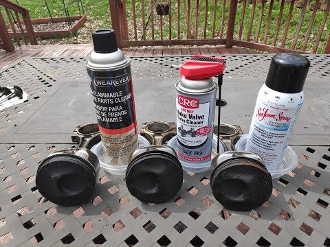

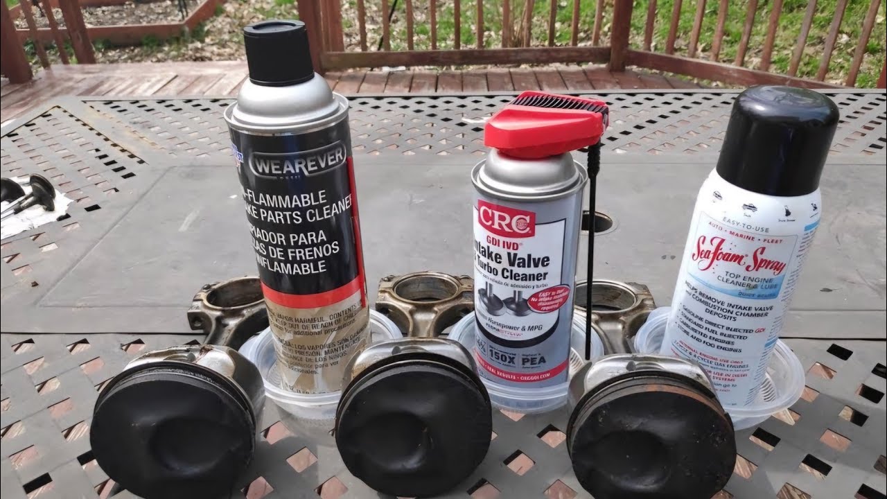

Watching videos on YouTube and I saw this guy trying to de-carbon pistons
Brake cleaner is absolutely not something you ever want to spray into an engine.
The solvent will soften things and I have seen just a little brake cleaner in a carb ruin a set of reeds in a sled and destroy the engine…
That said I do some horrifying things myself for reasons of expediency
( like spray methy cloride based paint stripper into spark plug holes to decarbon )
Ya works but you should not do this, take the engine a part…
If you tar up an engine and you know you did it before you shut down the CRC will actualy help you get that out.
You know you tarred it…
The filters plugged on you and you saw it.
So before it cools get some of that Intake cleaner in there soak it.
Start spray run…
Keep it up untill its clean then oil the hell out of the top end with some 2 stroke oil before you let it cool and your much less likely to need to strip it down.
If you have the option to run on gasoline by all means do that to wash out your engine too…
That’s probably the easiest thing.
But don’t run an engine on anything like brake clean that says non flammable…
It makes acid when it is forced to burn
I do like the CRC…
