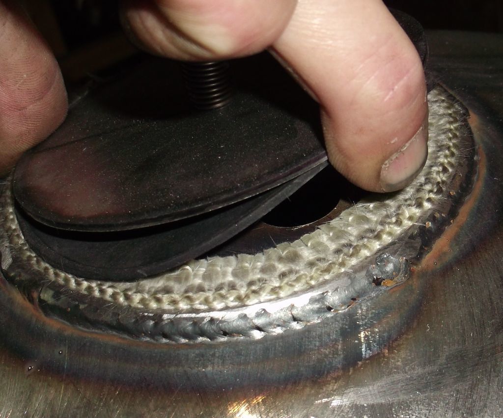

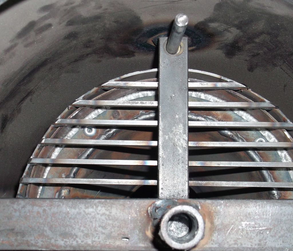

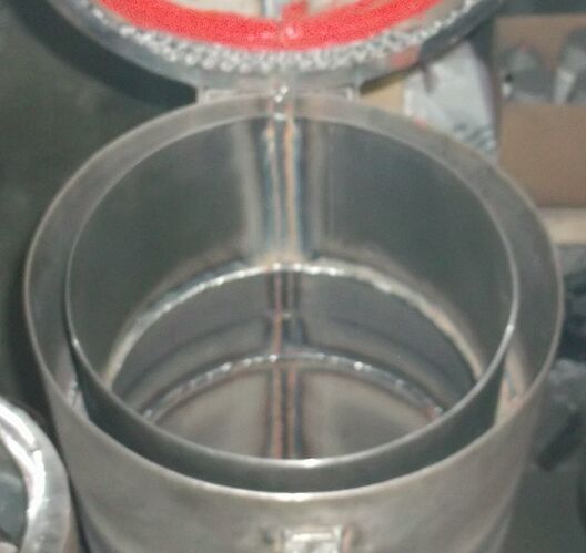

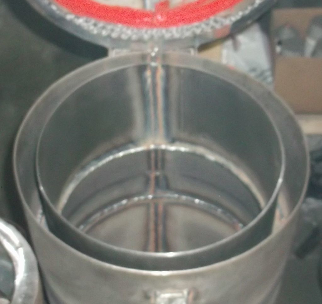

Ive gone through and completely redesigned our M-Series I gasifier. We’ve made many improvements to this machine, it has grown an inch bigger, the reduction bell is now riveted in, the standard hopper has almost doubled in size, and the condensate troft has grown a bit too.
So I now have question, before our condensate troft was built into our lids and now since the lid is redesigned I had to move it into the hopper. Any suggestions for keeping debris from getting in it when refilling the hopper?
See pic bellow

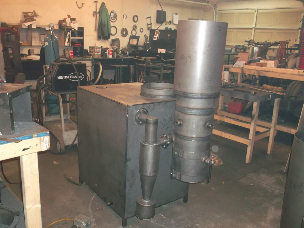

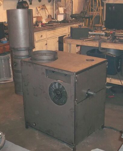

Hi Tom,

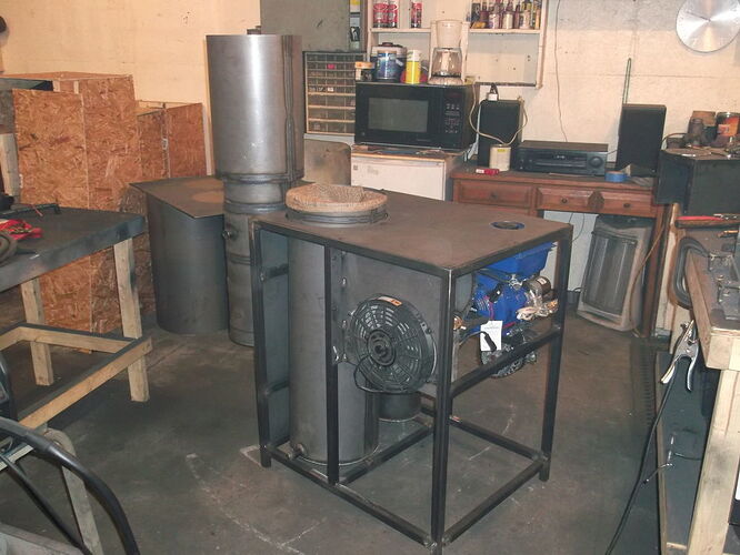

This is the proto type 2 kW unit we are working on. They only going to get bigger from here and the larger versions will feature CHP Systems.
Would one of them run 14hp motor for generator? And How much are they?
Hi Tom,
This system comes with the engine. We are trying to get away from off the shelf generators, they simply are not designed to run on wood gas. They are designed to run on gasoline or what ever the manufacture has designed them to run on. This system we are working on is a 2 kW DC system and we are using a power inverter to convert to AC. The system has an on board battery bank. We should have the machine ready for testing in the next few weeks.
We will then start a larger version of this machine that will generate 5 kW DC. It will just be a scaled up version of the 2kW proto we are working on. Then we are going to get into larger CHP systems using liquid cooled kohler engine and also GM Vortec industrial natural gas engines. We are currently working with some investors to obtain the funding to create and develop these larger machines. They will range in size from 10 kW all the way up to 150kW units.

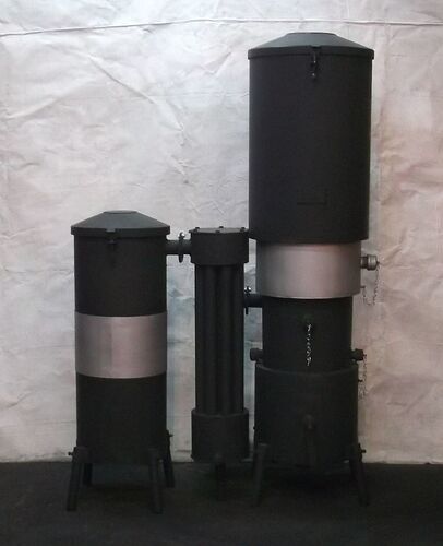

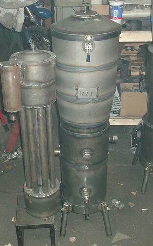

The last photo is our ES-II gasifier with integrated heat recirculation. This is the machine we are planning on using for the 5kW system. We can build you just the gasifier too. Just let us know what you want to run and well build it for you.

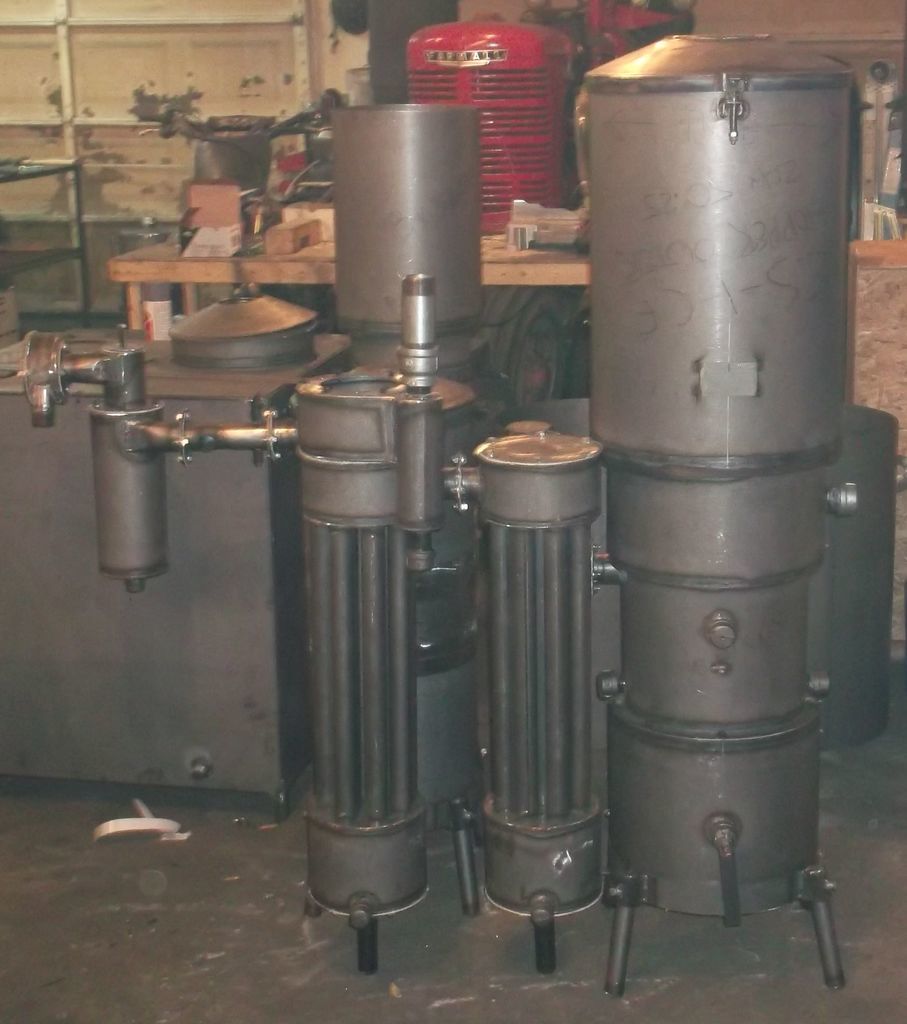

Well I do have quite a few AC generation woodgas fueled hours on five different AC package gen-sets. Real PITA for all of the reasons MattR and MattG have listed out. I finally voted for variable speed, variable load DC genration - battery surge load storge - inverter/converter load supping with MY pocket book moneys.
Picures are of my 2.5 kW Trace inverter (+90% efficient) and five commercial Redi-Line rotory converters 500 and 1600 watt. These are “only” 70% efficent. The “waste” heats off of these, as all my system waste heats, to be used to pre-condition the winter wet picked up fuel woods.
