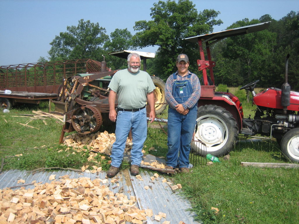

The Densmore’s from Lakewood NY. Visited this morning. I took him for a ride in the V-10 and showed the wood chunkier at work.
They will be on the site soon.
hi wayne
i saw the vidieo of your chunker it looks like it really works well
did you lock the spider gears or the brake on the other side
thanks
Tom
Hello Thomas ,
I welded the spider gears.
The chunker cut wood a little faster than I was willing to work when I had the other brake locked .
Hi Wayne
Thanks i thought it would be really fast and it didn’t look that fast in the video
