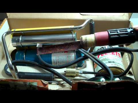

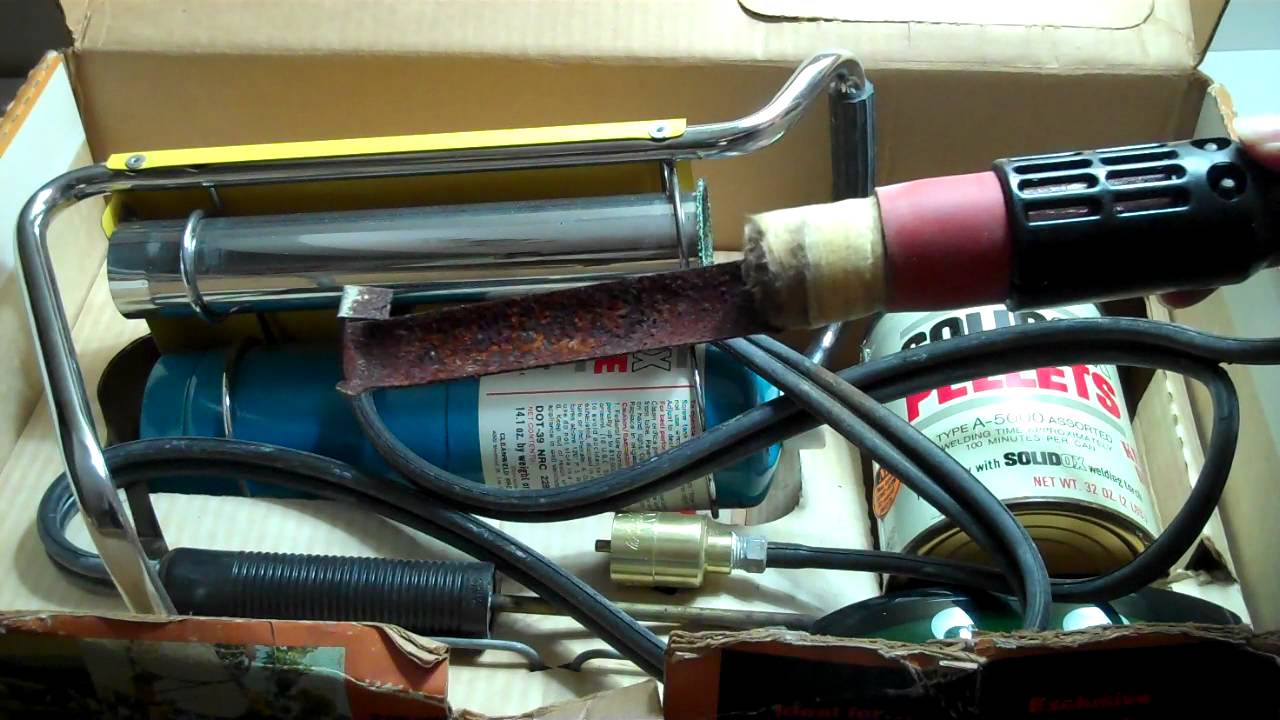

When I was a kid my grandfather had one of these torch sets.
But you can not buy them anymore because the oxidizer is dangerous.
Way back in the day he had an acetylene generator in his garage that you filled with carbide pellets ( that way he only had to rent the oxygen bottles.
I also understand this is dangerous as hell too…
I kind of wish I could have the propane and peroxide pellets, but I think I would pass on the gas generator.
Wallace,
I had one of those Solid-Ox welder outfits, just like the one in the video. Don’t get too nostalgic for one. I could do some brazing with it, trying to fix my Swiss-cheese-rusted 1968 Mustang. You had to get everything ready before hand, light the oxygen pellets, wait for the gas pressure to stabilize, then you had a few minutes to braze before it went out. It never really got hot enough to weld with. I tried every cheap welding device made, because I was a young man with big ideas and no funds.
I have a regular Oxy-Acetylene outfit now.

John, it works best for cutting. I didn’t have much luck welding with it. Might depend how fussy your are.
