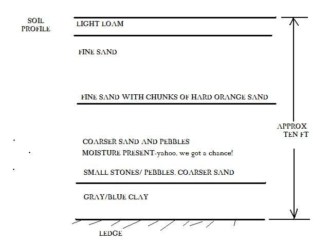

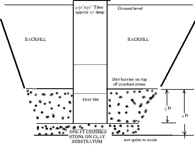

I lucked out, I had water seeping out of the ground on my hillside. If it’s coming out there, it’s in the ground for sure. So I hired a backhoe (long boom thankfully) and started digging. See photos for soil profile which I found at the county extension service. Check for your area, it could be a big help. We ran into wet soil down about 7 feet. Whoopee! We dug down to blue clay and stopped. That was at 10 feet and right on, profile wise! Yah, we had a huge hole in that sandy soil. We laid down a foot of crushed stone in a 10’ diam circle and set the first tile plumb and level and added a second tile. We then added another 3 feet of crushed stone for a total of 4 feet, then backfilled the hole and waited. The next day there was 4 1/2’ of water in the well. It was cloudy from the crushed stone. We pumped an hour and a half down to the top of the foot valve, about 900 gallons by my pump info. It filled again overnight and we pumped again. Two days and the water was clear. I figure I have 1000 gals available in a 24 hour period. Way happy! That was 40 years ago and we’re going strong. Level only fluctuates a couple of inches per year. There is a foot valve and a 1 1/2" line to the pump in the house, about 100 feet.
Water is crystal clear and has absolutely no odor or after taste. We’re blessed.

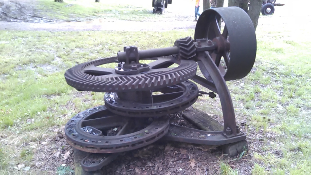

Here’s a picture of one of the jerker heads at Coolspring Power Museum…
Jeff
Hey JeffD I like this mechanism. Never in my life have I seen chevron cut gears. Like chevron tread patteren truck/tractor tires this cancels out gearshaft end thrusting.
