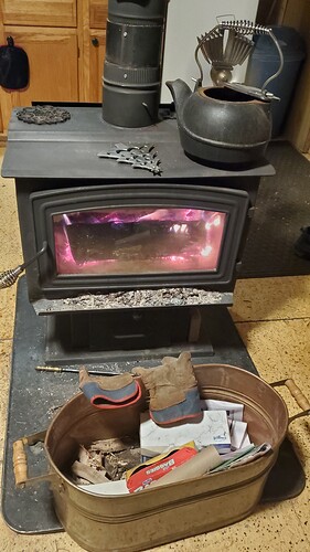

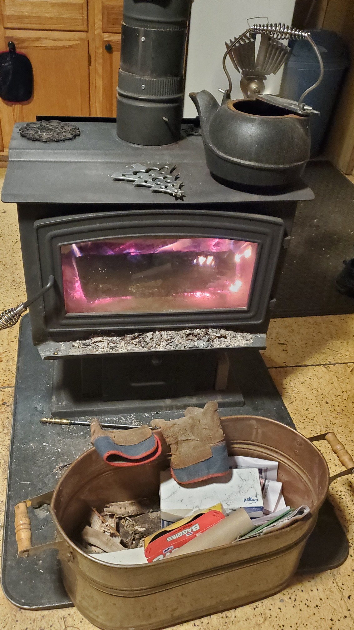

I love wood heat. In the summer, I can’t wait to light up the wood stove.
Last year we went through 3 cord of birch from September to June. When it’s chilly at night but up to 60 during the day, I light the stove once in the morning to keep the coffee warm. The toughest time is when it’s 30-40 day and night. I may have to light the stove 2-3 times throughout the day. Today the high was 10F. Once I have a bed of coals, one log every 3-4 hours keeps the house at 80F. When it’s-30 to-40, as soon as there’s room in the stove, we stuff a log in there.
This year we’re burning maple. I have birch left over from last year to start the fire and maple all day and night.

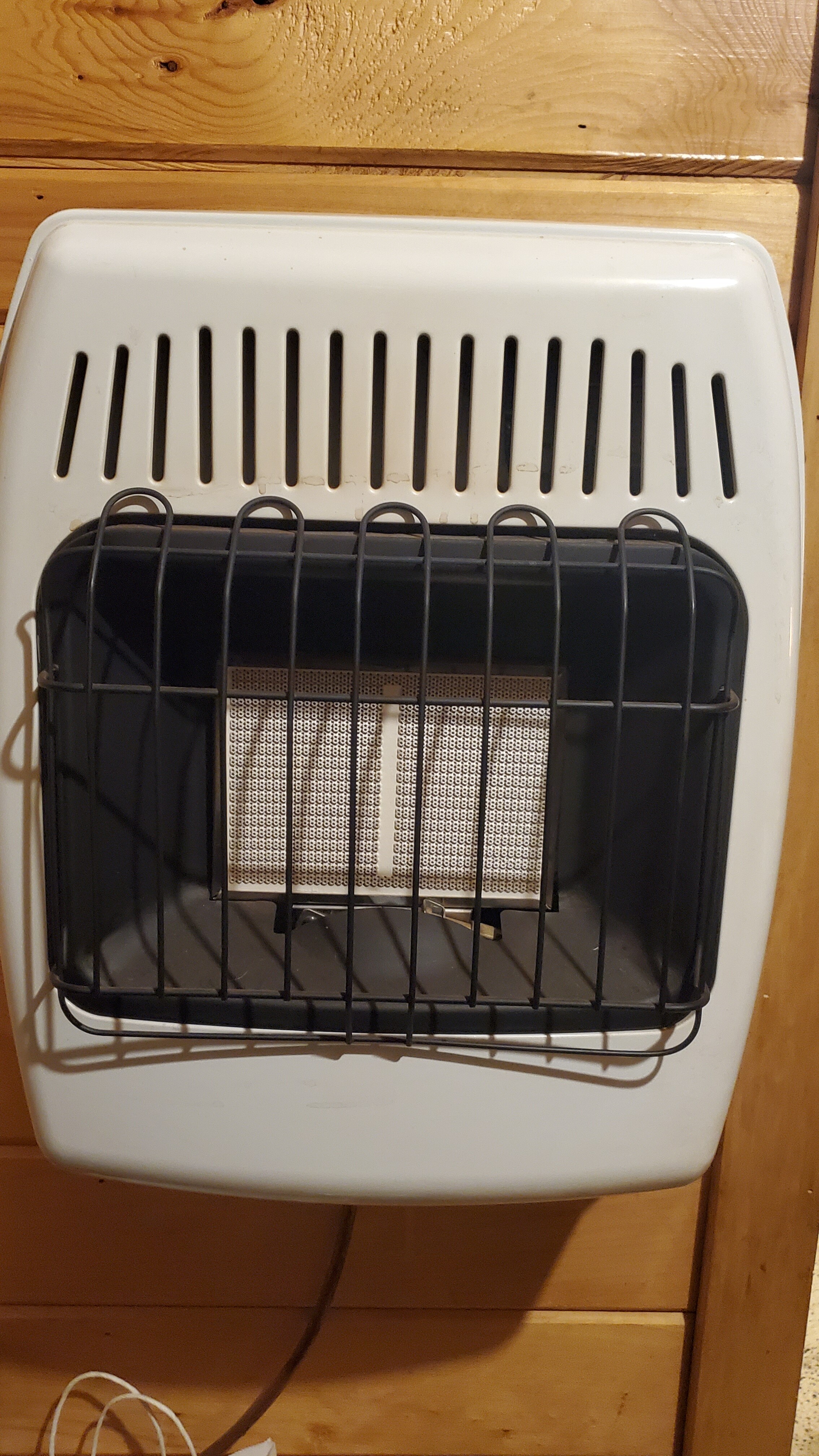

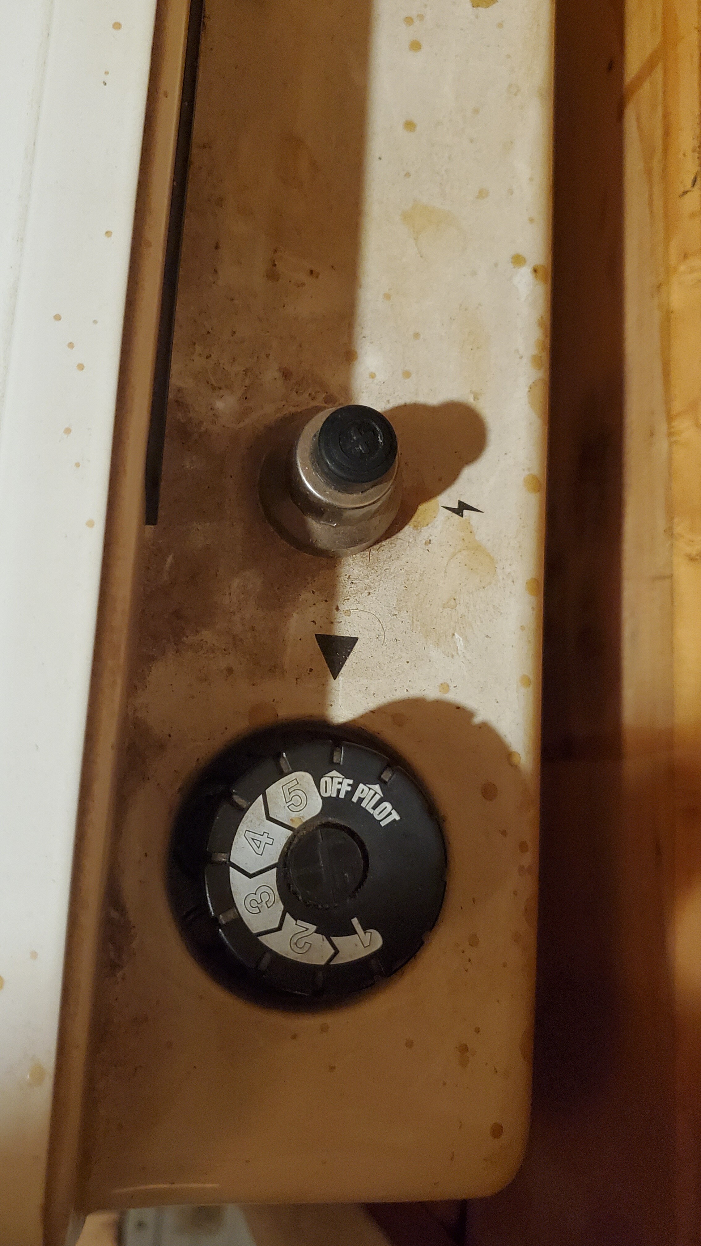

I will jam as much wood as I can in the stove before I go to bed. I usually only sleep 6 hours. The house temp will drop down to 45-50 in the morning. What I did was install a fish house heater and keep it on medium just before bed. Yes, we have a CO detector so I sleep well. Then I can wake up to 70F in the morning and have some time to get the fire going again. Of course I heat up yesterday’s coffee first before anything else.
Describe the fish house heater…what fuel? vented? Electric start?
