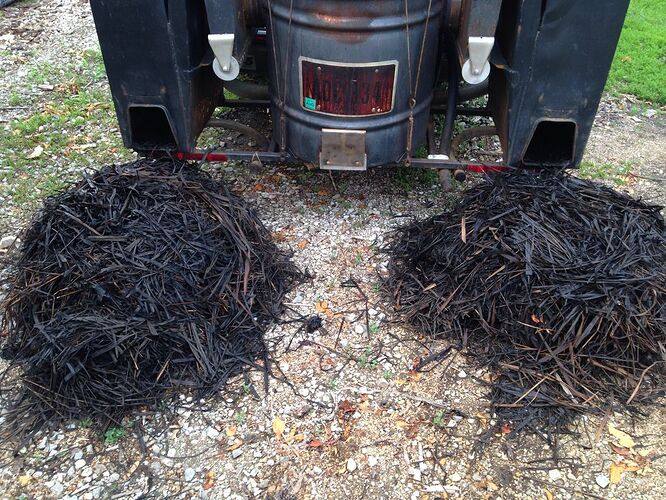

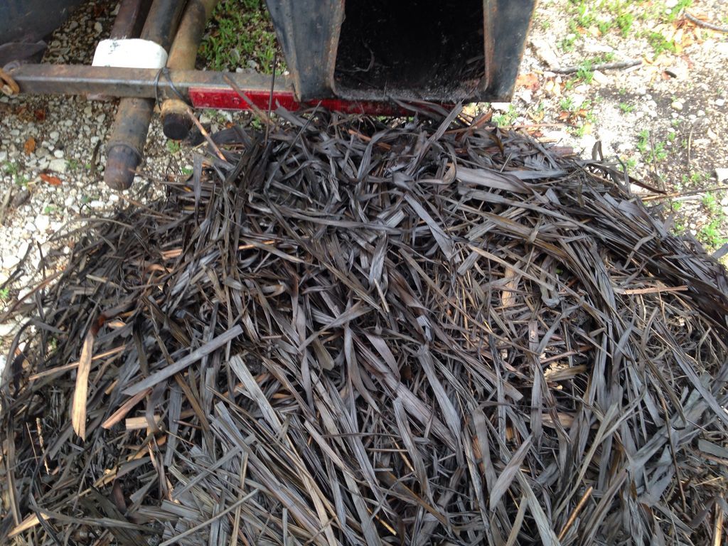

I decided it was time to change hay today, it’s has about 3000m on it.
Is this about what the rest of you are finding as far as “looks” of your hay after about that many miles? Do you run yours more or less than that before changing? What you see on top came off the top, I pull it out from the bottom, it was a lot more dirty at the bottom of filter!!! Just wondering how mine compares.
Hi Herb,
That’s pretty much what mine looked like, too. I changed it yearly, I didn’t have as many miles on it, maybe half. The gas would enter the center of the hay so I didn’t see a gradient of dirtiness.
Rick

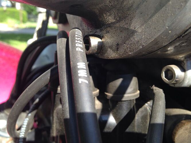

I’m wondering if some of you electronic experts could help me with identifying and locating parts to put electronic ignition on my Model A.
I don’t have room for a distributor, the one you see in pic I cut down where ever I could to get it under 4&1/2" tall from dist hole in block to blower drive.
I even cut off ign plugs on dis cap and ran wires out the back side.
It works but I would really like to go with late model electronic ignition, would really appreciate some good guidance on this, I will do any fab, mounting, wiring necessary. Thanks, Herb

Thanks for the pics, mine must be the DuraSpark 1, it has a one piece cap, bought it new and cut it down to fit many years ago, I think it’s for a 75 351C but I think all Ford dist are the same anyway, it has worked pretty good for a long time but is moisture sentitive, may pop back on wet morning. I’ve been through the caps that exit the side, just not enough room height wise.
I think I will have to go the distrubutorless route, I only have 4&1/2" from dist hole in block to bottom of Blower Drive. I know I need a crank trigger set up, the right kind of brain and does that mean 8 individual coils?

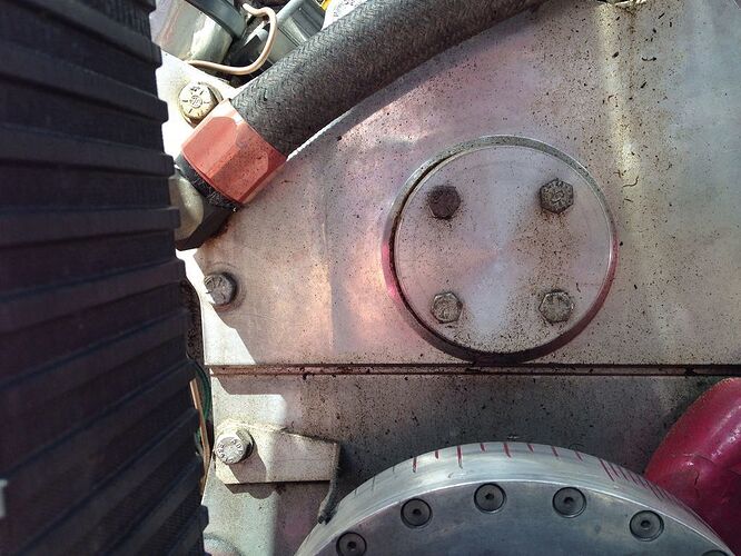

I do have an option with this engine that may be the way to go. I used a custom front cover (timing chain) that has access hole to camshaft sprocket. I don’t know what it was designed for but why not drive distributor from that. I would have to find or make a way to drive oil pump but then I could use any 8 cly dist, what do you think? What dist would you recommend? I will do the dist drive/ mounting chores! Thanks, really appreciate your expertise!
