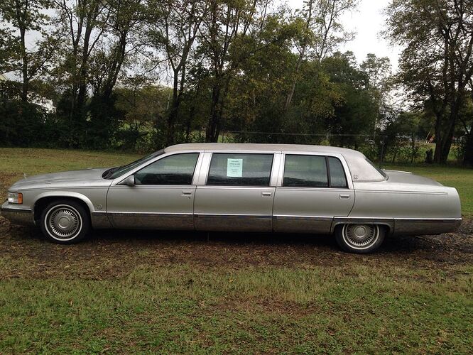

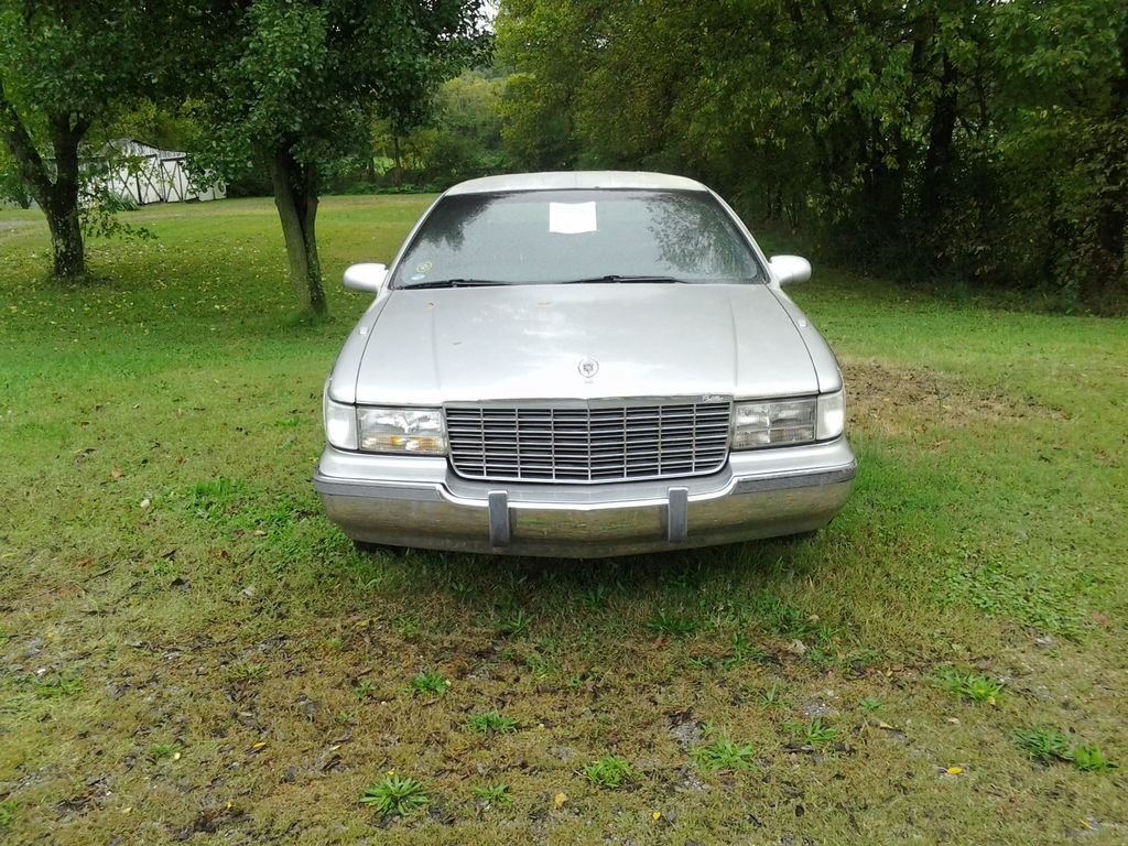

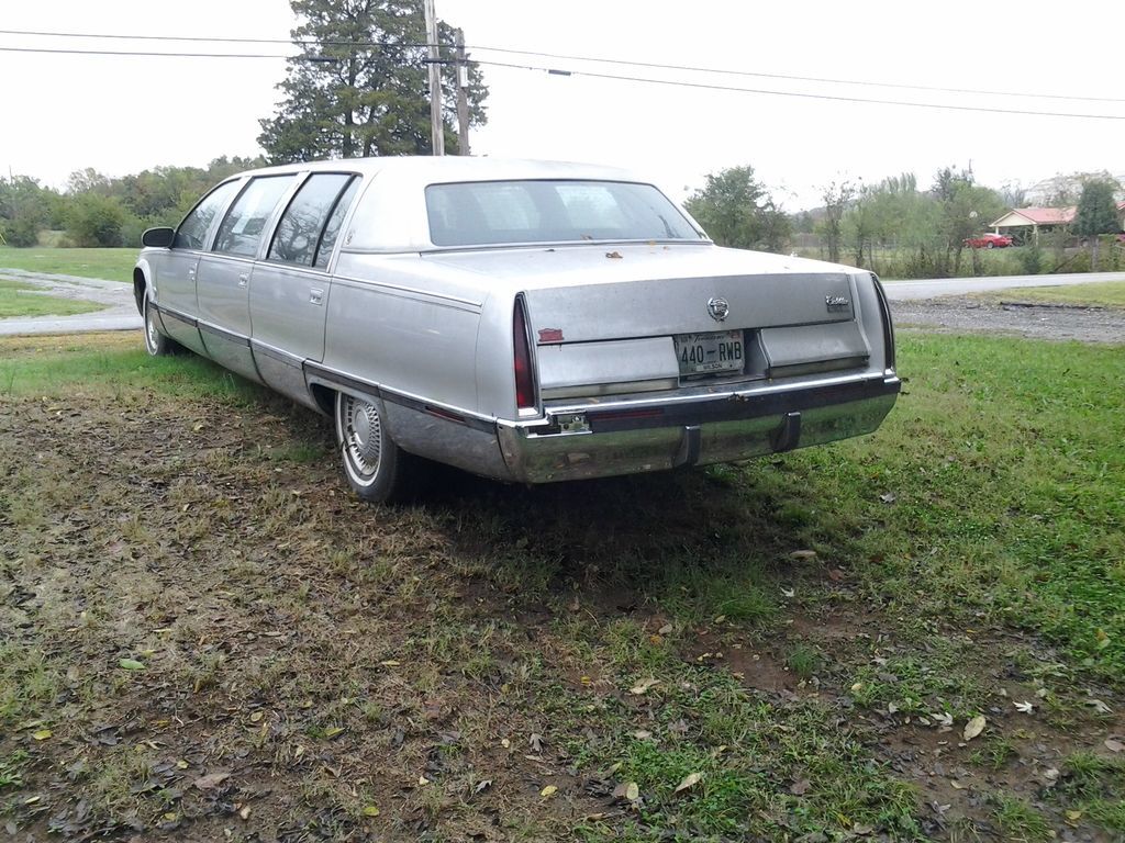

I have a few more pictures If you want them but this car is in between Lebanon and Watertown. Shows some age, 2012 plates and I think it’s been sitting there about that long at least. Should be ready to deal.

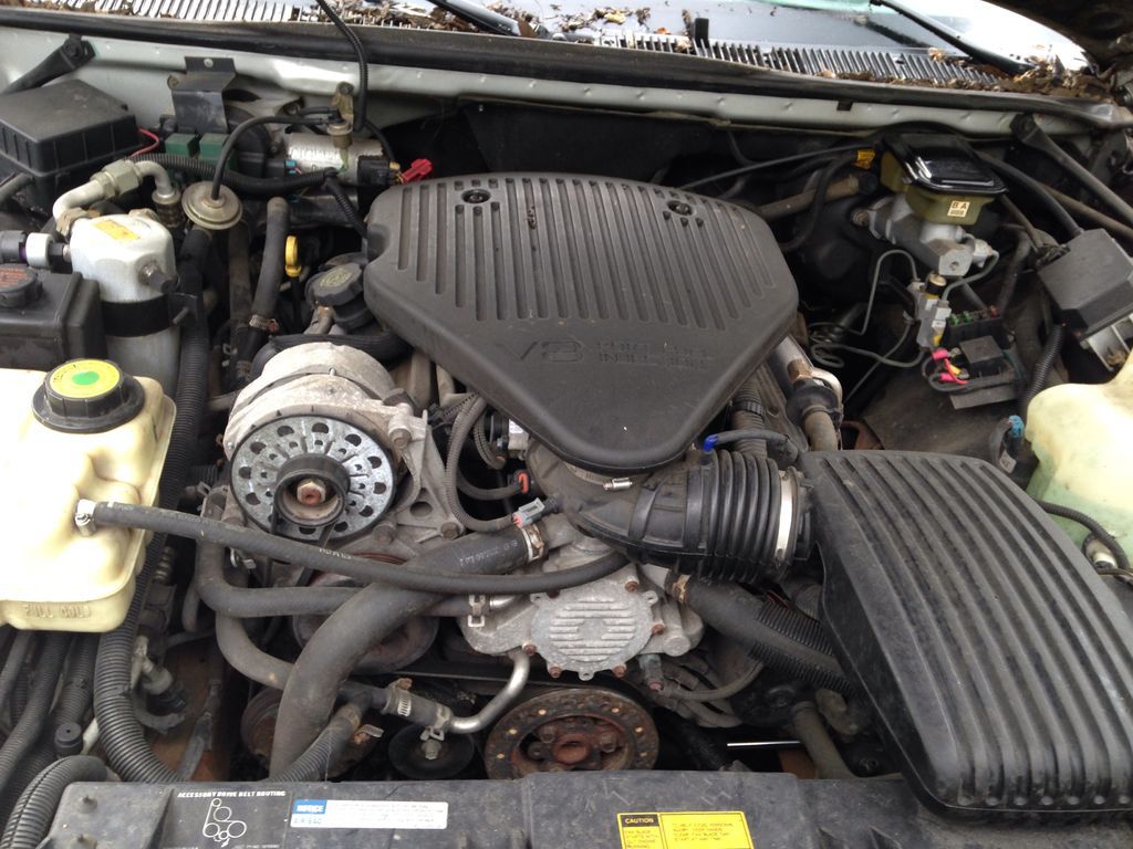

A wood powered Cadiliac limo may be back on the table, I drove out and took a look at it, it’s a nice car, it’s dent free, the biggest problem is the vinyl top has hundreds of small cracks in it, looks like something could be spayed over it. It’s a 95 full sized Fleetwood rear wheel drive, it’s got the LT1 engine, it started a ran real nice. Since it’s rear wheel drive it has a lot more room around engine, 79,000 miles. Asking 3,000$ could be brought for 2500.

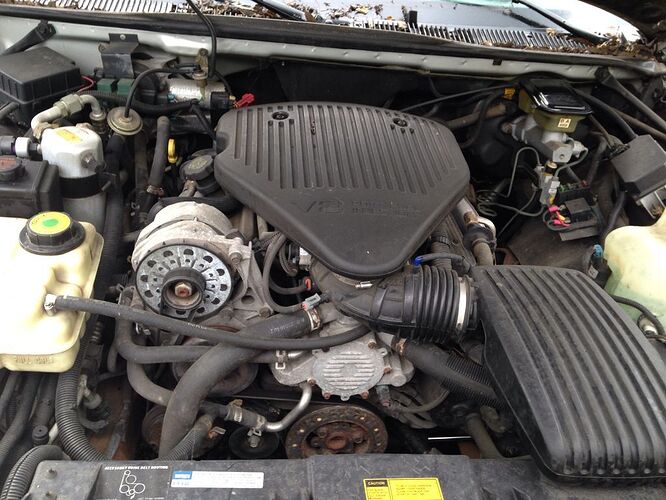

Would like groups input on woodgasin one of these, I forgot to check if it has a distributor?
The distributor is under the water pump on these engines. (Whatever engineer came up with that should be shot).
http://www.bing.com/images/search?q=optispark&FORM=HDRSC2
With some custom machine work a distributor can be put in the back for the high side of the ignition and leave the optical sensor up front. http://www.impalassforum.com/vBulletin/showthread.php?t=255050
Can be converted to coil pack. http://www.delteq.com/
Can be converted to individual coils. Bailey LTCC setup
Or it may not be a problem as is but at least you have options. May have to get creative if timing needs adjusted with the computer.

Is that a Distributor tucked in behind the Serpentine belt (“1 o’clock” angle from the main crank pulley)? Underneath/behind the central “cast aluminum- looking thing”? That sounds about like what MarvinW described.
I can see what look like plug wires behind water pump.

Yes, its driven off the front of the cam.
