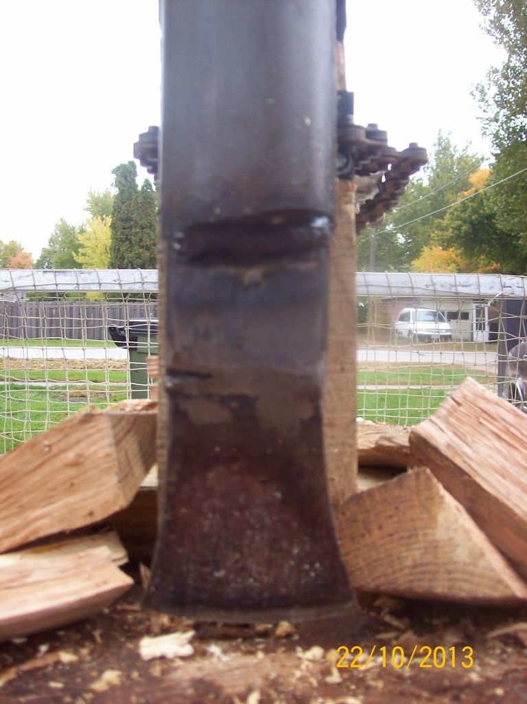

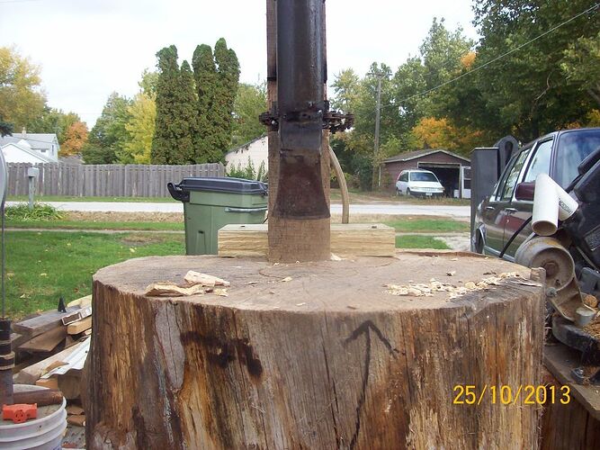

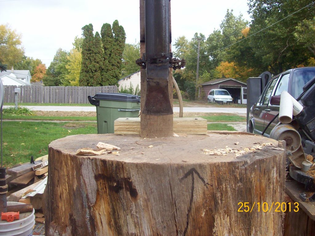

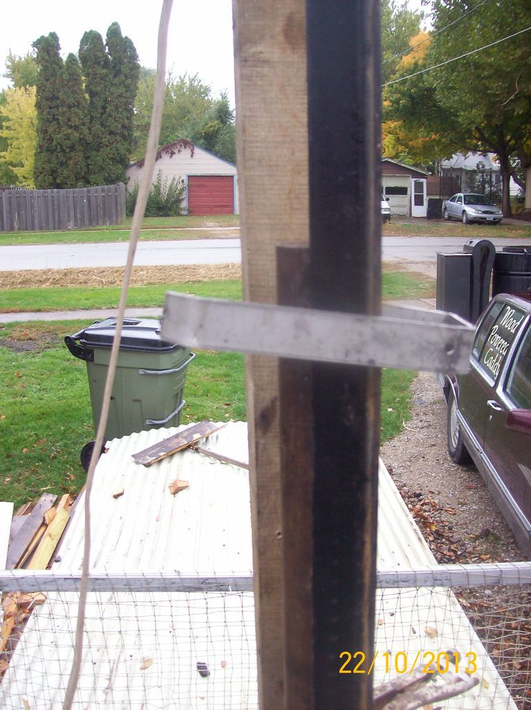

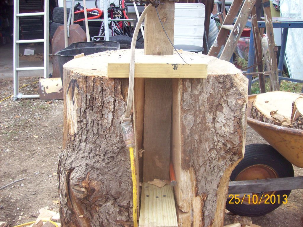

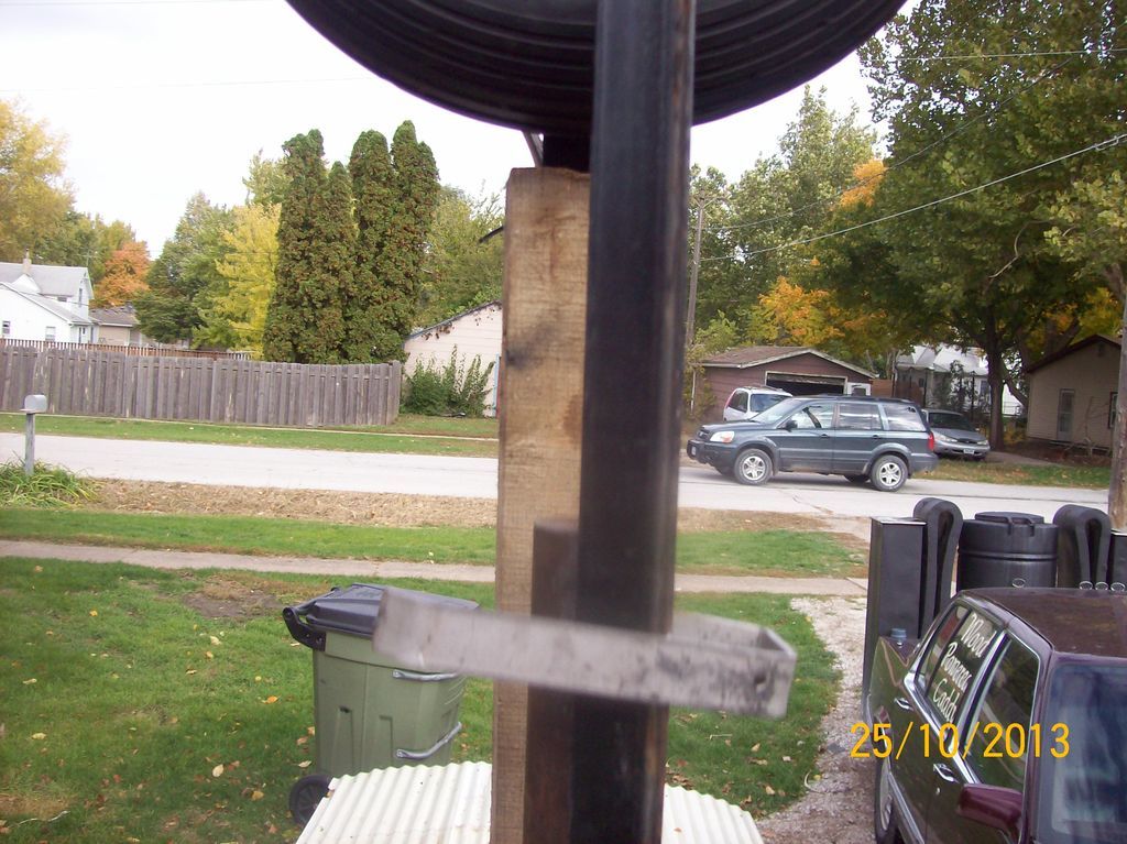

Thanks everyone. You know what they say " Necessity is the mother of invention".I ran it today for a while and I must say I have never had fun splitting wood before but today I did. I wanted to keep going but a friend is coming over tomorrow to video it working and I’m about out of ā€œcookiesā€ until I get more logs. So hopefully I will have a video up here tomorrow if we are smart enough to get it posted, I’ve never done that before. Glad you all liked it, I will get some better pics in case anyone would like to make one. It didn’t cost me a dime, it all came out of my ā€œjunkā€, I think I worked on it for about 4 days but there was a lot of head scratching involved, you could put one together in half that. Herb
Took a few more pics while it was running.
  1. half hp elc maytag washing machine motor w/3/4 in flat drive pulley
  2. pin on wheel about to hit hook
  3. lift lever about to hit wheel center wing nut which kicks lever off pin making it trip and drop
    4.guide for lift lever to move back and forth, also small spring behind there to pull lever against center wing nut
  4. 3/4 in. bolt welded to 2" shaft where lift lever is hooked, also serves as stop for drop shaft
  5. axe part way up or maybe falling I don’t know
  6. back side of stump, showing slot I cut in there where 3x4 wood beam fastens "
