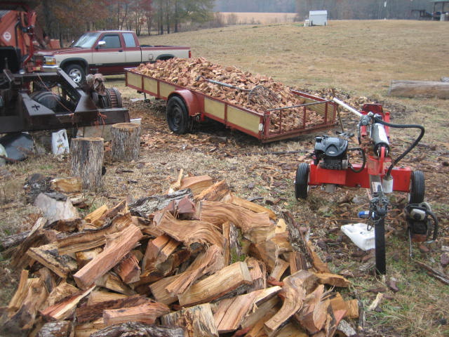

Just finished chunking a trailer load of wood ( first picture ) and second picture shows more wood in the shed drying .

Hi wayne happy chunking, just wondering deep you load the trailer and how long too dry, and can you tell much difference when chunking hard wood green VS hard wood dry.Looks like fun chunking wood, from here anyway.:blush:
Hello Kevin .
I spread the chunks on the trailer that is under the open shed about 6 inches deep and dry it to 20% or less .
It takes one or two weeks depending on the weather .
I don’t chunk dry wood . I have plenty of green or wet wood to pick from .
