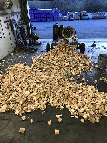

Ok, I gotta ask…do you like chunks better then billets? To burn? I have never had or used chunked wood.
I like the speed of chunking vs sawing, though I had less clogging problems on my sawed chunks
Your sawed chunks had no fractures and splintering in the wood. What I have found on the chunker to help with that is to chunk green wood. Dry wood cracks into smaller pieces. Your wet wood did it fracture like dry wood?
Some of it yes, this lumber was extremely old, some I salvaged from Aberdeen a few years back. True old growth Douglas fir, the finest of lumber from our state. I counted the rings on one of the 2x4 I chunked, I lost count at 90 something. On a stinking 2x4. To my knowledge there hadn’t been any production cutting of the giants since the 50’s in that area. The usual Doug fir I get from pallets at work might have 8-30 rings. It seems to fracture better then the tight ring monsters of the coast, which tended to shatter even when wet. It may just be that the lumber was so old I don’t really know

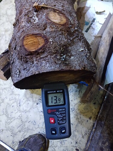

I finally decided to find out the moisture content of the various wood.
The spruce was down for 3 years, and the oak was down for 10 years.
Now I am going to be one of those old guys running around pricking my wood.

How is the new size that you have been chucking up working in your WK Gasifier Marcus? Or is the wood still drying.
Nice pile of chunks there.
Still running on the bigger chunks I had stored but it is doing much better, little better milage and less clogging. This run i chunked a bit smaller, but can’t go to small with large grain structure since the pieces will shatter instead of fracturing. Each piece depending on growth rings or dampness I take a chunk or 2 before I decide how big they will be but most are happy about 2" long and up to 2" diameter. If it’s much larger in diameter I actually have to lengthen the chunk out to 3 in or so otherwise it will split in 2 as it fractures. I think that is one reason Wayne’s chunker seems to work better than mine is his cutter is 3/16 thick and therefore puts less pressure on the wood as it’s being chunked whereas mine has a lot of force being quarter inch and a lot of my pieces are so fractured you can look through it like daylight all the way around almost like looking at a loose stack of firewood

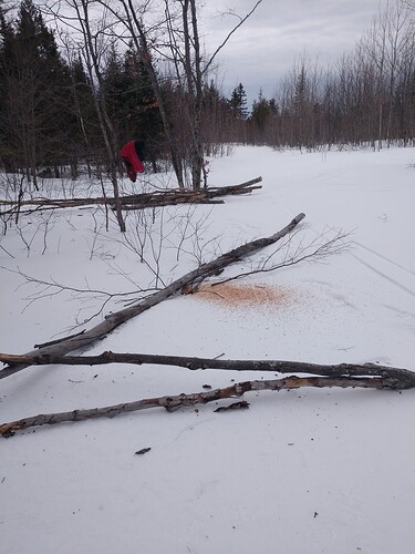

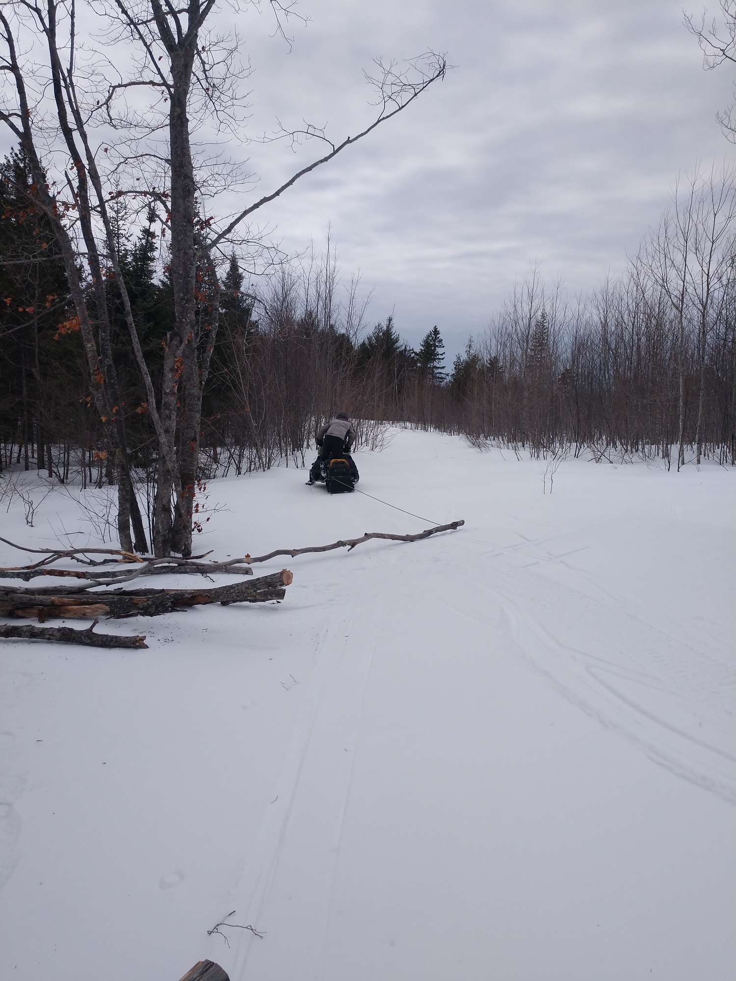

Too hot for a coat but warm enough for pants. We are towing in the good dry maple, for gas producer billets. We are working on an ice crust two feet thick.
The kid is enjoying running the snowmachine, and I am just grateful to be alive. If it makes a profit, that’s a bonus.
