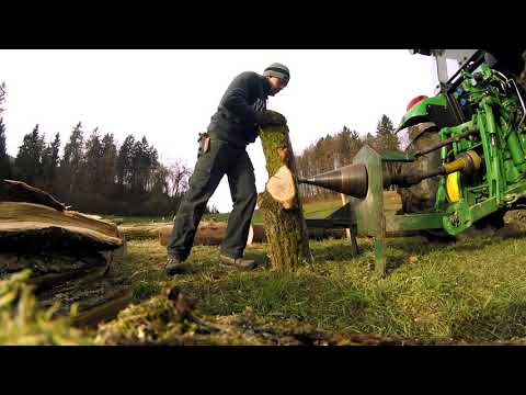

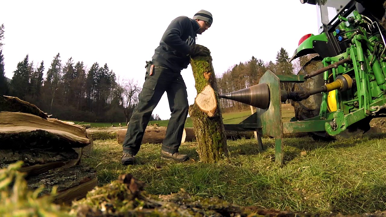

Yeah. You have to get very rural to avoid a visit from the Feds on this one. I think I’ll just stick with sawing cookies from stuff that can’t be split. Anybody ever used one of these? I thought about getting one that bolts to a tire wheel once but decided it would probably end up beating me to death.
https://www.google.com/search?client=firefox-b-1-d&q=spiral+wood+splitter#fpstate=ive&vld=cid:31c9fff1,vid:19-d4OayY2M,st:0
Hi Tom, the link didn’t work for me, but i guess it’s the conical screw type? Please avoid them, i think it’s the best way to hurt yourself pretty bad, ofcourse there are types with a built-in splitting edge that makes it impossible for the wood piece to rotate. But imagine if the screw starts wind up your clothes, or skin :open_mouth:, im really concerned these are’nt banned everywhere, not even in Sweden, where “big brother” does all safety thinking for you.
Best way to use them i’ve seen is mounted on a small excavator, hydraulic powered.
I second what Göran said, they are dangerous no matter what anyone says.
You can easily crush your hand as well if the wood lifts a little from the table.
I have one at home but I will never use it and never sell or give it to anyone as I don’t want them to hurt themselves.

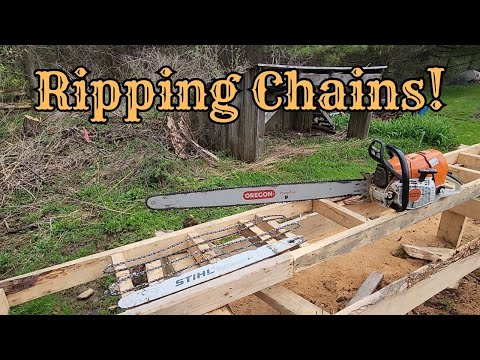

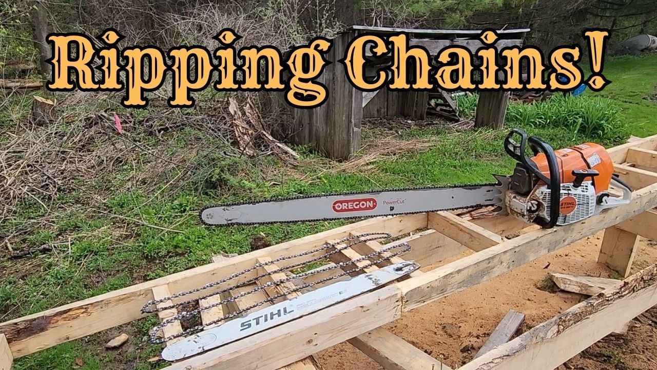

Link works for me, not sure why it didn’t for you but that’s what it was about. I avoided them a long time ago. Looked at a lot of videos to find one that compared ripping chains to crosscut chains without spending a half hour of useless blab. This one does.

Is this what you mean?
They are still somewhat popular here and l have split my share with one of these, but each time l did l imagined it drilling in my leg… side to side they are as fast as efficient as a hidraulic spliter, we tested. But man are they brutal… l have seen some crazy stuff happen…
That’s what I was talking about K. Maybe this video link will work.
I think they were banned here for a while or the company was sued out of business. People put them on car wheels, and then the car fell off the jack holding it up.. And loose clothes delimbed people or killed them much like the pto shaft without the safety covers on them.
