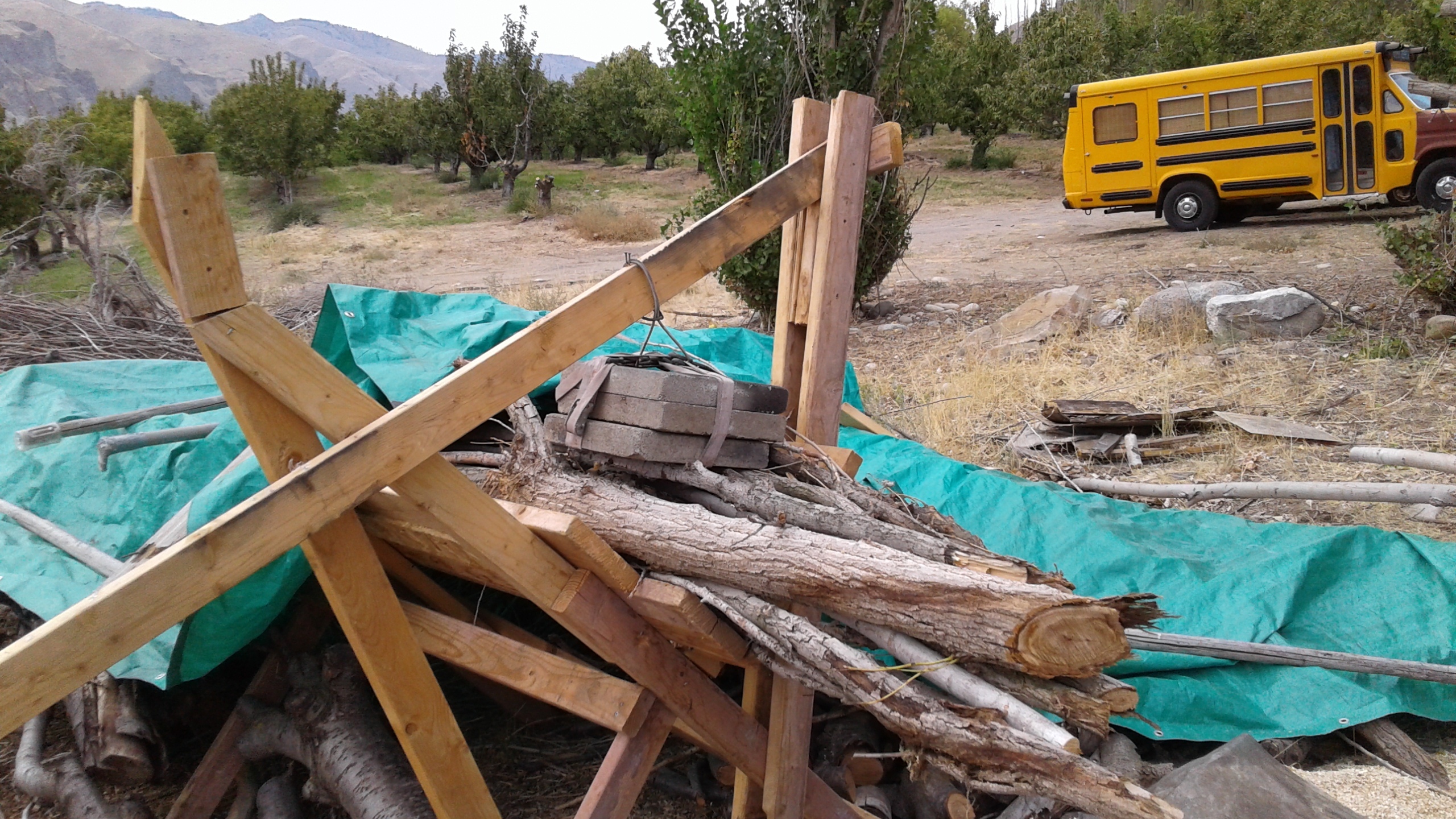

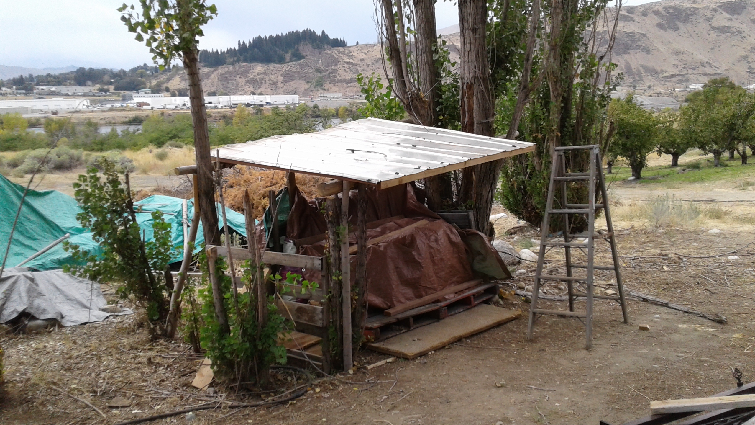

Where did you get the limbs to cut up. Looks like a lot of “brush” growing but not “trees”. It does look like a beautiful day. TomC
Hi Tom, in picture number 2 to the top right is 20 acres of cherry trees just down and around the corner is a huge pile of wood from 20 years of cut out trees and yearly pruning, they have never burned the pile. Also I have a friend that cut trees down for people, and he brings the big stuff over, that’s the wood on the left popular and white birch, on the right cherry wood. Just cut it up and it’s ready to go into the hopper.
Our area is orchard country cherry, apples, pears, and peaches. Wenatchee still calls it self the Apple Capital of the World. Well it use to be any ways. Now it is Cherries. You can also get a permit to cut fire wood. Western larch, Ponderosa Pine, Fir, Black Pine, Blue Spruce . Lots of fallen trees along the roads in the foot hills of the Wenatchee Mountains. Wood is not a problem to fine here, I just need to put enough up for winter.

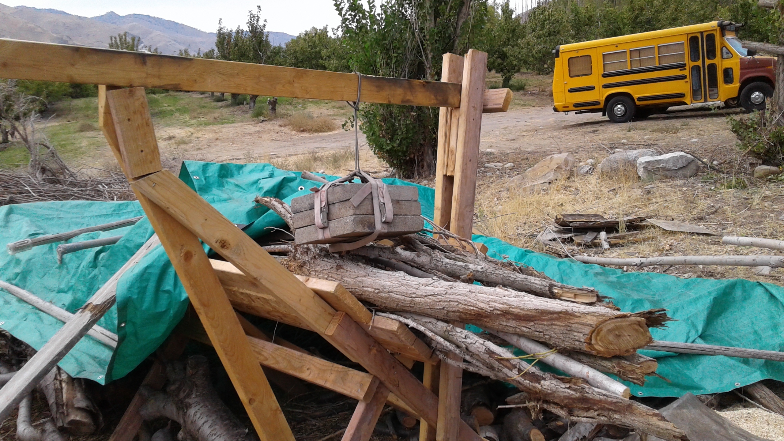

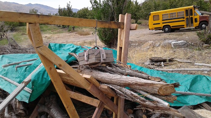

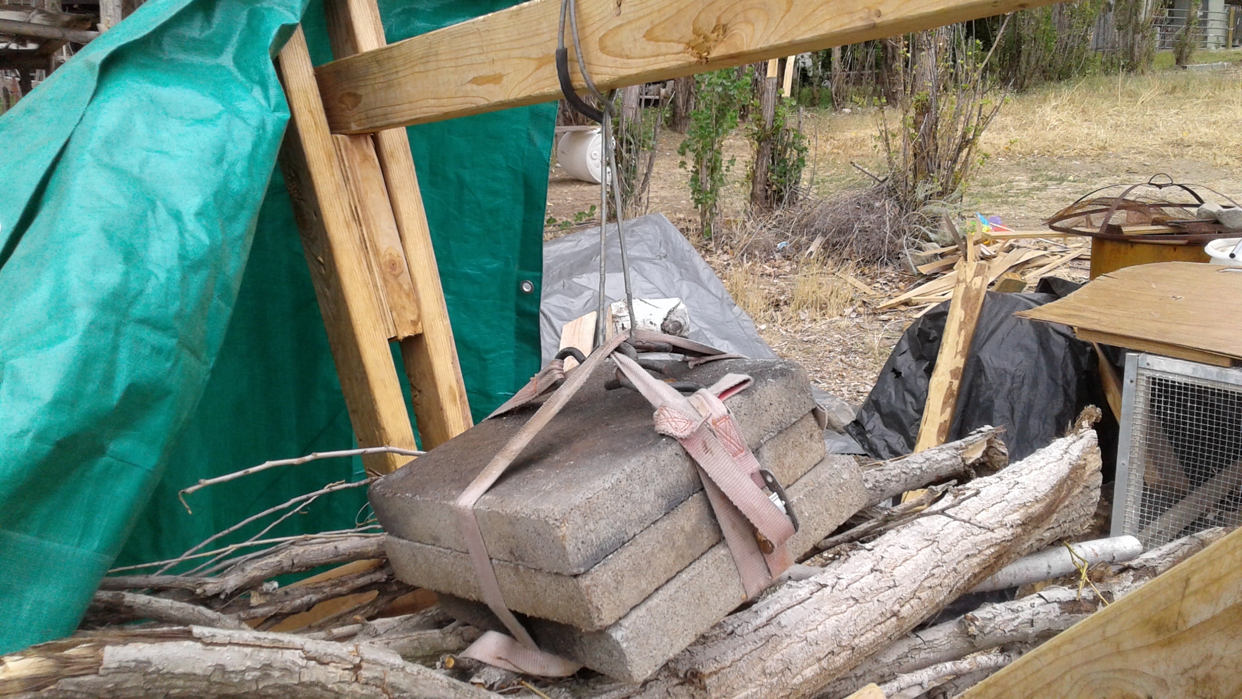

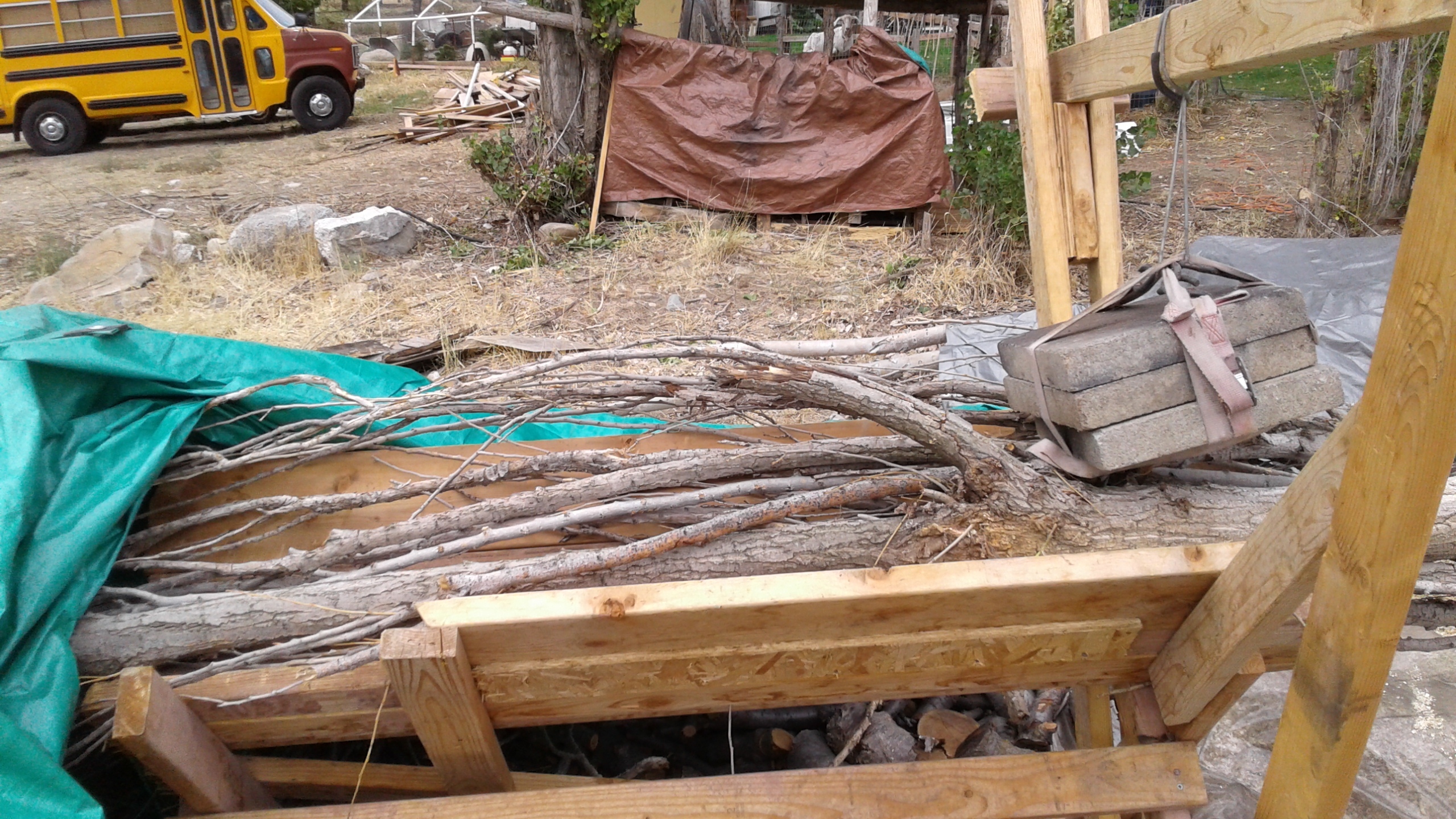

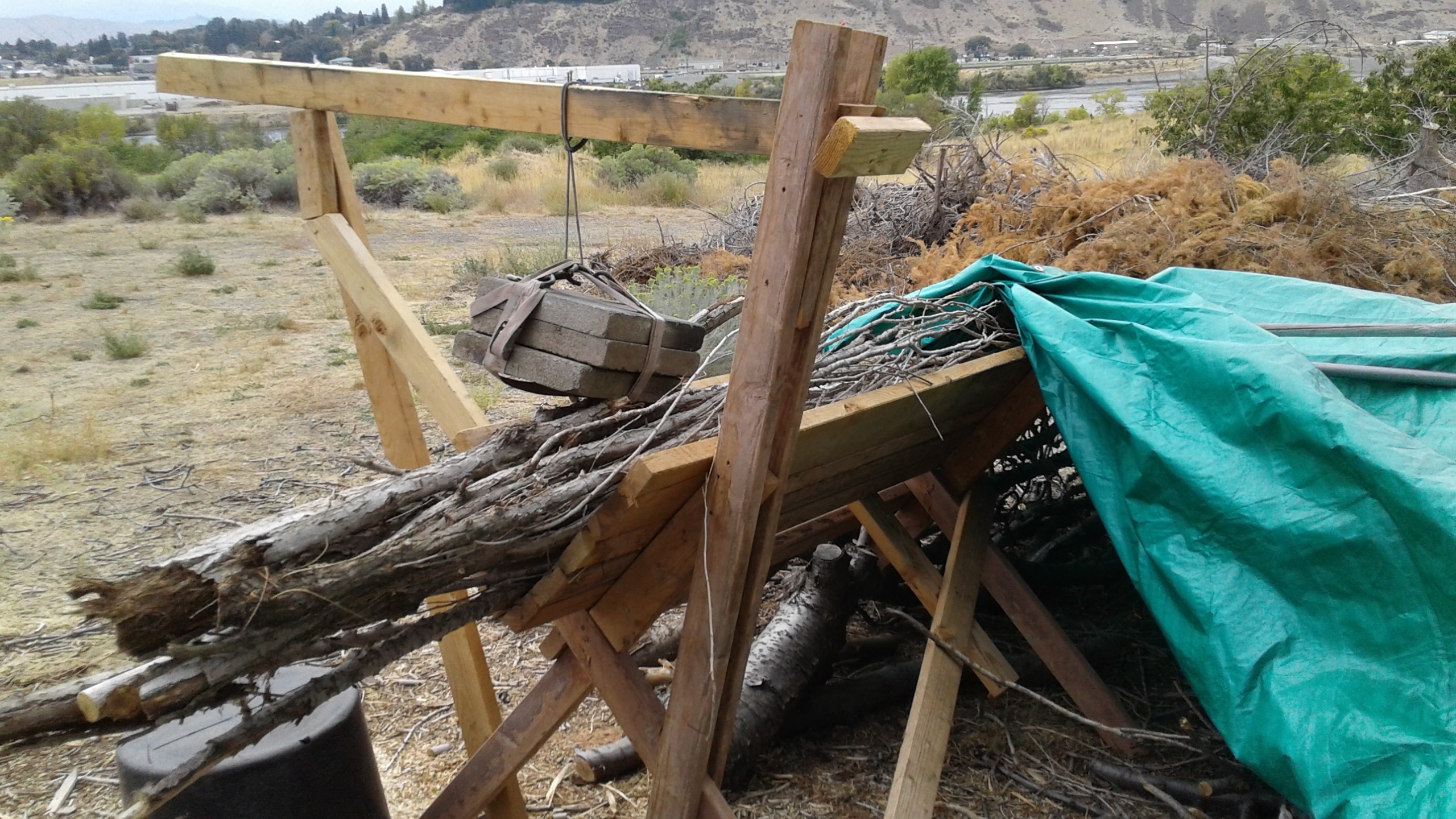

That wood holder thingy needs some more pictures
I did not give you enough time to demonstrate it
Does it ratchet down to hold a bundle while you cut?
Here are some pictures of my wood cradle. I can cut wood down to about 14" long, and then spit what is left. It has three concrete blocks strapped together with a cable hanging from the 2×4. Works great. I put a plastic garbage can under it to catch most of the wood being cut. Dump the cut wood onto my old rabbit pen the sawdust go though. Sort out the small pieces and put the into the funnel and down into my bag that is in a small barrow. The big pieces go to the splitting pile. Using a electric chain saw and keeping the chain sharp is the secret to cutting smooth and quickly.

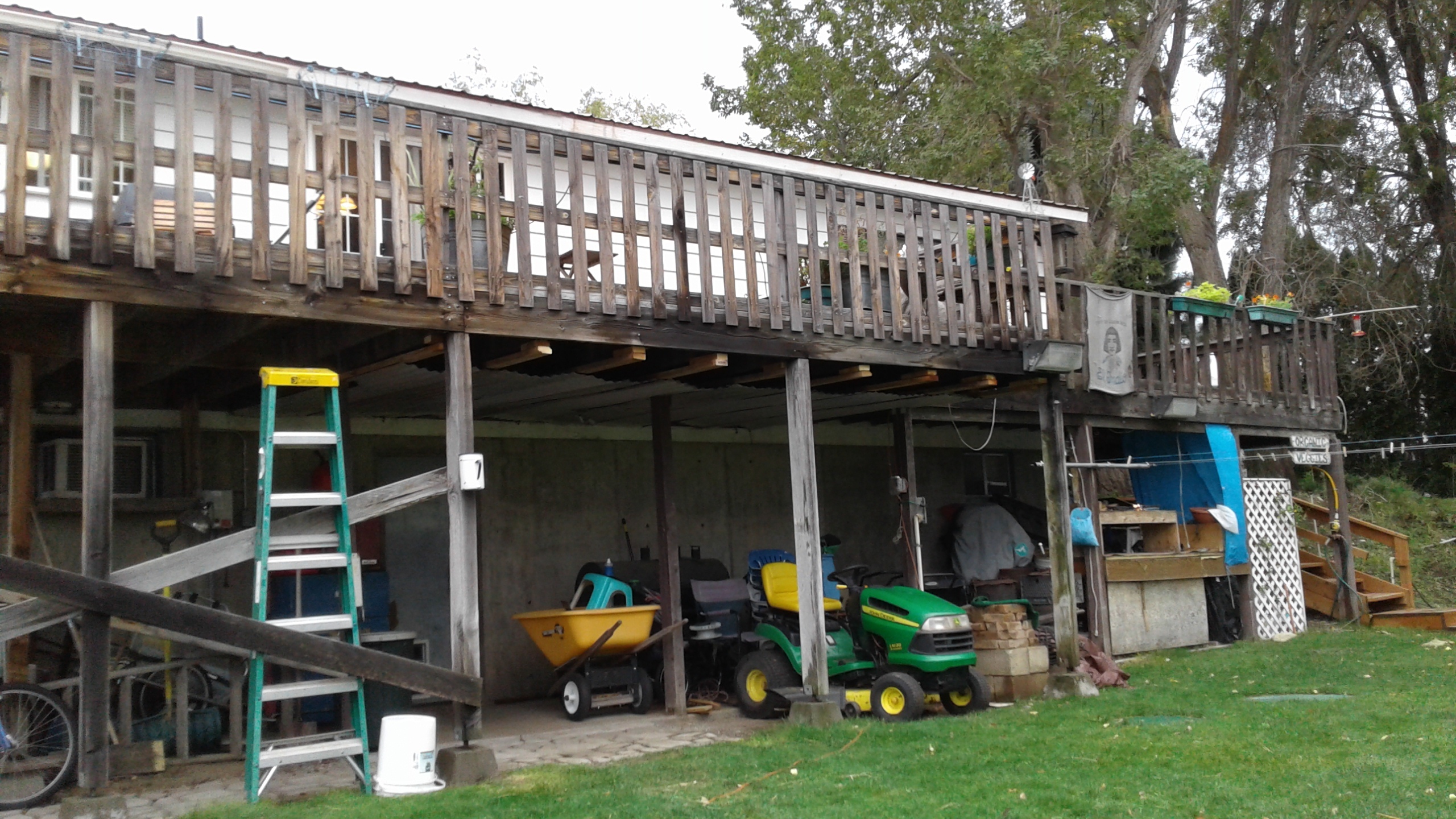

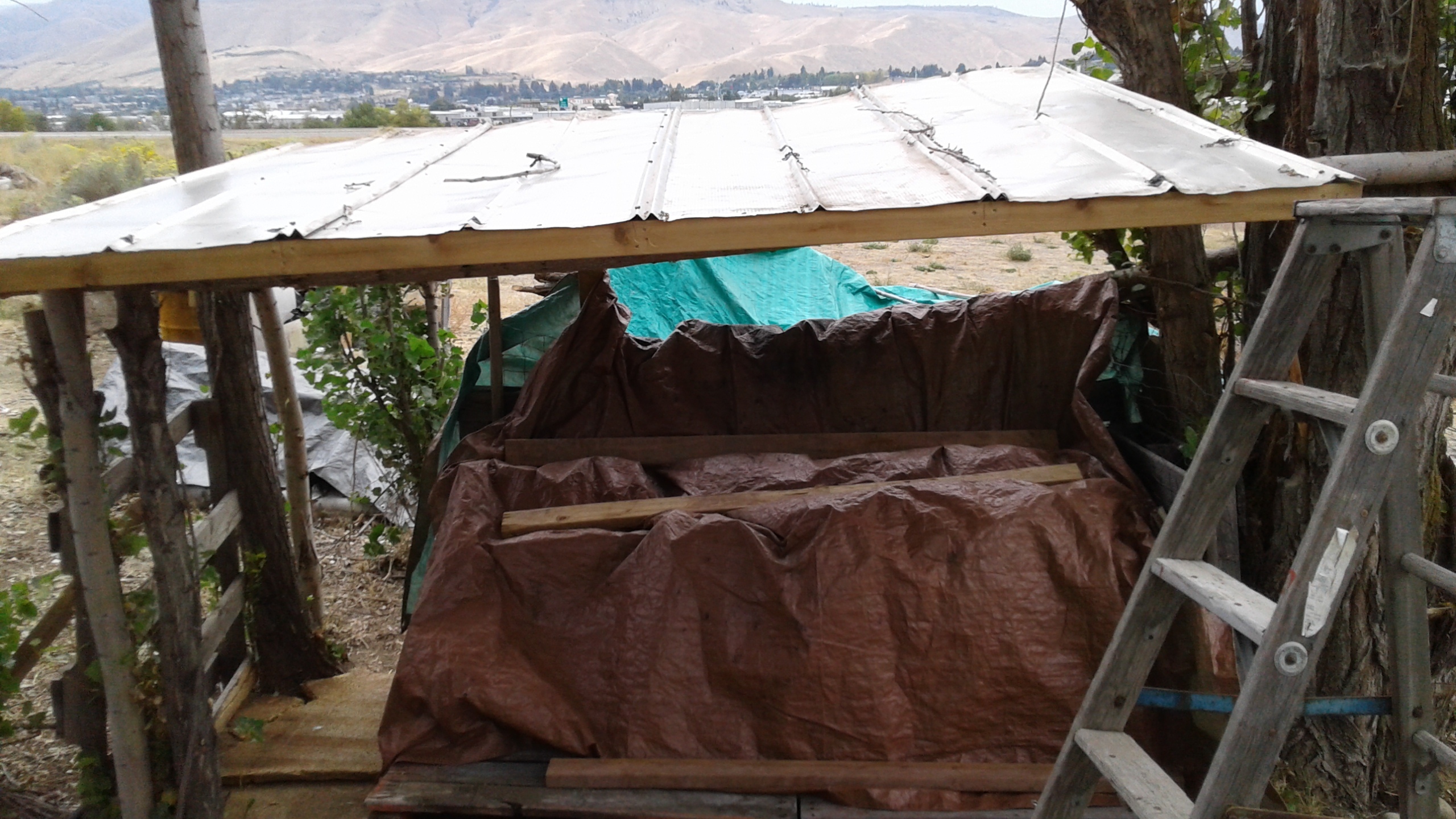

I have been working on shed to put the bagged wood in. It is also going to have a wood crib attached to it to dry the wood if it isn’t dry enough. Then I will just open the shoot and the wood will fill my bags and stack them in the shed. Probably will build it next spring. I angled the roof to pick up some solar heat, should paint it black or dark green.

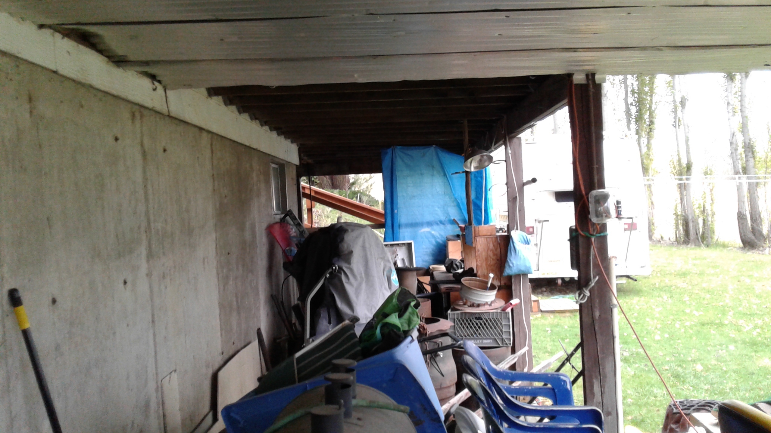

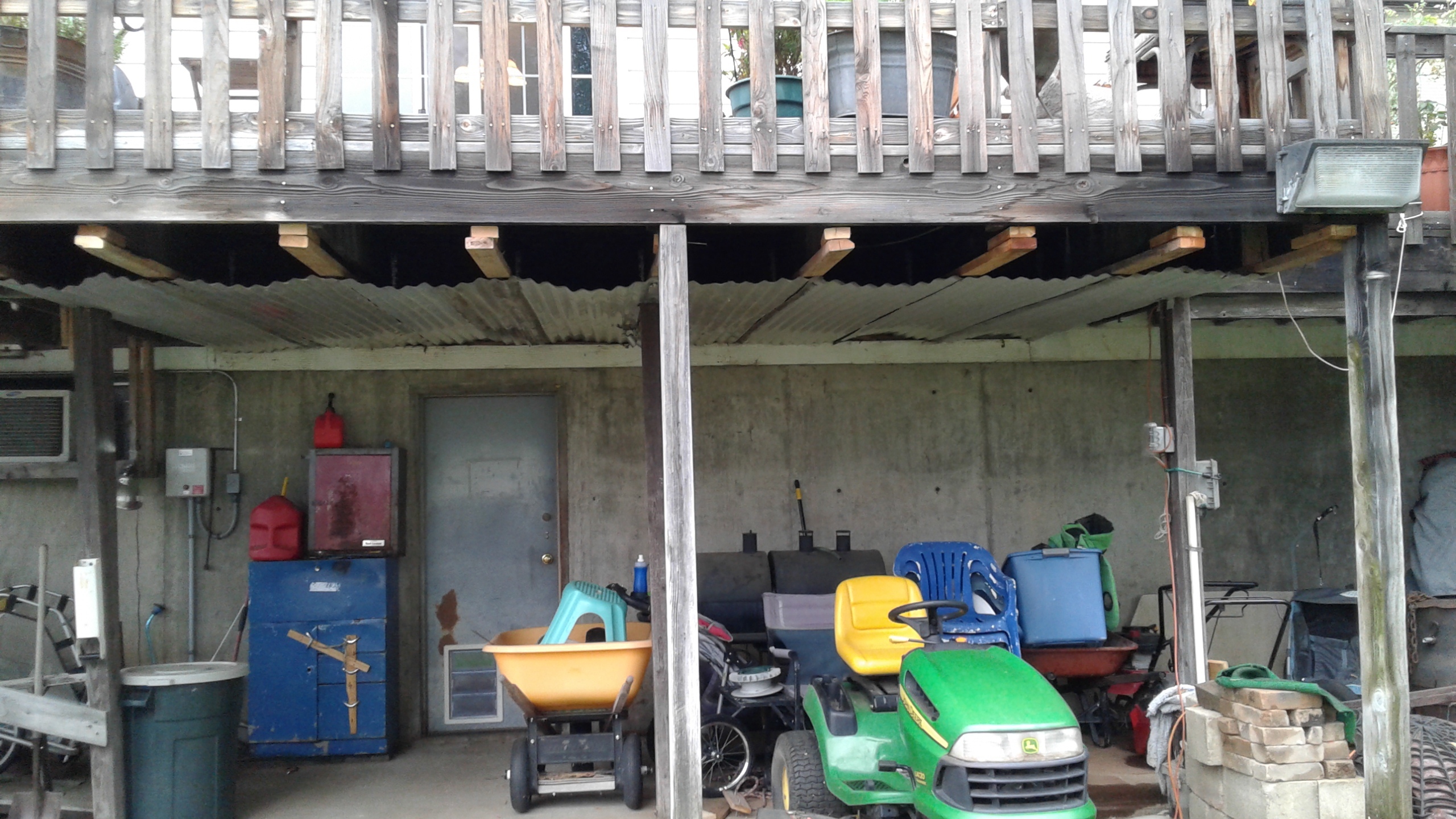

I am also putting up some roofing to keep to rain and snow out from under my porch, and will have a wood cut area under there, so when the weather turns to it wet/snowy mode I will have a dry place to cut up wood and store it. I will put my table saw under there, to cut up my demeional lumber. There’s a lot more to gasification then one realises, but it is all fun and worth the hard work. Speaking of rain it just started to rain here. Yha! I have my wood covered up.
Been wanting to do this dry place area under the porch for some time now. Wood Gasifiing is good incentive to get it gone.

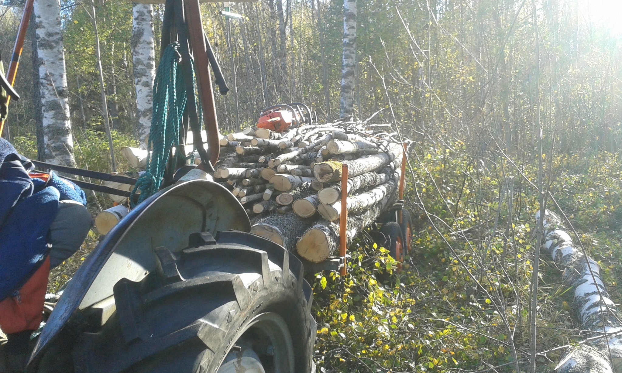

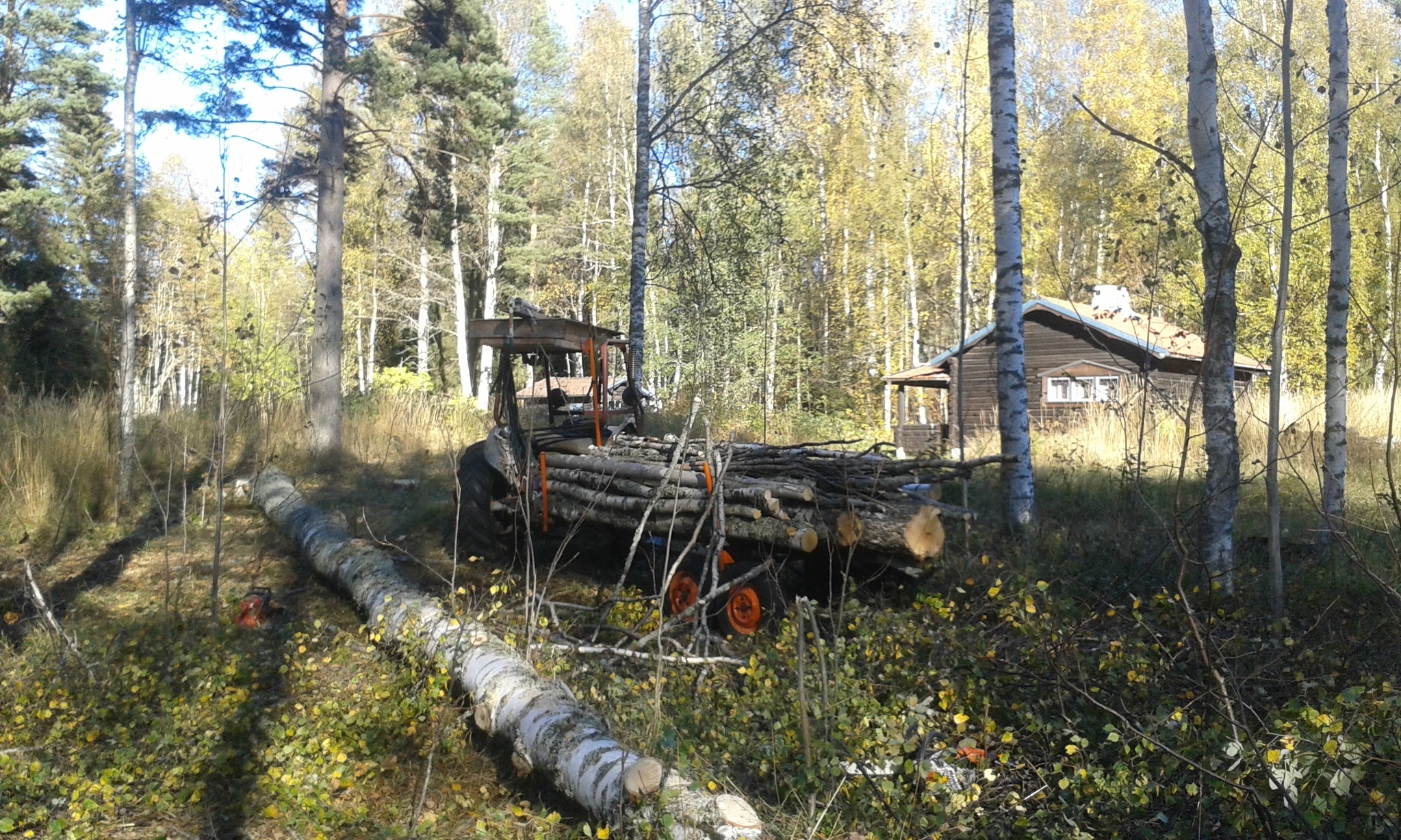

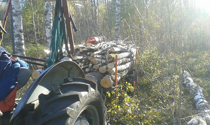

It was nice and crisp this morning. -5C (23 F). I fired up old Fergie and went knocking down a couple of birches.
There are 3 cabins on our property down by the river. The people using them in the summer asked me a few years back if could take down a few trees that blocked there sunset. I’ve been collecting firewood in that area for several years now. It just keeps growing back up.
Also nice golden birch limbs for the rebak.

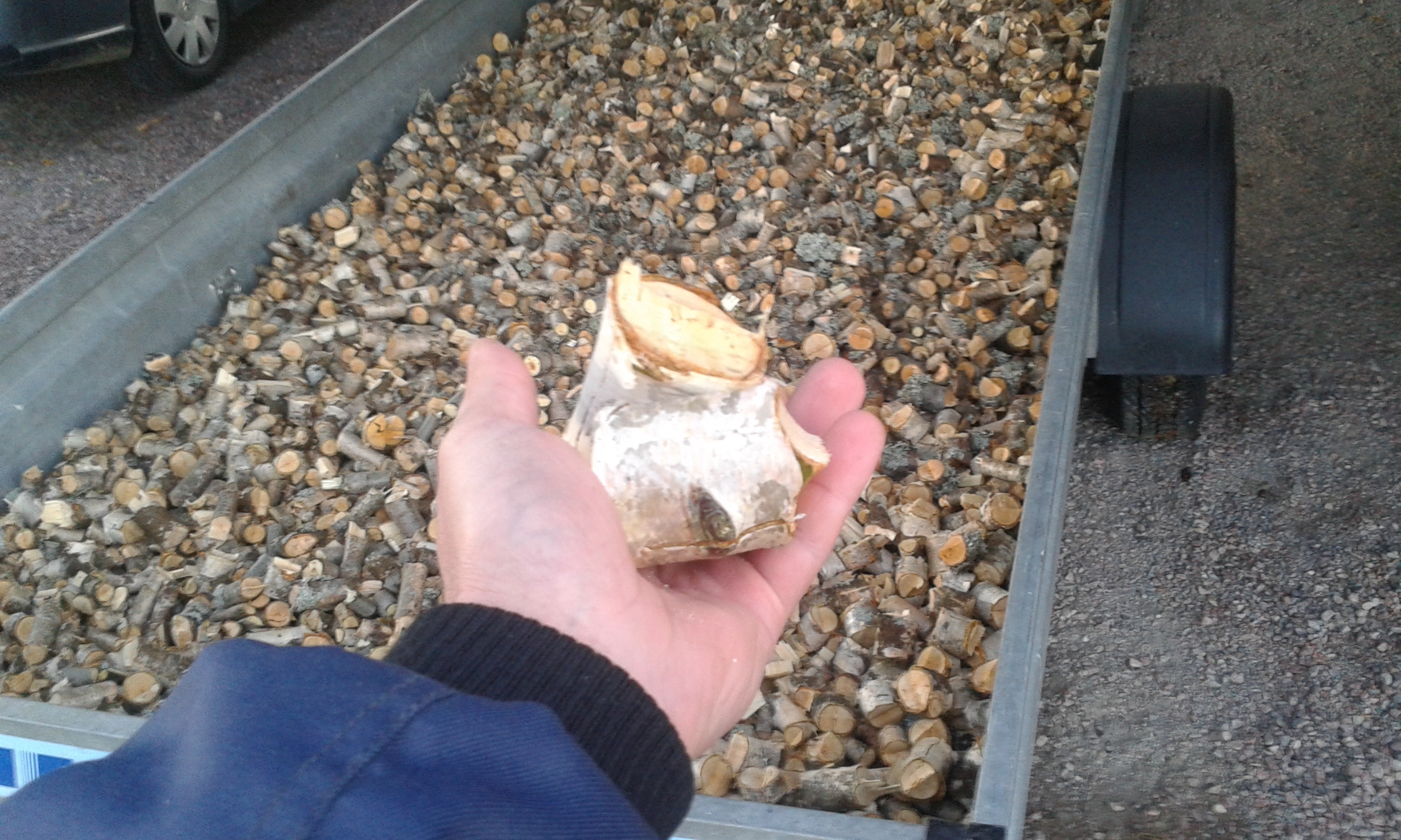

Chunked the limbs when I got home. These denst birch chunks will be for special occasions. I know the little Rabbit will love them.

How long do you tipicaly dry your eggwood?
Have you ever measured bulk density of your chunked wood? I zave never tryed birsh but my beechwood is about 330g/kg chunked. Oak about the same, l am curious about birch
