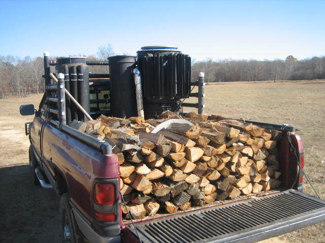

I have plenty of motor fuel wood bagged and stored , also plenty of home heating wood on hand.
I loaded up a few loads of the extra wood , hauled it in to town and traded for $$ :grinning:
