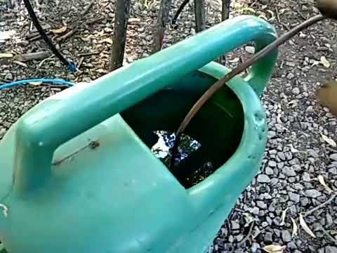

Today I did an experiment to gasify wood in a closed pipe, first I filled the pipe to the top and started heating it, the pressure rose very quickly and I had to stop, then I filled the pipe only 10% and the pressure rose to 20 bar, I cooled the pipe and dropped the gas into a plastic bag, it burned with a bluish flame. Probably some gas conversion process took place. Then I heated the full tube, this time I passed the gas through the water, it burned with a yellow flame, pyrolysis gas. This method of gasification would make it possible to compress the gas in the cylinder to a rather high pressure, but the vessel should be made of good steel. Charcoal does not fully gasify even with a glowing tube.
Why didn’t the gas just come out the top of the water container?
