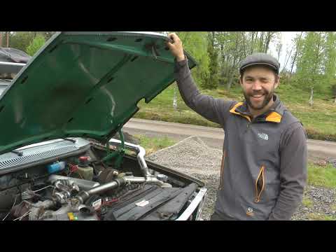

I was a little confused under the hood in the engine compartment.
This video is prove under the hood there are more than one Mike LaRosa in this world. And duck tape is univeral in it uses and international in the world of gasification.
I have no clue what language is being spoken, but I could swear that was a Honda gx series carburetor ductaped in place in the engine bay, which I am assuming is being fed the propane??
After watching the video again it appears the round grate goes to the inter wall with a little clearance all the way around so the smaller charcoal must go through the grate then up around and out up into the cyclone. When he put the plate out the charcoal was much bigger falling of the top of the grate. I wonder if he has a manual shaking devise in the cab of the truck? (I edited the above post).
Owner of the channel is Swedish, so most likely they’re speaking swedish. I think he knows a little English or uses a translator.
Okay. And the LP gas hose just in front of the carberator intake the hose held with duct tape, no air filter, thats not good. I think that truck is a 6 clinder.

The ductaped propane is experimental, just a test, but obviously worked good. The 12 hp Honda snowblower carb, same thing. An option if you’re converting a carbed vehicle.
