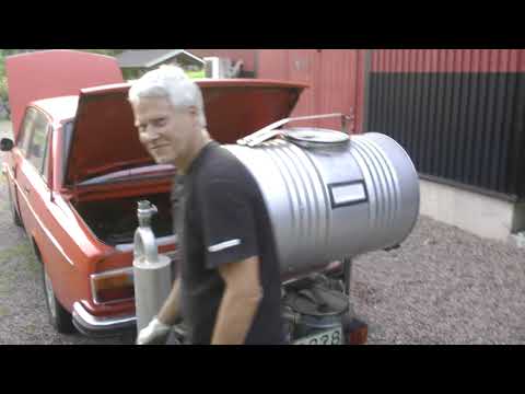

Some old start-up blowers, the one far left has been converted to a forge blower, with ball bearings and a pulley.
The pulley pulled off, and a hole drilled in the shaft, to fit the axle on a Citroën heater fan motor.
Impeller. The plastic motor mounted on some threaded rod.
It worked! :astonished: :smiley:
Edit: and No risk of woodgas entering the electric motor :rofl:

A treat for Swedes https://youtu.be/WZxWt7ZgXKc
Wow- just two minutes from light up to start up!

Hi Stuie, a little warning about the first video, the old guy (Lennart) did this mostly for show, running charcoal gasifiers on wood chips and pine cones is not a good idea, runs well, but filters clogged only in some kilometers.
Also a big risk of tar all the way in the engine. :smiley:
