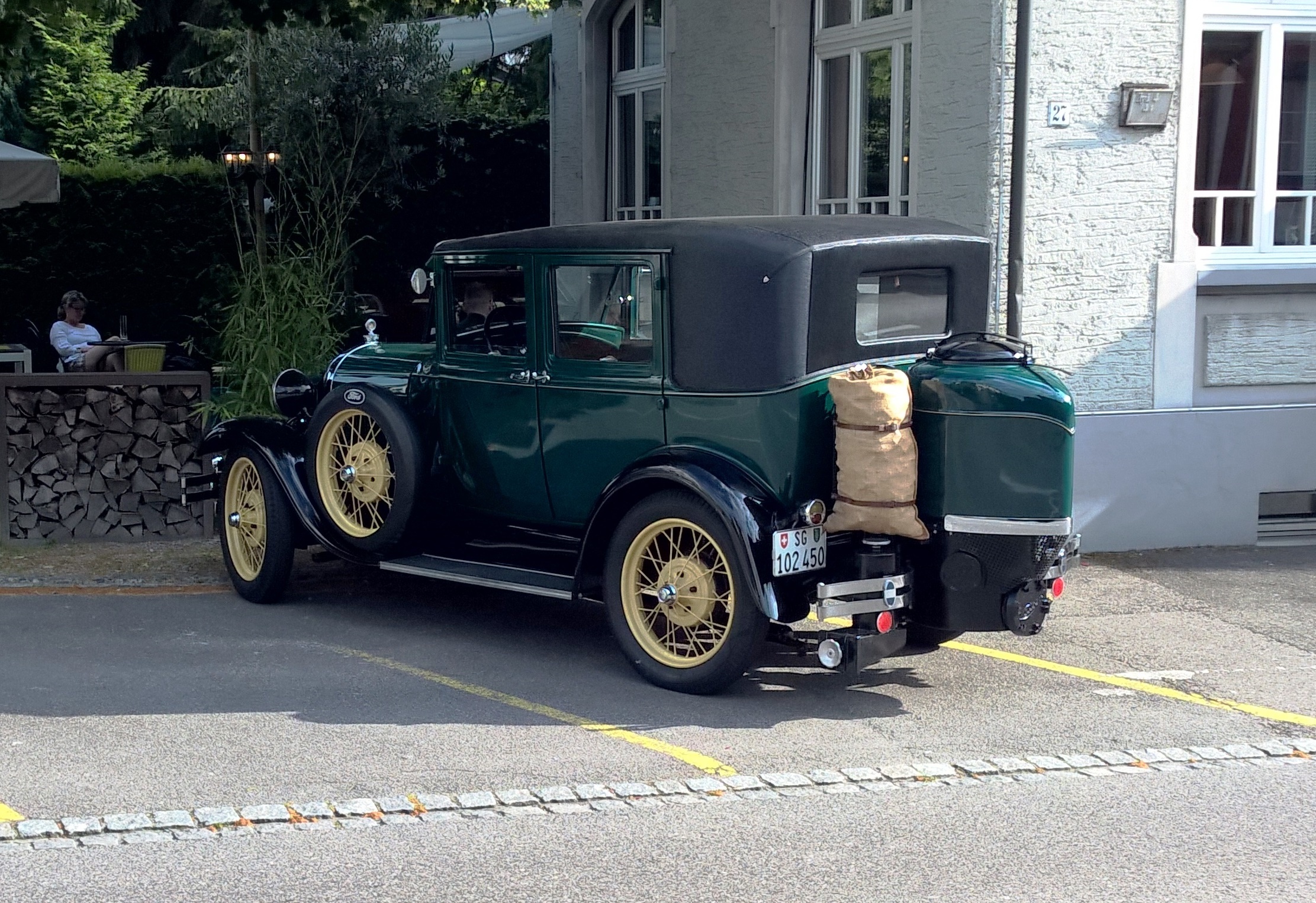

Daniel Hagen is running his 1928 Ford Model A Fordor on 40 kg of hardwood chips and 45 kg ash blocks. Compression has been increased from 4.22 to 7.1 on the slow-turning 3.3 liter Motor. The downdraft carb is set up so the engine can run on either gasoline or woodgas. The car was originally a 6 volt positive ground, but an additional 6 volt battery was added (with switch) so 12 volts can be used for starting the engine. Lots of photos and write-up here: http://www.holzgas.ch/ford-model-a.shtml

he did a real nice job an that one would think it came that way from the factory. thanks for posting ray.

Incredible workmanship! you just don’t see such pride much anymore. Thanks for sharing Ray
I’d like to know where he gets those threaded metal clean out caps those are sharp.
Looks like maybe European fire hydrants, or something from an industrial factory that deals with slurry.

On the holzgas.ch link above under the “Wer bin ich” tab there are three different woodgassed tractor systems shown.

Hi there, sorry I was offline for a while. Thanks for all the comments on my Ford! The car is very powerful and I really like it to climb hills with it.

Hi Tom, thank you very much for your words! Well, it was always my intention to have a vehicle built that is not just running but also good looking. However, a small vehicle with a small engine (that turns usually fast) is not a good solution as the power loss is just huge. The Kadett had 60 HP on gasoline. But this power was measured at 4500 RPM. Now wood gas burns very slow, so it makes no sense to turn the engine faster than some 3000 RPM. The max power on wood is therefore some 30 per cent less than the power at 3000 RPM, running on gasoline. Meaning that this car has only some 20 to 25 HP running on wood gas. Despite its relatively excellent power to weight ratio, it is a challenge to flow with today’s traffic. So in my opinion, an engine size of at least 2.5 liters is necessary. As far as I know, the Tracker has just 1.6 liters. A good idea would be to convert a diesel to spark plugs as these are slow running engines. Daniel
I bet that gasifier has esbestice around the burntube housing too keep it that cool next too the car body.he must be pumping or air daming air through the cooling tank tubes.excellent sounding idle.
Nice strong idle! I love the sound of that wood burner. Thank you for posting.
