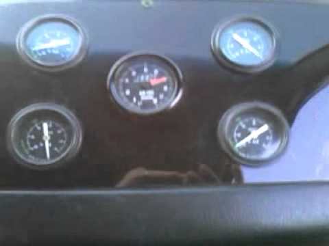

I broke some new ground today with my everyday wood powered truck. My f150 is my daily driver now that the GMC is missing in action. I now have over 5,500 miles on the truck straight woodgas and still running strong.I have the tachometer pinned at 5,500 for a length of time on the video below. And It has been over 1000miles since I had to dump my char. Has anyone else been able to reproduce these results?? Normally 300miles is the max on my unit BBB SEAN

Sean, What killed the GMC ?? I already know I will have to replace the air cleaner housing on my truck. Once that paint comes off in there it’s all over. Be careful on those RPM’s. I know the tachometers set the red line around 5000 RPM but years ago it was around 3000 RPM and I really don’t believe the engines have actually changed that much. After breaking a connecting rod on my 95 olds I will keep the revs down on all my engines. That was a fine ride on 5 of 6 cylinders as oil was getting sucked through the hole in the piston into the other cylinders … We made the last 60 miles home … Oh, supposed to be in the 60’s today … Enjoy your warmth … Can’t look at your video, wish I could … Off to Milwaukee for the grandson’s first birthday party … 280 miles of gasoline … ouch …Mike LaRosa
Hey Great video SeanF.
Thanks for keeping them short. The Rural living guys actually going to be the majority having the on site fuel to do wood driving are in most cases “out in the sticks” on copper dial up. Given a choice between a hundreds dollar a month satellite set-up and more chicken/goat/cattle food, fencing, etc; the one is income capable and you can eat the results, versus the other as just an after taxed expense removing money from your pocket into someone elses pocket with the governments always in between taking their cuts.
MikeL you will like this one. Low res so was only a 45 minute download for me at 42kps.
Try it. You’ll like it.

Thanks for the reply!! I had my buddy do the filming on this trip it was his first time in a wood powered truck. Good job on the new dakota I am sure it will be running down the road shortly. Let us know how it turns out. SWEM BBB SEAN
