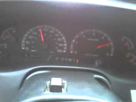

Is the speedometer on the first or second lap around?
Peter

That was the first lap a true 80mph
I will keep working on it going to need a bigger engine!!!

Video below is a test I did last year to see if the gasifier would be able to take the stress of high rpm driving for a duration of time.
My total mileage of driving for the year is 20,000mies 15,000 of that was pure wood power.
HWWT
Hey there Sean, as in, you have my hat. It looks like you have a nitrous oxide effect going on by revving out that high and making five years of yahoo woodgas commentary of slower than normal rpms prove to be B.S. But how about 15 minutes of crawling around parking lots? Will it be like a Ford Cobra pulling a plow? I want to HWWT

While running this test I did notice the truck had more pick me up than usual. Seems that the more heat put into the system (by high revving) the faster the truck wanted to get up and go. Keep in mind this is still a v6 pulling trailers can be a bit of a challenge 95% of the time I pull it off without using gasoline. The truck seems to do okay in light to light traffic as well as slow speed driving. A v8 under the hood would certainly do a little better . Best Regards Sean
