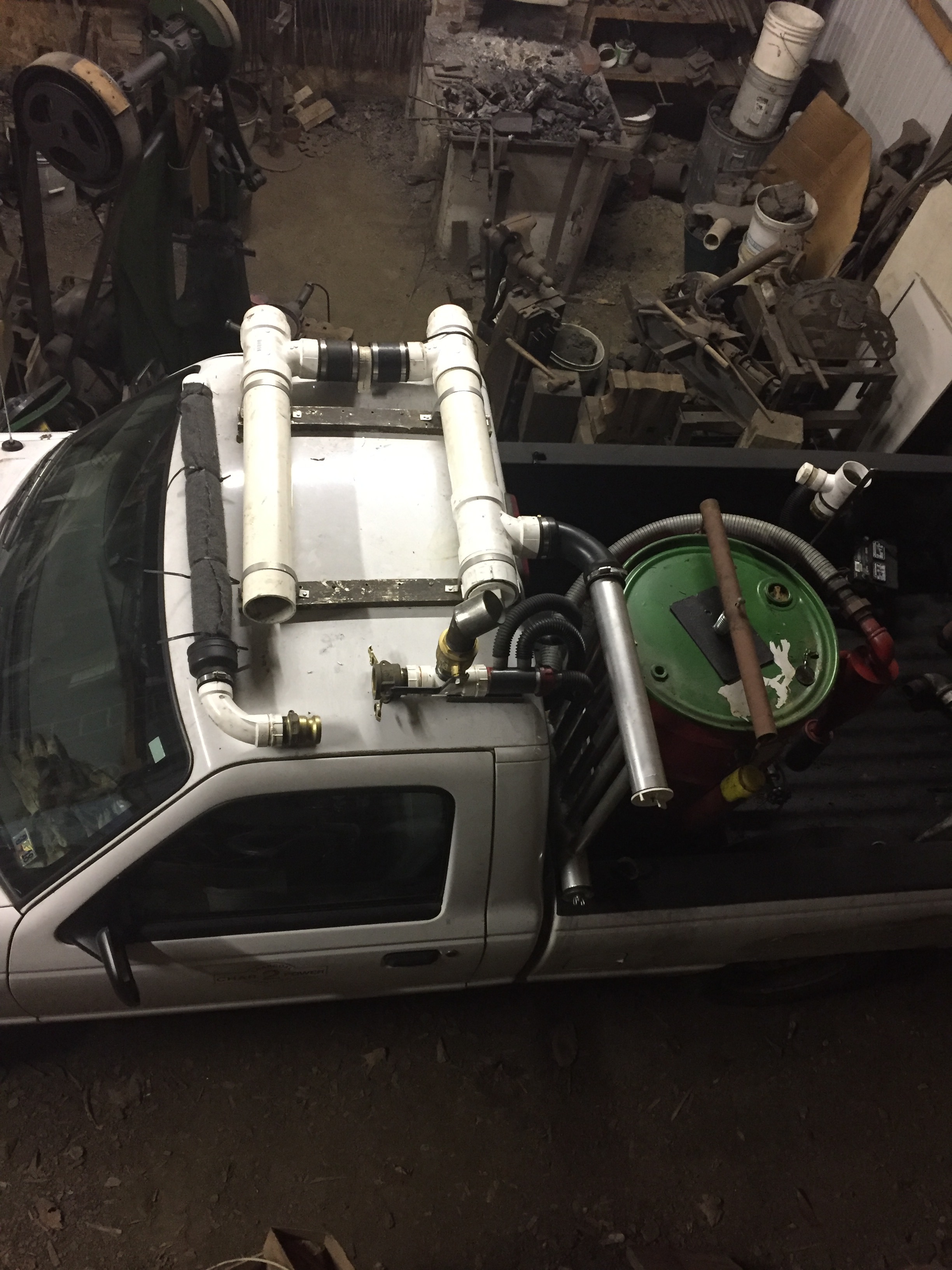

Well I will be a NO SHOW. I pulled a muscle in my neck and am too stiff to drive safely. It is getting better, but not that good for making the trip to Argos. My regards to you all. I even upgraded the filtration on my Ford Ranger in anticipation of going to Argos. Here is a picture of it that was inspired by Kristijan’s filter design.
Material for baghouse filter socks - #6 by KristijanL
The chargas goes from the 55 gallon drum through the cooler to condense out water, then through the 4" PVC on the cab roof. It enters the one leg where stainless steel scrub pads are placed. At the passenger side the gas makes a right angle to where the suctio fan is located. It then goes into the forward most PVC where there is a 2" PVC pipe, perferated by many 1/2" holes and wrapped in a wool blanket. This is the piece you see laying just above the windshield. The gas then goes past the flare and to the engine. I have not tried it out yet other than idling. Argos was to be the first real test but that has now fallen through. Hopefully I can get back to using this truck and post more on the Ford Ranger thread in the near future.
