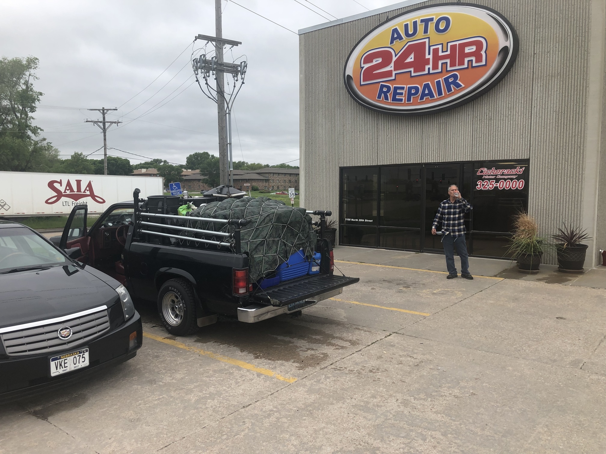

Still having intermittent issues so stopped in Lincoln NE at a 24 hr repair shop at 11:30 and had a new O2 sensor installed
Found that the old plug had no clips holding it together

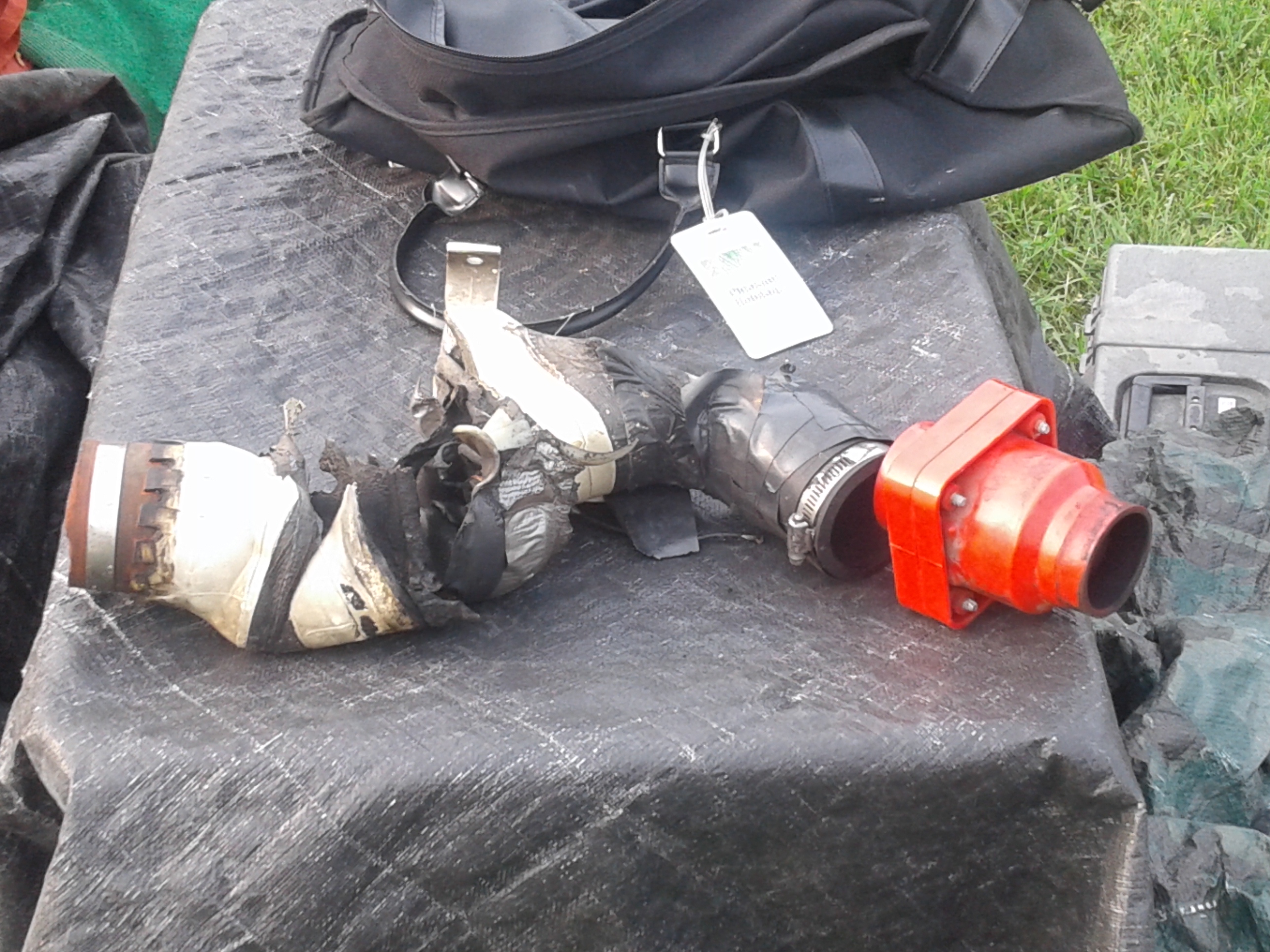

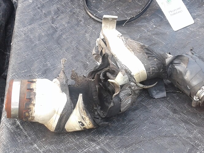

The truck started running great, and good gas mileage. On the forth day we bought a plastic bushing for the wiper linkage arm for the passenger side wiper, and fixed it at Argos. The second day is when the muffler wore out and started leaking big time this caused exhaust to go backwards into my pushers blowers because the check valve did not completely seal the exhaust gas off. 400 *f exhaust will meltdown plastics.
What you are looking at is two 2" blowers and the red check valve. The valve inside is melted down.
When this was melting down and on fire? It was raining hard. The valve was close the the fuel tank. Yes God save us from disaster again. I have lost count on how many times God has Save my life here on plant earth. And one time through his Son Yeshua (Jesus) the Christ, for ever and ever. Yeshua is Lord.
It is Redesign time on this air intake check valve pusher blower system. I have look at this set up and never really given it a thought about it, it look like a good set up to me.
Weeks before this melt down event, my temp increased on the grate a few degrees making it higher then the hopper temperature when shut down running on gasoline. It must have been a real small leak in the muffler. Even Wayne mention how to test for it. I checked and could not tell it was leaking. The day we left and hit the road at highway speeds it started to leak more with every mile down the road. There was a reason it rain every day hard. God is so good.

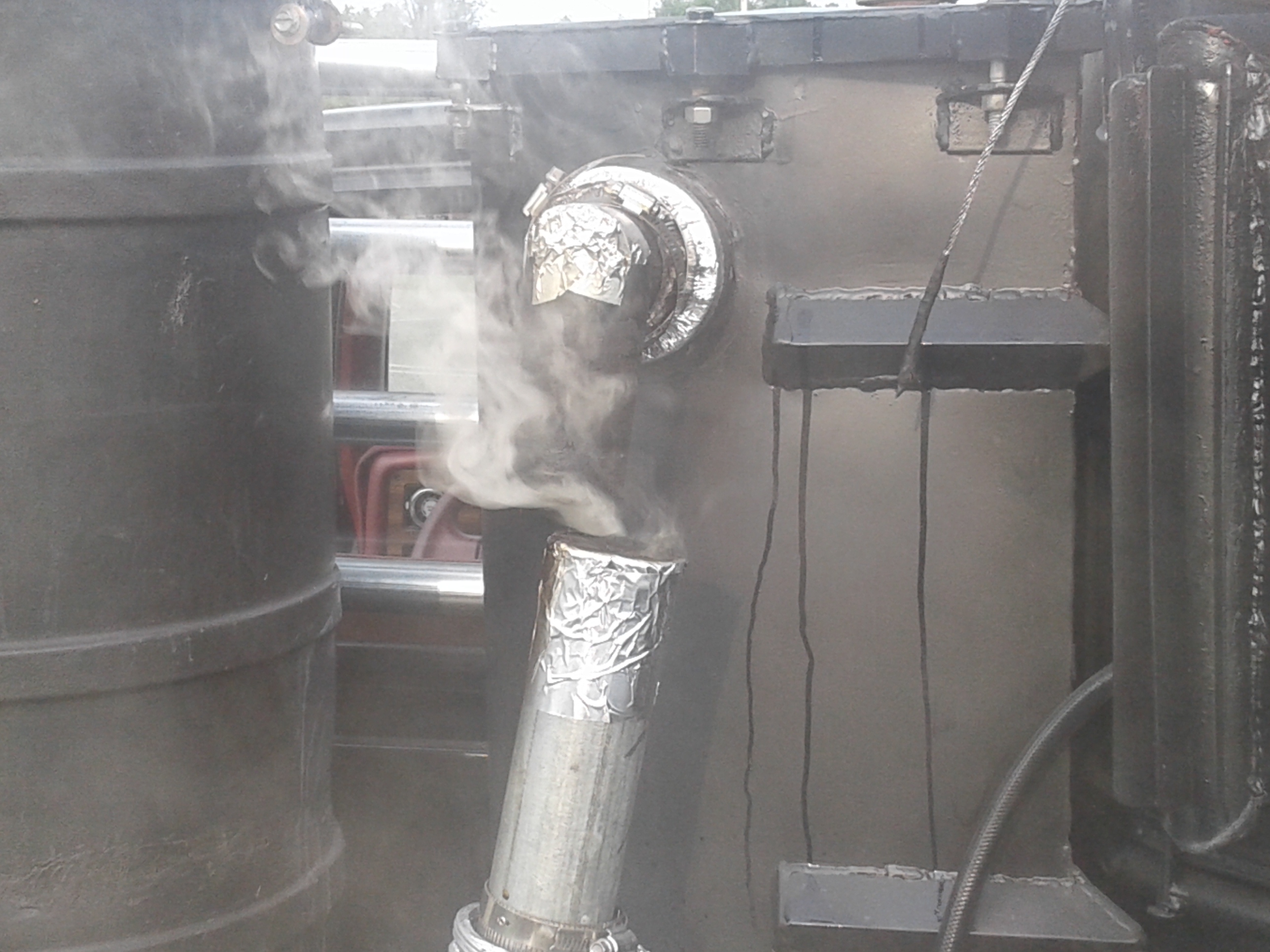

The only way that can happen is burning gasoline for long distances. During regular woodgas driving the incoming air cools the blowers (and the muffler!) and keeps any exhaust leaks moving the other direction.
It would be wise to have the pusher blowers disconnected for extended gasoline driving.
Yes Chris, the other thing that happen is after the melt down the wet air under the truck started to be scooped up into the metal cross tube and into the preheated box, now you have steam being formed and flowing up into the intake of the gasifier because the woodgas valve are not air tight when closed. The vaccum on the engine caused wet hot air to flow all the way though my gasifier system. My charbed was wet when I got to Argos. Lol. I was glad I brought extra charcoal. It ran good once I got it started with out a muffler preheater.
I disconnected it from the intake muffler pipe and taped it up with aluminum tape.
How important is preheating the air. Very important for getting up to temperature by using the engine exhaust heat. I normally can take off with good idle speed at 400 degrees at the grate. With out preheated air from the muffler it was at about 700 to 800 degrees before I had good idle speed.
The new design will have a valve that can be close manually when driving across country. As long as you do not have a muffler leak this will never happen. But things happen. I keep reminding my self of the words you said Chris, this truck was built in 2012. That is now 7 years ago. It was on wood at 94,250 miles. It now has 125,010 miles on the truck.
