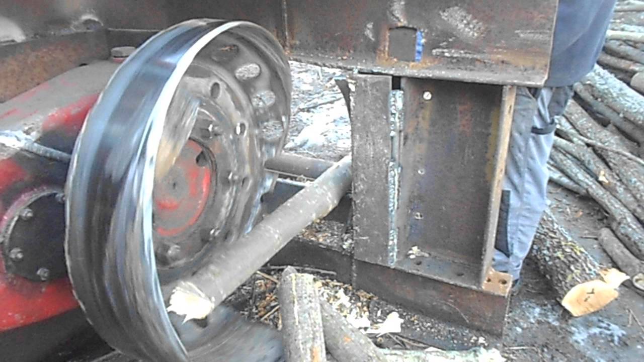

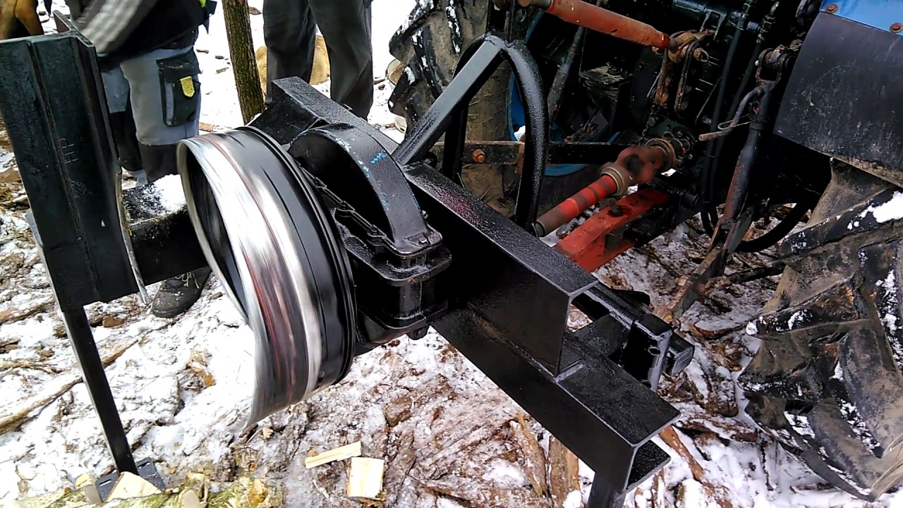

This one did not look so crazy, if you do not have small sticks.

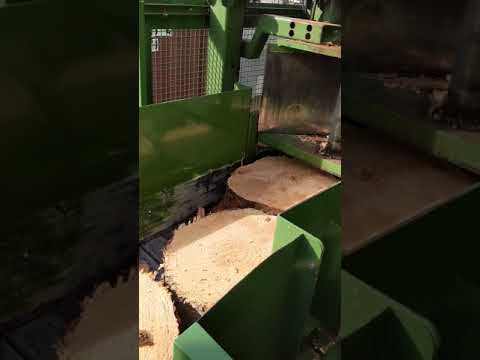

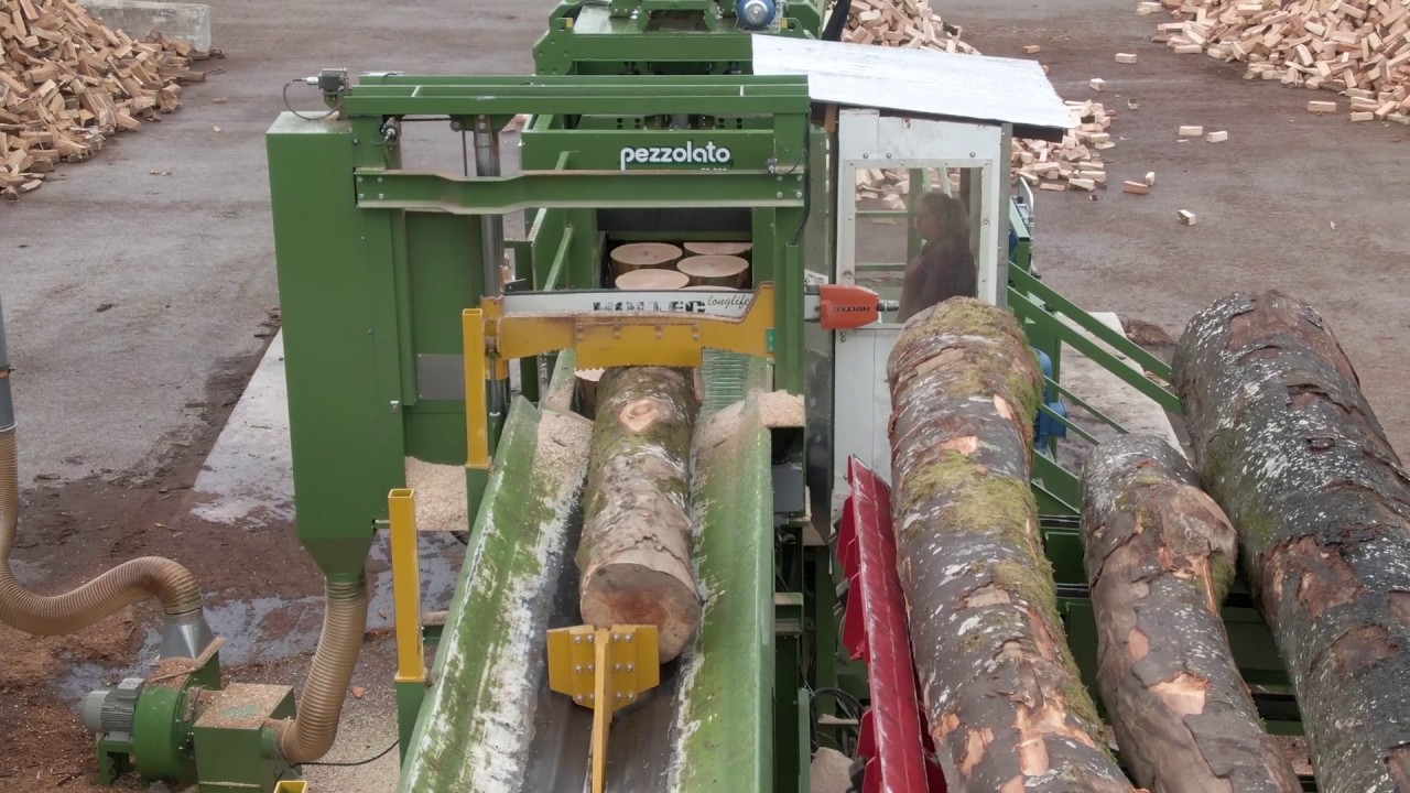

Wondering which one is the fastest, to saw sticks on the band saw and then use the rear axle clip or to make slices of the trees and make a machine like this.
Jan, I think sharpen the hatchet is the fastest ![]()
Hmm, it takes me about 2 hours to make firewood for 100 miles with a table saw and ax.

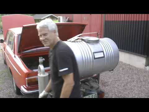

Tone, do you think it would be possible to run on these chips in a gasifier, without it hanging?
Jan, I think it would work, I use crushed branches, different thicknesses and sizes, it only needs a little shaking every half hour to fill the middle
OK, one of the guys here in Sweden runs on wood chips, but he has a fairly advanced facility for it to work.
Yes. Jonas Hedenbergs fuel chip systems have evolved relatively sophisticated.
See at 7:55 minutes his used wood fuel chips:
He is a very smart, direct use man.
Assume he does not add anything to his systems without a need. Without a proven benefit.
He has evolved into 3-4 electrical motors to operate his wood chips using systems. Operator command controlled. Or simple, electromechanically timer controllers.
Puts, False! to the idea that ONLY electronical controllers can make systems workable.
He auger feeds in the chips at a controlled rate to his hearth core.
He timer automated lifter rod plunges his upper hearth area. Observe his found needed timing and duration on this.
I do not know if he evolved from whole system shaking; then into plunger-rodding down.
I do know that whole system shaking can break loose upper hearth tar jams, yes.
BUT then the whole system shaking can settle too tightly the char beds at the same time! Whole system shaking absolutely crumbles to dust, fragile chars like my Doulas Fir wood makes! Then you have a real “soots” maker system, (actually, is clogging char dust).
Ha! The choices seems to be make the system workable with Big-Power-Input-Systems made wood chips . . . or densified pelletized fuels . . .
Or make the controllable burn-rate gasification wood chunks for a simpler 1-2 electric motor gasification system.
I was going to call Jonas and ask, but I can ask you Steve instead, can I connect to the front lambda probe without destroying the signal to the car’s computer?
No. Weld in a separate threaded bung to have your own separate oxygen-in-exhaust sensor.

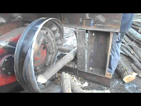

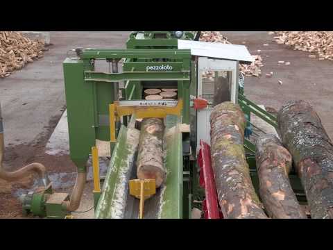

Here is a posted up 2013 drum type able to make wood stove lengths:
Slow. So faster:
Then a very fast REBAK:
I wish someone made a “U Weld It/U Build It” Rebak kit. Would make my life easy sourcing some blades and gears to make one.
I bought my rebak from Poland. They also sell the knive-gear set. Motor and safety plating is up to you.
Which company was it? Do you think they would ship overseas?
I think it was this one.
https://wood-processor.com/products/cutting-mechanisms/
I bought mine from a dealer in Holland. Easier but more expensive and I bought the model he had in stock. I remember JO advised to use the one with extra knives. It cuts shorter, mine doesnt deliver motorfuel. Pieces are to long. But no problem for making charcoal.
Yeah we have a dealer here in the US, but the cheapest one costs almost 3000 USD. I think if remet offers me a better price on just the mechanism I’ll order it and buy a flywheel from Red Dragon(the US dealer)
I hope my clip works after fixing it, but since I do not have so many small trees to cut (try to only cut the big trees and have the small ones on growth) I think about which other solution is best.

JO, I have tried splitting, but it will be so many different sizes so it did not work so well.

Tom, that was the biggest reason to make a band saw, it will not be so much shavings, if it now works.
