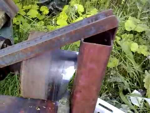

Here is a ‘semi’ rebak one. It uses one of the wheels and an anvil. It is belt driven, and roller feeders. He was super safety conscious when he built it probably because of his kids. And while it doesn’t work as fast as a rebak, it isn’t terribly bad.

I see Laimet changed the video and the machine. I made a version of a helical screw chipper a decade ago after watching their video on line.
I started trying to set up my universal mill to machine a helix but I lacked too many components. So instead I spend weeks machining a screw with a 1" pitch from solid bar. I wanted a coarser pitch screw but that was the coarsest pitch any of my lathes would turn. I built the machine and then hooked it up to my 30hp tractor 540rpm PTO. Results were very disappointing. The tractor would stall feeding 1"x1" hardwood edges from boards into it. I fitted a diesel truck manual transmission to the machine. 1st gear provided a 4:1 reduction. Results were still very disappointing. The tractor engine would stall if feeding a 1x1 1/2" board.
I needed more power. A lot more power. Here I am - being forced to scrap diesel trucks I could use to power the darn thing
Cutting wood is a demanding task, especially cutting hard wood, the cutting knife must be made of high-quality steel to keep it sharp, and the wood must have space so that it does not get jammed between the blades and the housing, but that it can split along the grain,… can you post a picture of your chopper, maybe a video.
